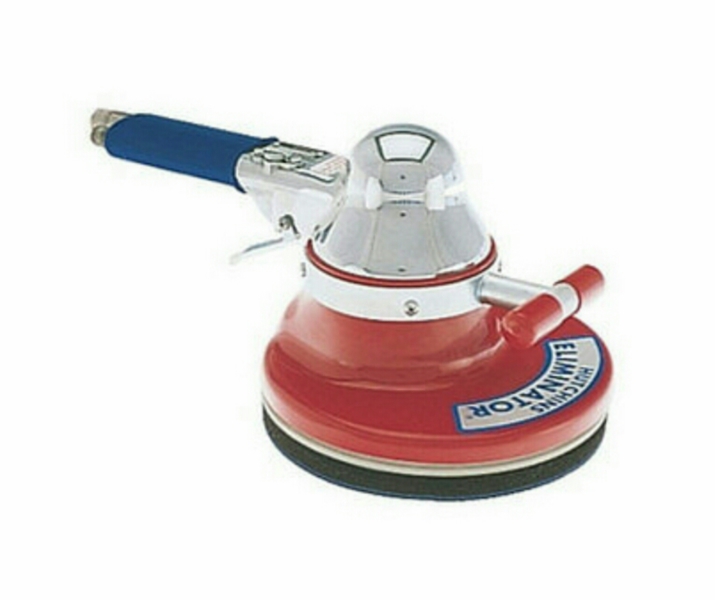

Thank you Bruce... Actually I haven't used a cheese grater since the 80's. The filler now is so much better and easier to sand that I don't have a need anymore for one. A Bondo Buster is similar to a DA sander, with a slightly different pattern and an 8"pad.
