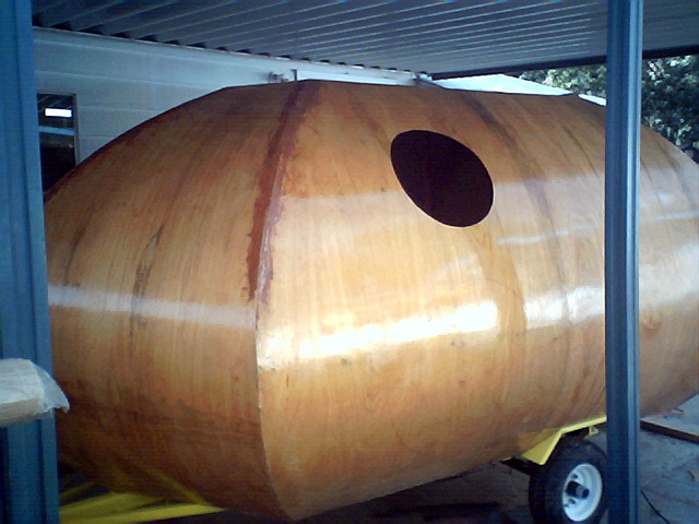

del wrote:Ok thats just a pilot hole, here is the fully cut out window.
The body is now bolted to the frame.
del
WOW!
That's a trailer! Like Scott and others, I've been waiting to see this shot!
Great looking camper! :thumbsup: :thumbsup: :applause: :applause:

Postby del » Sun Oct 07, 2007 6:02 pm
doug hodder wrote:Del....thought about the discussion about frame colors we had in the past....this one is going to be light green to match the wheels...why not? Only drawback...I don't have the green paint....lots of black however. You're doing yellow only gave me the impetus to do something different. Doug
The thought was I paint mine yellow and it doesn't stand out from the body, one attention stays on the body. With your trailer same theory only substitute green for yellow.

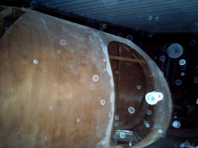

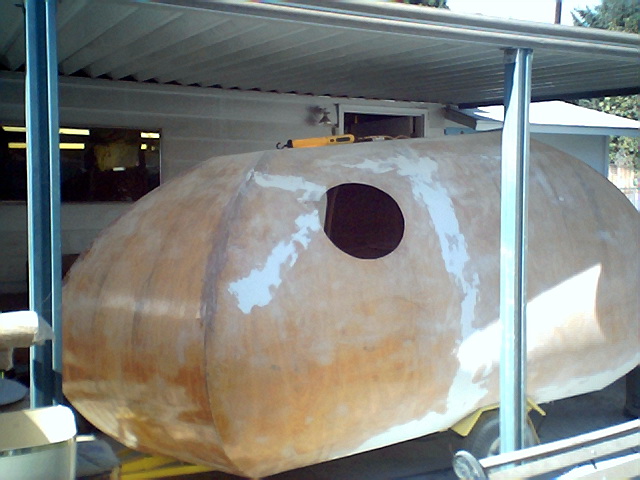

Postby del » Mon Oct 08, 2007 11:47 pm
Warning, all purists go run and hide. Started putting bondo on. Don't mind the dust on the lens.

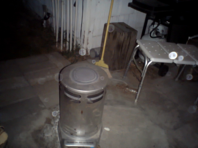

As the weather has turned cold And I remembered why I hate this heater. When it is cold the tank freezes up and the heater quits (silly me for using a heater in the cold).
Any ideas on how to keep the tank from freezing?

Just my guess but maybe if you get it off the floor. 8) I have never seen a kerosene heater freeze up.

Not kerosene, but propane. The tank freezes and stops the flow of gas. Let it sit for a while and it warms up so it can work again, for a short time.

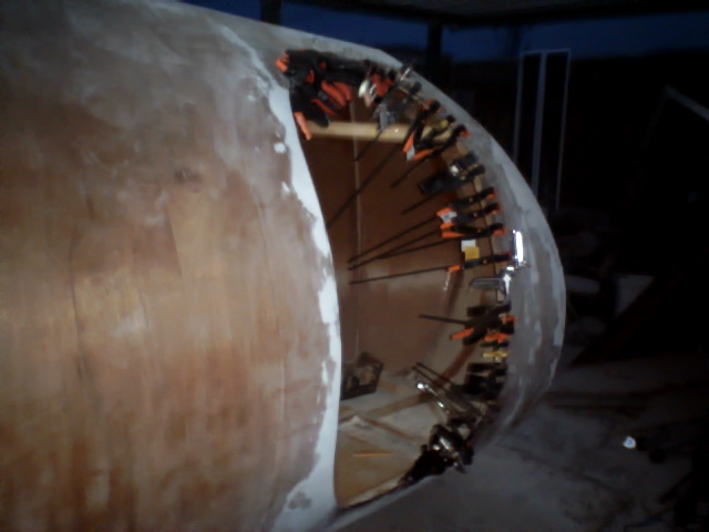

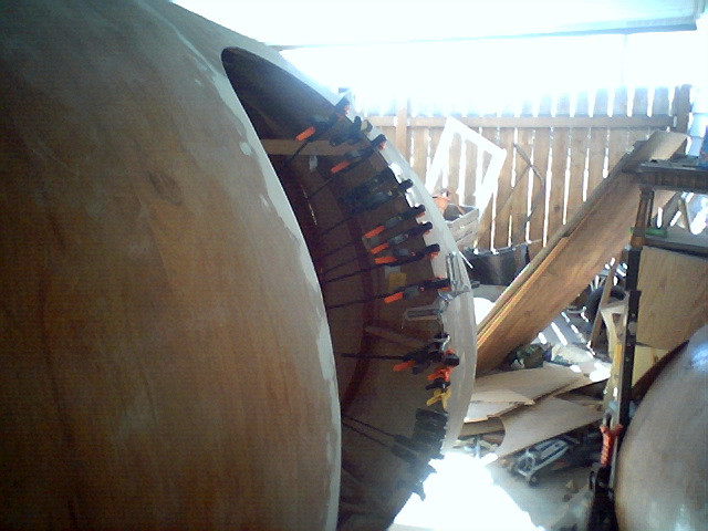

Postby del » Wed Oct 10, 2007 1:22 am
If you have not guessed I am still sanding.
I also started working on the entry door seal, got clamps.
Went to the store and got more clamps.
This is a spacer so I can put on a lip, to install the seal on. Tomorrow I should finish installing the spacer and start the lip, and more sanding.

Postby GPW » Wed Oct 10, 2007 6:54 am
You might want to add a lip on the lip to intentionally channel water safely down the side and not inside( like your cars trunk lid)...Water can get into the smallest places if it's blocked ... like gutters for doors...seal alone might leak somewhere..crumbs for thought...??? :thinking:
