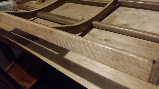

Postby dales133 » Sat Sep 05, 2015 3:15 am
So i drove to melborne this morning and got the mill finish extrusion to go around the profile on the wall to roof join and another extrusion to go around the galley profile to tidy up the edge and provide a better sealing surface for the seal.
I allso picked up the same roof mold in black powdercoat for this job im doing for someone else.
While i was there i picked up a sheet of .5mm stucco aluminium sheet to line the inside of my galley...ontop of the ribs...a bit of extravigance that i thought would set off the hatch ribs ive lovingly spent weeks making and sanding and assembling.
And as for the hatch frame i went from P80 to 120 to 240 today as well as pluging the kreg jig holes and sanding them back.
Super unhappy that ive been waiting 3 months for maple kregg dowels to come off ebay and ended up using pine ones i had instead.
Its ruined it completly but hes sent them twice and still nothing so reluctantly i moved on.
Gripe over...
I sealed all the timber frame with the same bondall stuff ive used throughout and its ready for a sand and a few coats of poly.
Shame melbornes so far wasted alot of time but on the brightside got alot done too

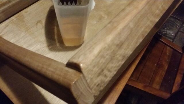

Postby dales133 » Sat Sep 05, 2015 6:24 am
Just finished knocking back the sealer and got the first coat of floor urathane on.
Coming up pretty nice.
Mrs isnt to impressed i did it on the kitchen table and stunk the house out with paint fumes but i need to recoat tomorrow as im a busy man

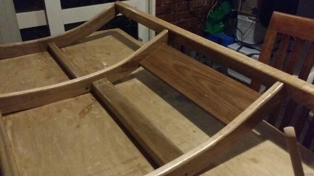

Postby dales133 » Mon Sep 07, 2015 5:47 am
Coat 5 of floor varnish with plenty of sanding....more than i liked.
I think this might be the last coat
dales133
Posts: 4605
Re: Ok here we go...PMF!
Postby noseoil » Mon Sep 07, 2015 7:23 am
Really looking nice now, great finish & textures showing up in the grain. Amazing how much time the hatch eats up, isn't it? Glad mine is being skinned instead of the natural finish like you have! Beautiful job!
137905
noseoil
Posts: 1822
Images: 670
Postby dales133 » Mon Sep 07, 2015 9:06 am
Thanks mate,yea i realy couldnt say how many hours its taken but quite alot!
Ive actualy enjoyed it far more than i ever thought i would though...like most people i was dreading the hatch.
One thing that mightnt be much fun is mounting the gas struts though with the 30mm ribs on the outside edge.
I think i may need to fix them under the rib or otherwise id need to block out the lower mounting point.
Just another hurdle in the teardrop manufacturing process ;)
