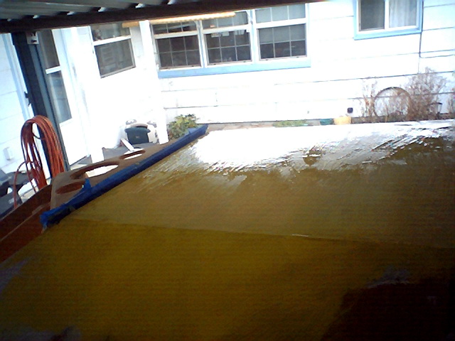

Still working on the door seal.
And the hatch seal.

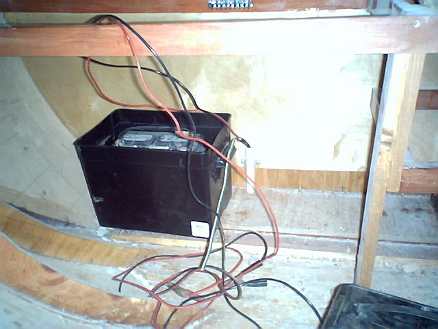

With the clamp shortage my other project is wiring and battery.
Had to drill a hole through the floor (I was scared) to bring the wires in. The 1/2" pvc was a tight fit and will fiberglass the top in. It is currently clamped on the top plus undercoated underneath. I stole a battery out of a lawn mower and put it in (before you call the police note it is my lawn mower) the battery box. Tomorrow when I run out of clamps, I will be wiring the battery. I am putting a relay and circuit breaker in the tow vehicle, should I put a circuit breaker in the trailer?

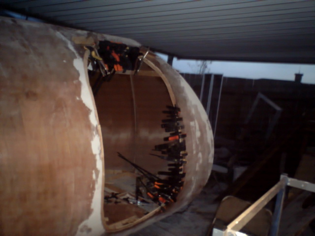

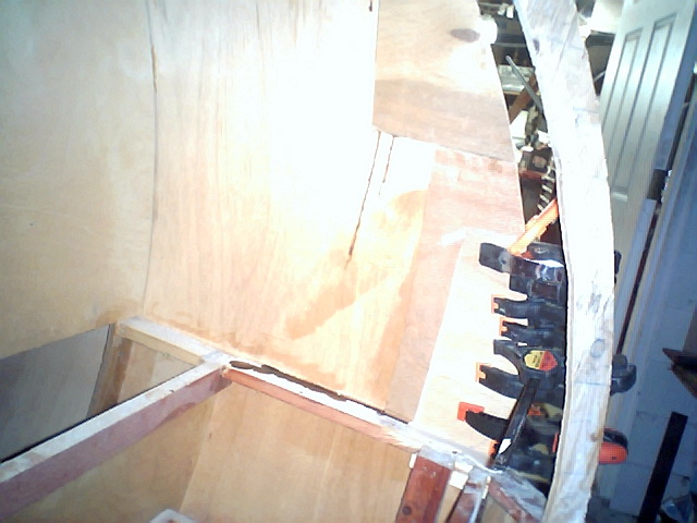

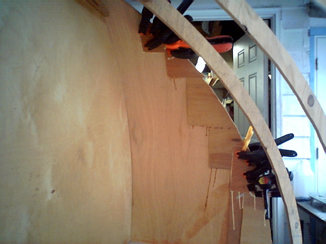

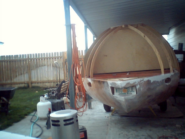

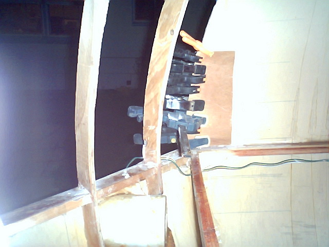

Postby del » Sun Oct 14, 2007 10:42 pm

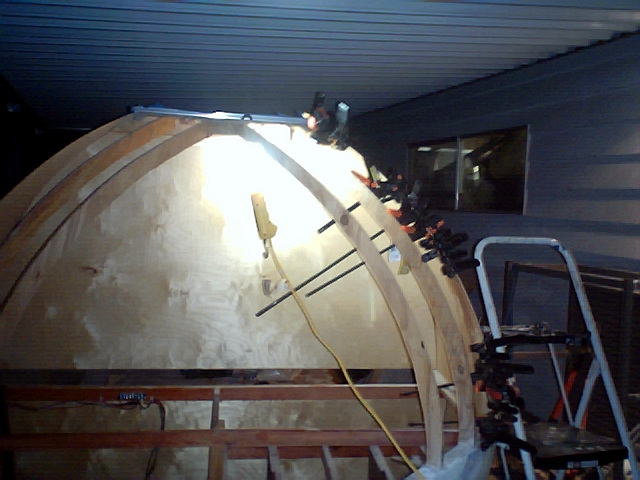

I am currently building what is in blue in Andrews drawing.

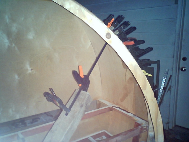

I use alot of clamps for this. Here is a close up of the ply gluing together. The inside piece is two thin (52mm?) ply, glued together, being careful so the seams do not line up together.
More work on the hatch.
And I leave you with a shot of the tail with a Florida tag.

Postby del » Tue Oct 16, 2007 12:16 am

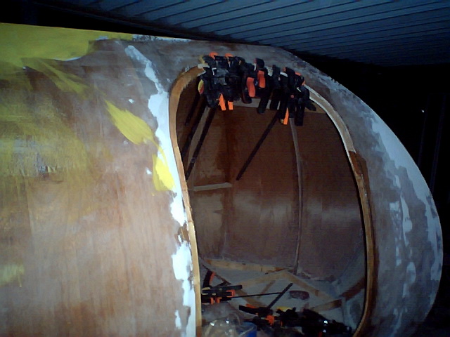

Still working on the door seal. A piece goes in between the clamps at the top and time for sanding and fiberglass.
Working on the hatch seal.
Got farther on the wires.

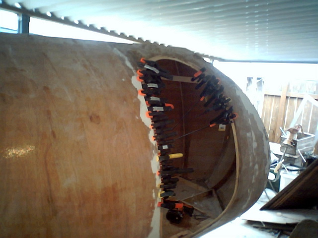

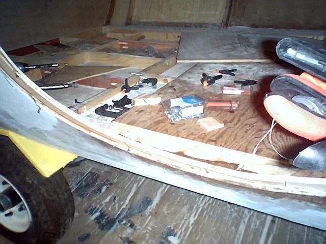

Postby del » Wed Oct 17, 2007 12:19 am

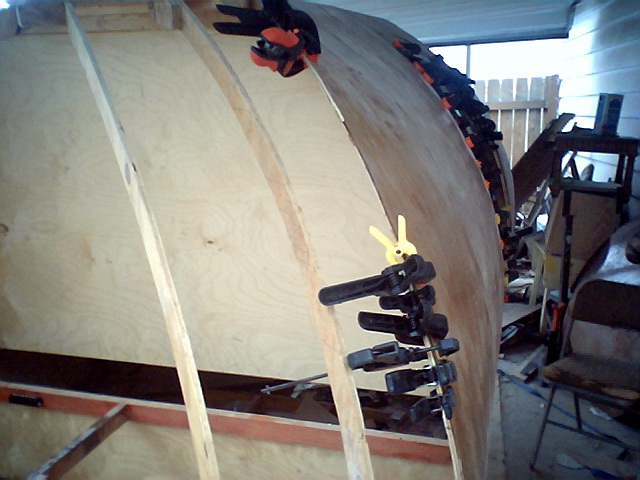

It rained most of the middle of the day so I had to change my efforts today. The trailer is undercover so I primed and then painted where the h. hinge goes.
After dinner the rain stopped so I was able to cut out the last pieces for the door lip.
Continued on building the lip for the hatch.
Started on the left side hatch lip.
I need more clamps.

Postby Mary K » Wed Oct 17, 2007 2:47 pm
Is that a Florida Tag? :thinking: :thinking:
Mary K
Mary K
6000 Club
6000 Club
Posts: 6425
Images: 44
Location: Florida, Pensacola
Postby del » Wed Oct 17, 2007 3:26 pm
Mary K wrote:Image
Yes Mary K, I have a collection of about 30 different states.
