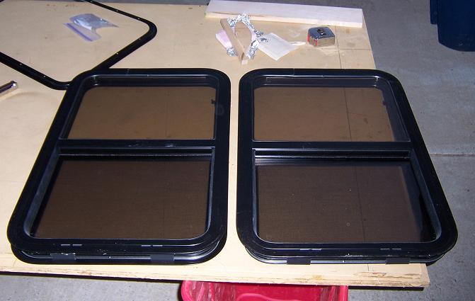

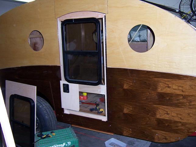

Dave,
As luck would have it I finally got my windows that will be in the doors Monday. They are 18" wide by 27" tall. Got them on E-bay.
I rough cut the seams between the maple and walnut panels. Used a 1/4" router bit to cut a groove between the two. Later I will insert a piece of oak "T" molding to go with the rest of the trim.
The round windows are about 10" in diameter. Found some 1/4" window weatherstrip from JC Whitney (sku 812557) that fits my 1/4" wall. I will use 1/4 tinted polycarb for the window.
The walls are 60" on the outside. By the time you take away the frame, floor and ceiling I have about 54" inside height.
On a side note, I used a -22.5 deg down set axle with 215R15 tires and the whole thing is about 1 to 2" to tall to get in and out of the garage without having to resort to letting air out of the tires once I finish installing the top of the roof. :roll:

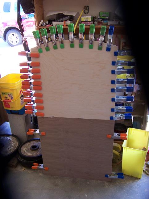

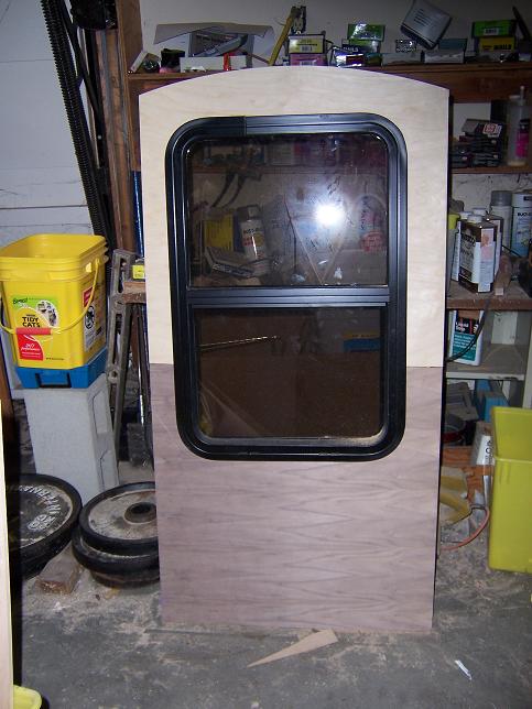

Postby Wolfgang92025 » Tue Dec 01, 2009 11:14 pm
Started working on the doors.
Door frame built, lock and window set in place in doorframe to see it it all fit the way I had planned. Seemed to be OK............ :D
Could have used a few more clamps :lol:
Window set in place.
Installing the locks is next. It will have to wait till the weekend, since I'm working in cold and windy Milwaukee this week. At least I get to go home before the cold wet stuff (aka snow) is supposed to hit Friday.
Wolfgang

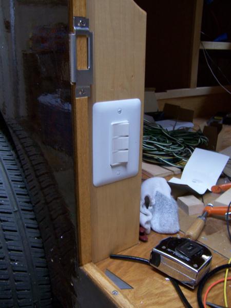

Postby Wolfgang92025 » Wed Jan 27, 2010 10:09 pm

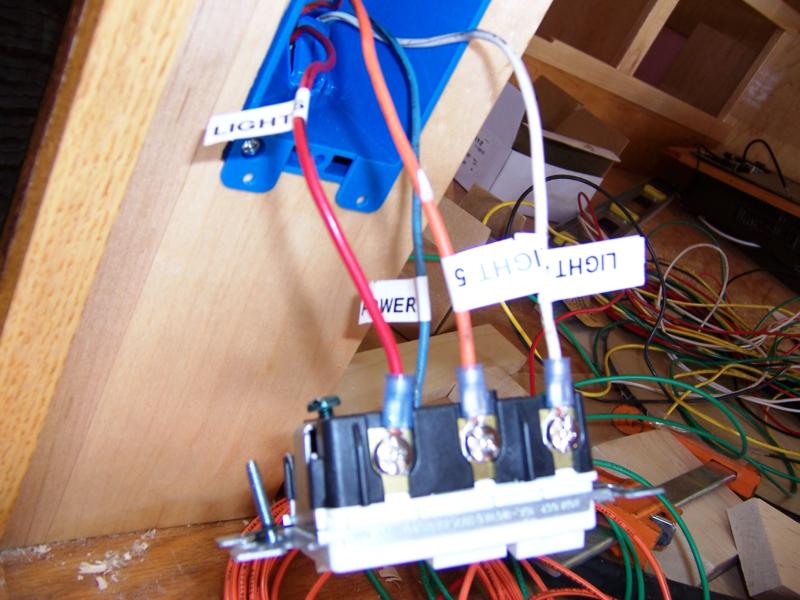

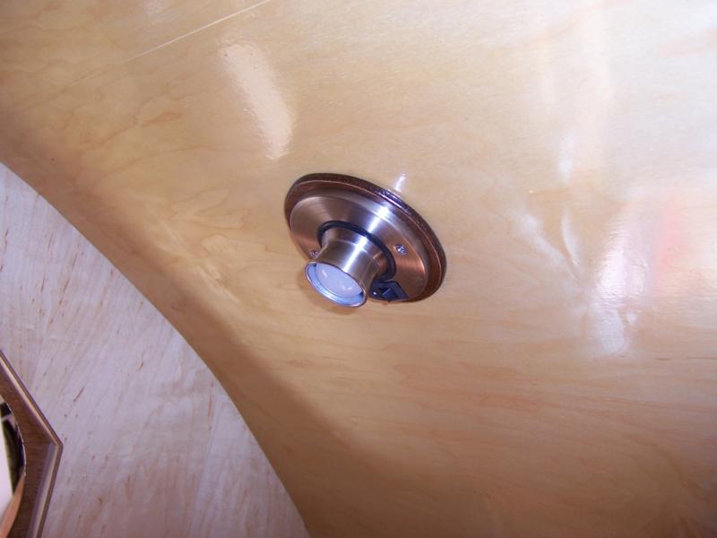

Started on some of the wiring.
Light switch for interior and exterior light.
One of the reading lamps.
More later............

Postby bve » Wed Jan 27, 2010 10:24 pm
Nice work!
The labels are a good idea. The switches are nice too, but I really like the brushed copper lights - all my garden lights are brushed copper - I really like that look.
Burke
