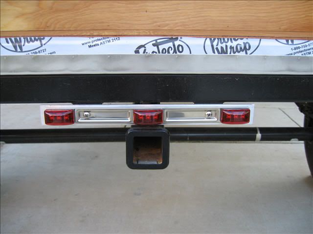

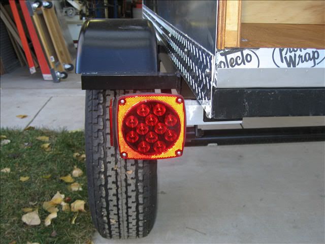

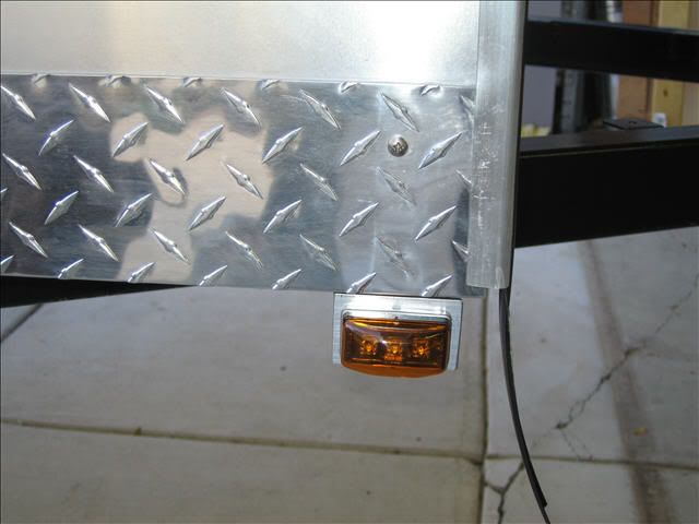

Postby jkidd6339 » Sun Nov 08, 2009 9:21 pm
CPES applied to galley area, cabin floor and hatch.
Mounted the running lights.

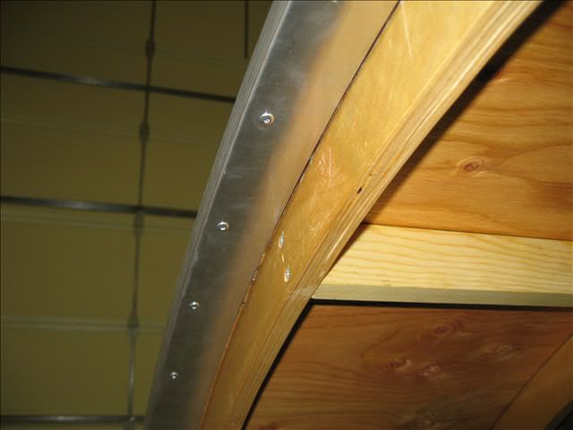

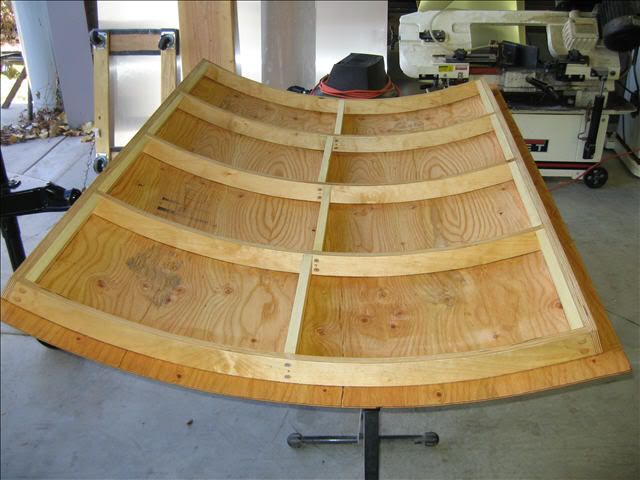

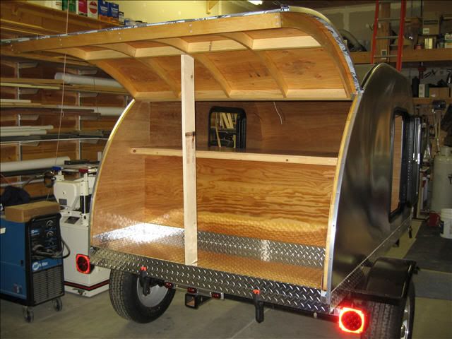

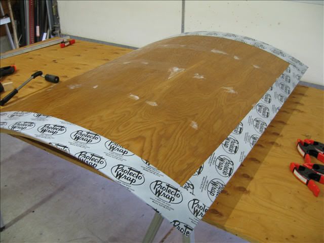

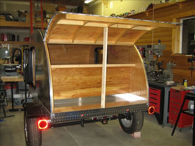

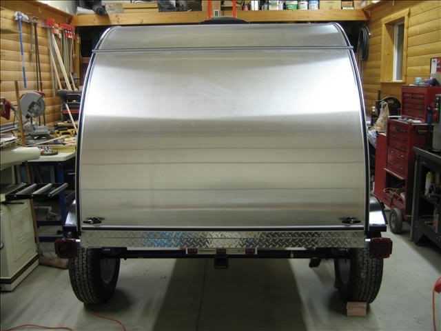

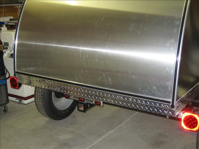

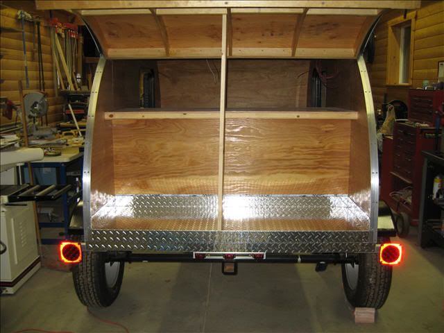

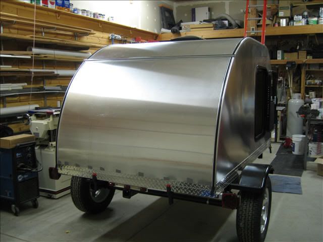

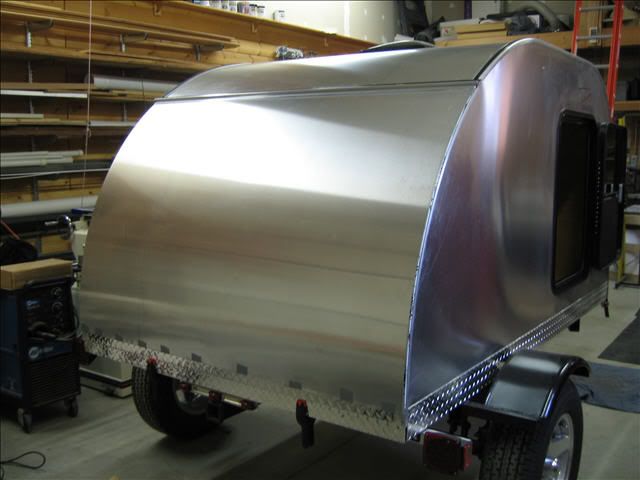

Postby jkidd6339 » Sun Nov 15, 2009 1:09 am
Here's a few more progress pictures.
jkidd6339
Posts: 198

Postby 2bits » Sun Nov 15, 2009 10:31 pm
Wow... Now that's how it's done! ! ! :thumbsup:

Postby jkidd6339 » Mon Nov 16, 2009 1:11 am
Thanks for the comments Grizz and Thomas:
I think I will be spending some time on the hatch triming it out.
Saturday with each step I came up with more questions as too how I wanted
to finish the trim. Looks like I have to have some bent special. I tried to make it by hand and didn't like how it turned out.

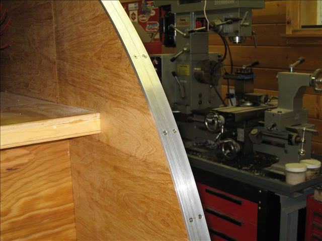

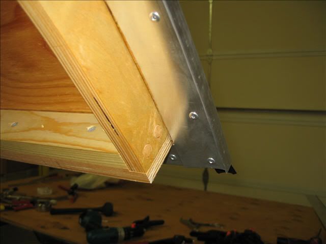

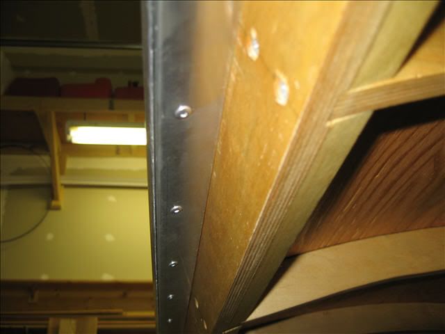

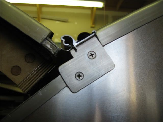

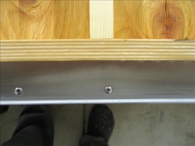

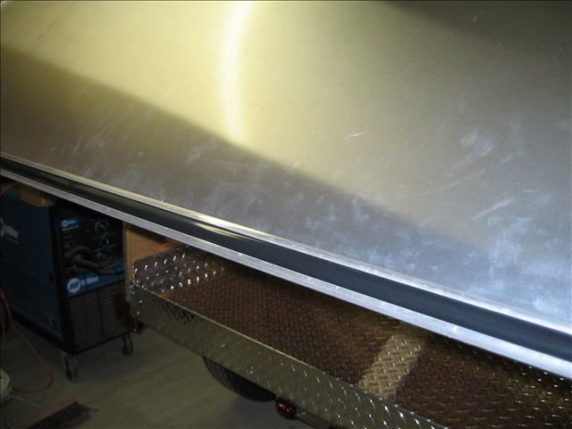

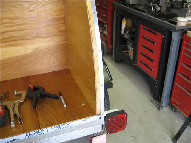

Postby jkidd6339 » Sat Nov 21, 2009 9:38 pm
Worked on the hatch trim this weekend. Here are a few shots
jkidd6339
Posts: 198

Postby 2bits » Sun Nov 22, 2009 8:31 pm
OH man, dangit, that was a great idea running a strip of aluminum on the inside edge of the hatch! smart thinking and smooth look! I might go back and add that to mine! Nice!

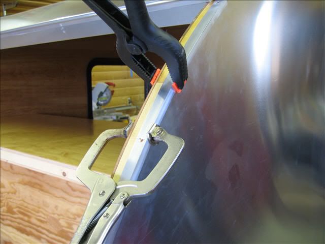

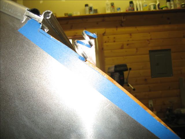

Postby jkidd6339 » Mon Nov 23, 2009 11:59 pm
Thanks for the kind words John
Thomas seems that Utah has a never ending supply of salt in the winter. The plan is to try to keep the plywood away from the water and salt. Maybe it is overkill, but I am hoping to extend the life of the trailer as long as I can. I only hope that my interior turns out as nice as yours.
jkidd6339
Posts: 198

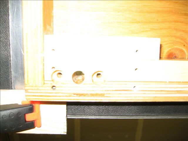

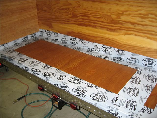

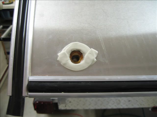

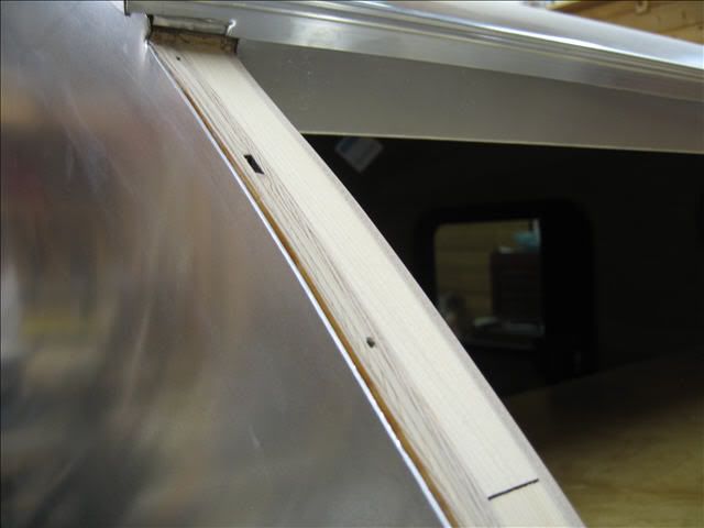

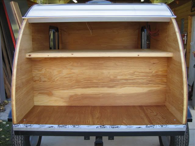

Postby jkidd6339 » Fri Dec 25, 2009 12:03 am
Here is a few progress pics.
Adjusting the gap for the hatch.
Caulking applied to the underside of the hatch.
Galley walls sealed so water can't run under them.
Trim piece at galley hinge still need to make the cover for the top of the hatch.

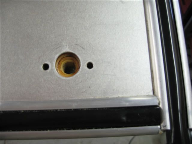

Counter bores for the Tee handle sorry for the washed out picture.
Holes for the Tee handle 2 coats of CPES.
Sealing the Tee handle.
Hatch trim sealed and screwed down.
Galley pan sealed and srewed down.
Hatch finished with the exception of the inside striker plates for the locks.
jkidd6339
