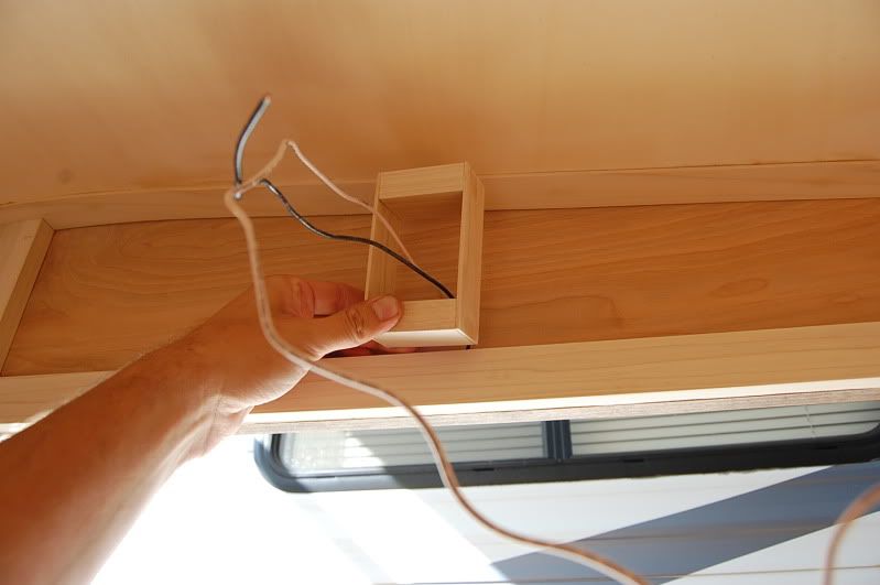

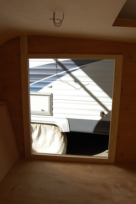

i installed both interior door frames. the frame is blind-doweled for strength. the long piece on the left hides the seam (where i joined two sheets of ply) and hides the porch light wires that drop down from the ceiling. i routed a channel on the backside for the wires. i think i will add a piece to the right side so that side extends to the ceiling as well.
i built a box (from scraps) that will house the one switch that will control both porch lights. i'm going to try my hand at carving and carve a tiki head on the box cover.

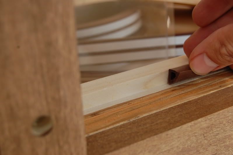

the door frame is 3/8" smaller than the door opening so that it can accomodate a rubber seal.

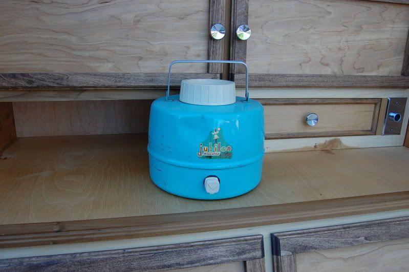

and as a plus, i found a vintage insulated jug at an antique store for $10!

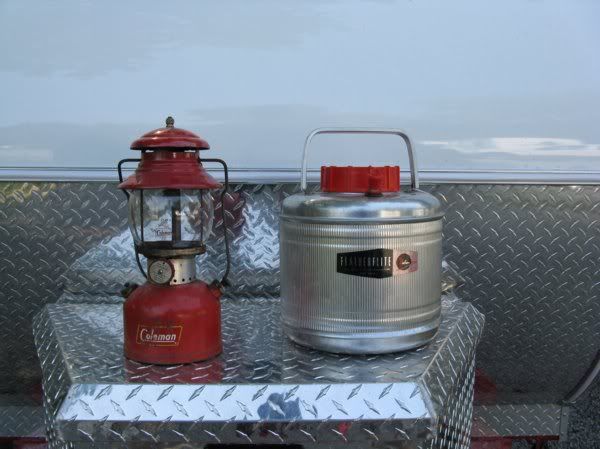

green_eyed_diablito wrote:and as a plus, i found a vintage insulated jug at an antique store for $10!
Nice find! We found one too on an outing in May. Nice progress so far :thumbsup:

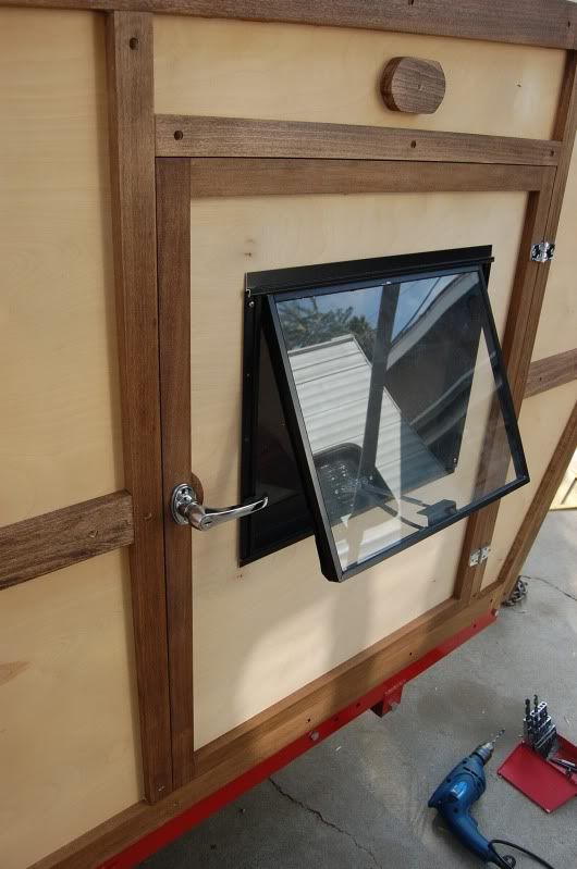

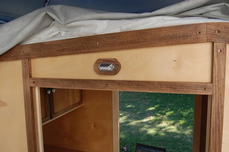

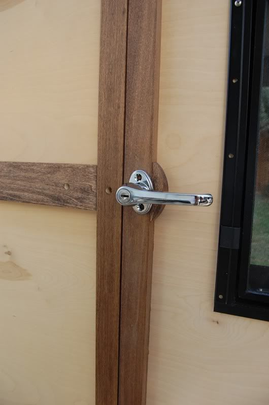

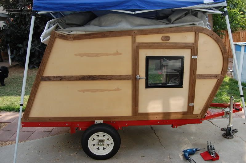

The doors are on! The trim is 2.5" wide, but I used 1.5" trim on the door frame because the width would be doubled by the door's trim.
There was no way to center the handle on the door trim, so I had to add a little bump. It would have worked without the bump, but I didn't like how it looked.
Each side will have a porch light controlled by one switch for both lights.

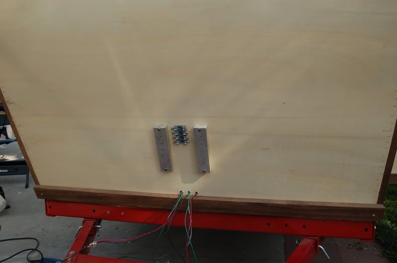

I made my own bus bars with 1/8" aluminum and 1"x3" poplar (all scrap pieces). All the lights and outlets will route through here, then to the battery. I will build a box with a lid around these pieces.
