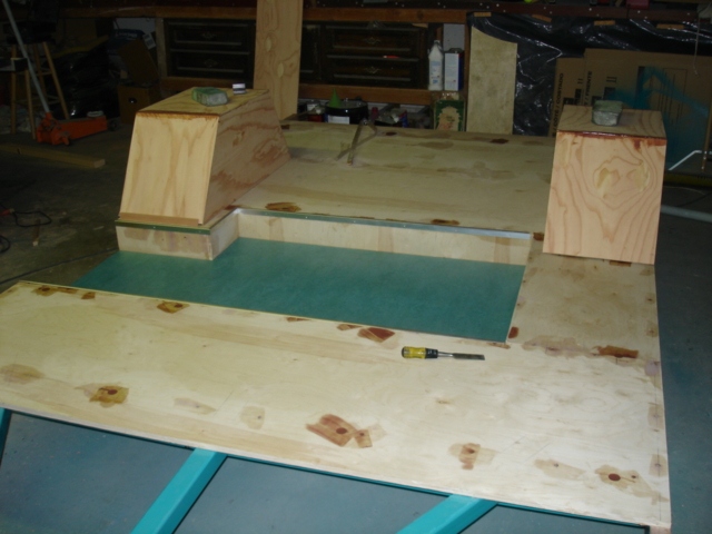

Postby doug hodder » Sun Nov 15, 2009 9:56 pm
Here's this weekends work...doesn't look like much but a lot of this stuff takes time especially when I don't have any specific plans and cook it up as I go. I gotta think a couple of steps ahead so I don't end up boxing myself into a situation I can't get out of.
I met with Grant and Lisa on Sat. AM, had a good visit and a breakfast with them...and picked up my windows from him...there's gonna be 8 total, 2 in front for 15 x 48" of glass, 2 in rear for 12 x 36" and each side gets 2. It's gonna have a lot of light in it.
It took a while to get the 3 main pieces of the floor all situated, drilled, and bolted to the frame with epoxy at all the joints. I then filled the countersunk spots for the carriage bolts/screws with some thickened epoxy and fairing filler, the flooring needs that. I also used some strips of 3M VHB foam tape under the drop floor prior to bolting. It will keep the floor from creaking and it's stuck down way good once it was all bolted up.
I got all the Marmoleum cut and fit up so it's ready to install, (only partially shown), got all the aluminum trim and cove molding for the drop floor cut and fit up. This type of flooring isn't inexpensive, but it's not uncommon to find it in original trailers and in good shape after more than 50+ years. It's almost 3/32" thick and won't tend to tear the top like a typical vinyl flooring as the color goes completely through. So I got the flooring out of the living room, and replaced it with a couple of boxes of windows....
I also got the wheel tubs made up. I left plenty of room in the top so that I can adjust the axle for the correct ride height when it's all said and done. I'll put some glass cloth/epoxy in them and then top coat it with some undercoating for road debris protection. I'm thinking that wood was a great choice as I can use them to attach cleats for the cabinetry. Doug
