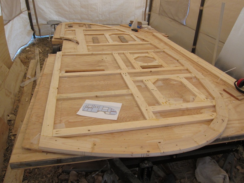

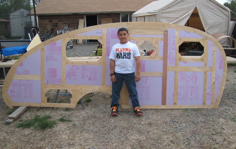

With the better weather I have been able to finish the wall framing. Next time I build a trailer I will probably just use 3/4" plywood. Framing these walls has been a little bit of a pain for me. Not hard to do, but for some reason it just slowed me down a bunch and I still have to put plywood on both sides and insulation in the middle. I just don't think that the insulation will add much to the heating/cooling of the trailer.
Anyway, enough whining. Here are the pictures.
This is the right side wall framing. My daughter Vanessa is looking forward to being able to camp in the trailer.
And this is the left side wall framing.
Now I need to finish buying lights, so I can do the wiring and close up the walls.

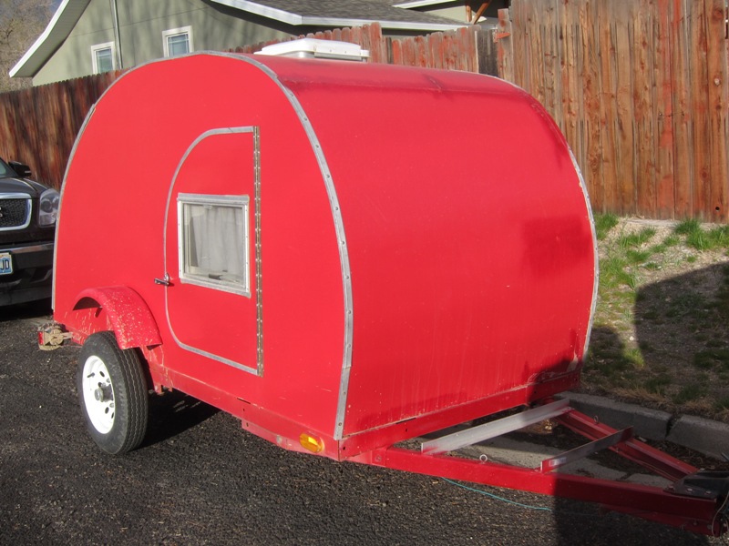

Well I am a real teardrop owner now. This teardrop was listed on craigslist for only $475 and also was local, so I decided to get it. It does need something done with the roof. It is just painted and has peeled in some locations. Will probably cover the roof and hatch with aluminium or something. Don't really want to put much money into it, but want to protect it a little. I will still build my other trailer because this will not sleep my family.

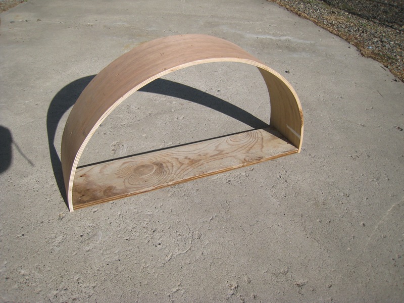

Got a little more building done. A few days ago I made a bending form and made some fender wells. I tried using 1/4 inch plywood, but could not keep it from breaking, so used 1/8 inch plywood instead. The fender wells are 1/2 thick and will be fiberglassed after they are installed on the trailer. Today I built a plywood lumber storage rack. I have always wanted to build one, so finally did.
One of the fenders in the bending form.
Here is the fender after the glue has dried. Still have to cut it to final shape and add a plywood back.

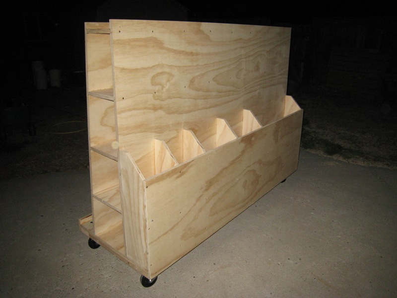

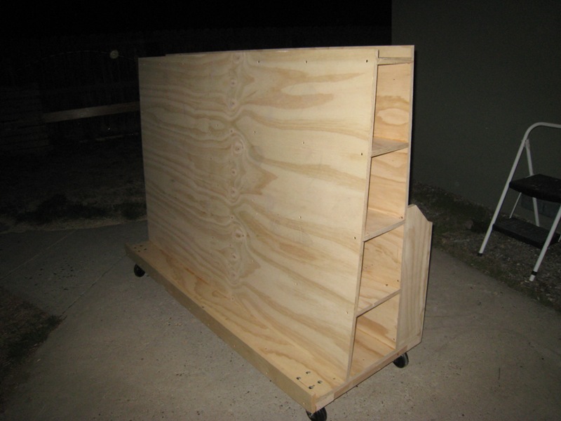

Here is the plywood lumber storage rack. I actually built it in one day! I kind of followed some plans I found on the internet. This is the side that the plywood goes on.
This is the side that you can store cut off pieces. You can also store longer lumber on the shelves in the middle.

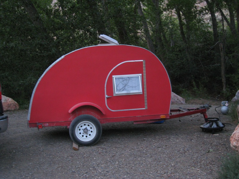

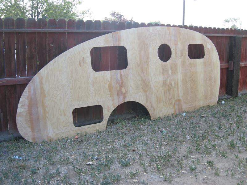

I have the walls almost finished. I have ordered epoxy and fiberglass from RAKA, so I will soon be fiberglassing the walls. Also went on my first real teardrop camp out last night with my son, Josh. We had planned to stay longer, but this morning while making breakfast he sprained his ankle really bad, so ended our camping adventure a little early.
Right side wall and my son Josh.

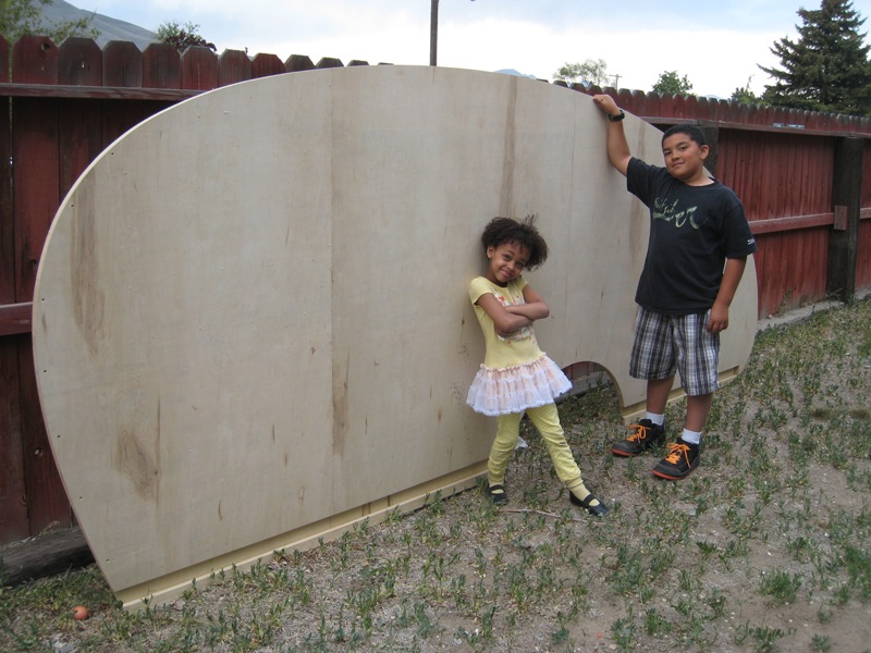

Right side trailer wall, my kids Josh and Vanessa. Both walls are finished.

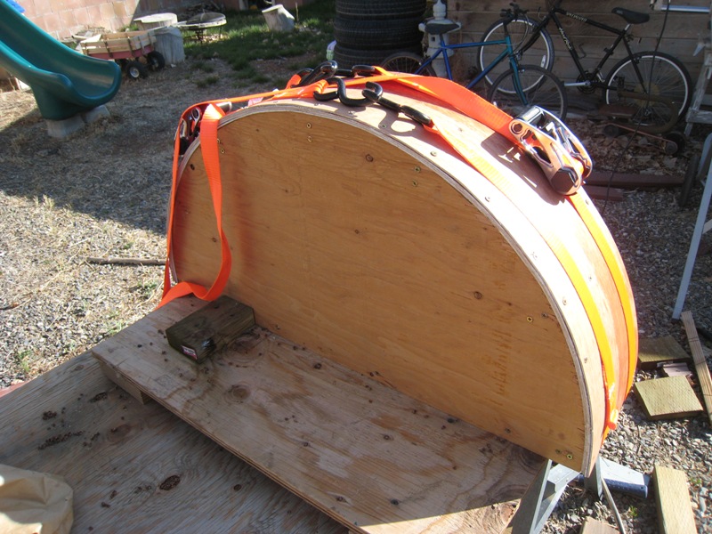

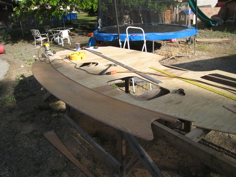

Template with windows and storage compartment cut out. I have also did all the cutouts on the real walls, but have not got any pictures of those yet.

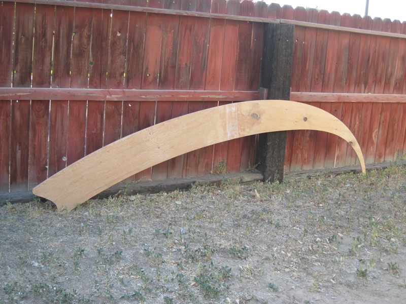

Making the trolley top template.
Trolley top template.
First real teardrop camp out in Water Cayon outside of Winnemucca Nevada. This camping area is only 10 minutes from our house.
