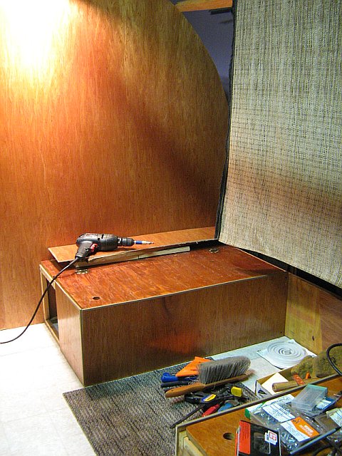

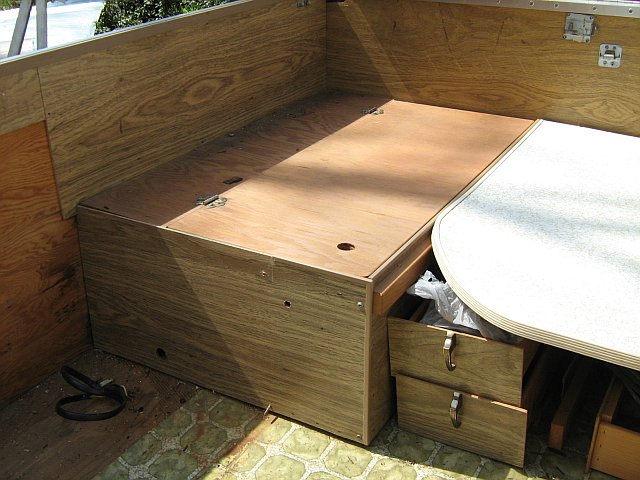

The dinette area is almost complete now, just need to build the table and add the table supports. Here's the "before" street-side bench:
And, here's the "after" shot:
The framing members were salvaged from the original pop-up camper. I carefully dismantled them, labeled and bundled them for re-use. A lot of time was spent prepping them,,,, removing staples, screws, edge trim and the facings. As a result, very few additional supplies were needed. New facings, some poly, screws and glue. Probably around 20 bucks in new materials, within budget. 8)

I planned to build the closet today but instead decided to re-do the end panel on one of the dinette benches. It's the bench just inside the entry and has an access door. I wasn't happy with it and it was bugging me, so tackled it today. Grass is too wet to mow, guess I'll have to keep working on the camper in the meantime. Life is good!

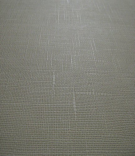

Today I applied the vinyl with 3M spray adhesive and rolled it out with the laminate roller,,, without success. I had stored the vinyl flat in hopes that a fold line would "disappear" but the crease appears permanent along with other wrinkles. Here's a pic of the vinyl/laminate corner:

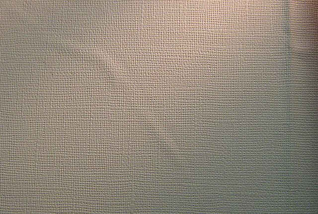

Here's a close-up of the crease:
I'm a bit disappointed. I had done a prior sample test which worked great,,, but the sample piece was un-creased. Additionally, today's application was on a standing wall and I wasn't able to apply clamped pressure to the entire surface. I tried smoothing out the crease using a heat gun but that wasn't successful.
This wall will eventually have a cabinet and sink, so those will cover the goof but I will have to consider a different approach for the remaining two walls. I'm wanting a water-proof lining and would like to avoid having any seams. Maybe if I apply the vinyl to the walls before installing them? I could then clamp it together with another sheet of ply and apply weights. Or, scrap the vinyl idea and cover the walls with a patchwork laminate pattern from my pile of salvaged scraps! :lol:

Postby grizz » Fri May 21, 2010 2:22 am
Hi Gary,
I think application before fitting it may be one answer.
Alternately, go in to the people who are using the materials, and ask them the question.... "How do you manage creases ? "
Another thought would be to use the contact glue on both sides, and then when it has gone "off" toy apply the sheet, and use just finger pressure to connect the bits that stand proud.
I would also get a 20ml syringe, and at least a 18 gauge needle, and suck the air, or at least puncture the bubbles, and then again use pressure to flatten, and get the 2 glued sides to bond.
Hope that helps.

Postby vtx1029 » Fri May 21, 2010 4:39 am
Applications like what your doing are hard. I've installed way too many aircraft de-ice boots to count, talk about a nightmare. Try rolling out a 12' long boot and get no bubbles or wrinkles, you can't pop them and boots are really costly so its almost a one shot deal. But you can use the application and theory. Go find some 3M 1300L adhesive. Pour some in a cup and mix in some MEK (you can get it at most hardware stores) to thin the adhesive out just a little thicker then water. Then brush both surfaces with adhesive using a single stroke method, don't overlap your strokes too much and go in the same stroke direction. It takes 10-30 minutes for the adhesive to dry to a tack. apply 3 coats on each. When its just barely tacky then roll the mat up and start in a corner using a roller and slowly roll it and stick it down as you go using a roller (this is a 2 person job) If its not sticking too well you can lightly rub a rag soaked in MEK across the surface to activate the glue some more. if you get bubbles you can pop them with a pin and roll the air out.
One trick you can use to keep it going on straight is mark both surfaces with a center line before laying up the glue the glue is transparent so keeping it aligned straight is easy.

Postby StPatron » Fri May 21, 2010 2:12 pm
vtx1029 wrote:Applications like what your doing are hard. I've installed way too many aircraft de-ice boots to count, talk about a nightmare. Try rolling out a 12' long boot and get no bubbles or wrinkles, you can't pop them and boots are really costly so its almost a one shot deal.
Thanks for your suggestions, vtx1029.
Luckily, the size of the material being used on that wall is easily manageable. A 12' piece would be a nightmare!
It's a combination of application error along with permanent creases in the thick vinyl that I don't think can be overcome regardless of adhesive used or technique. That second pic was poor as it didn't highlight the major problem, the crease.
I've experienced permanent creases with other fabrics. Mfrs. sloppily fold the material lengthwise, rarely is it evenly distributed. Then, it remains on the bolt and that fold crease sets over time. Even with cloth, steaming is sometimes unsuccessful. This vinyl is very thick and has a better than average memory.
I plan to lay out the remaining vinyl today and see if I can cover the other walls using pieces cut from each side of the fold crease, even if it means having an overlapping seam or two.

Postby StPatron » Sat May 22, 2010 1:22 am
When I checked the vinyl today I discovered it was very loosely adhered. So, I decided to try a little experiment by pulling the upper half down and using contact cement on it, same process as used with laminate application. Apply, let dry and then roll out. I used the larger laminate roller on most areas and a small, wooden wallpaper roller on any stubborn areas. Worked great with the exception of the fold crease. Improved but still visible. The spray adhesive performed better in my test sample, go figure.
For the other two walls, I plan to cut out the fold crease, overlap the edges and add trim if needed. Another hurdle cleared. Thanks to all for your suggestions.
