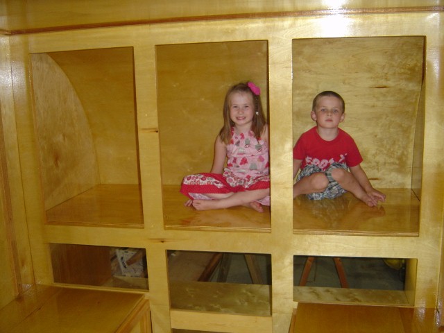

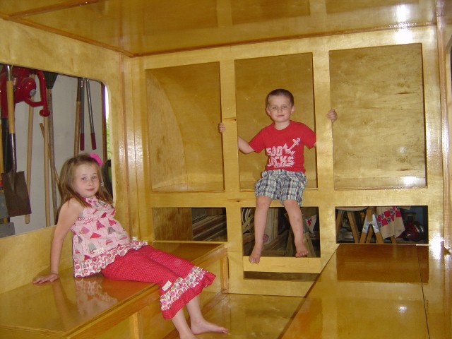

I spent the last few weeks painting and sanding.
I put 3 coats of spar varnish on the entire interior of the camper, sanding with 220 grit in between coats.

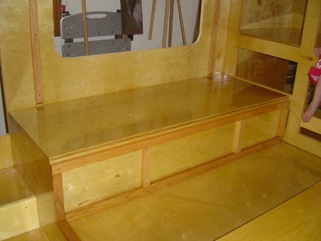

Front Bench
Center Benches

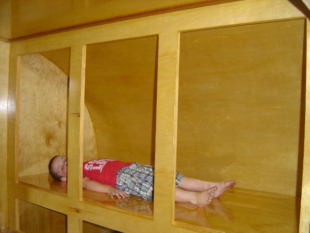

Kid 2 & Kid 3 testing things out.
Kid 3 relaxing in the rear bunk.

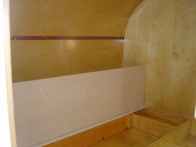

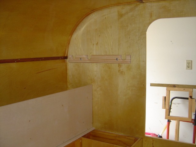

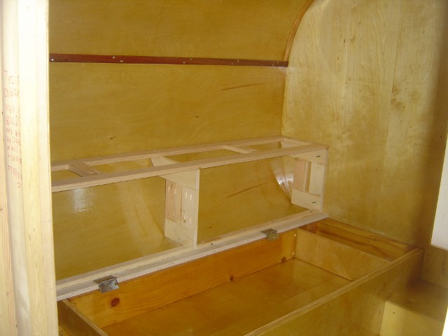

Next I framed up the backrest for the front bench.
Next I glued and screwed a sheet of 3/4" birch ply to the back rest. This board is about 6" taller than the backrest framing. Creating a nice storage cubby.

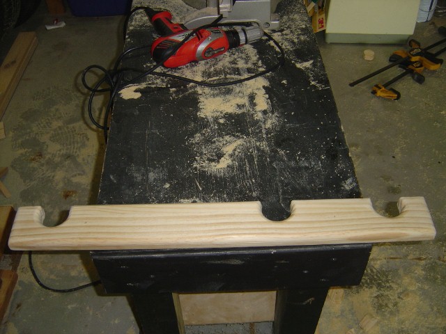

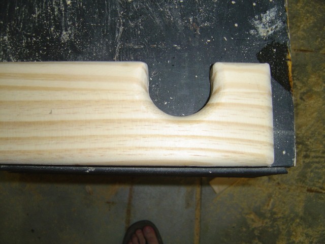

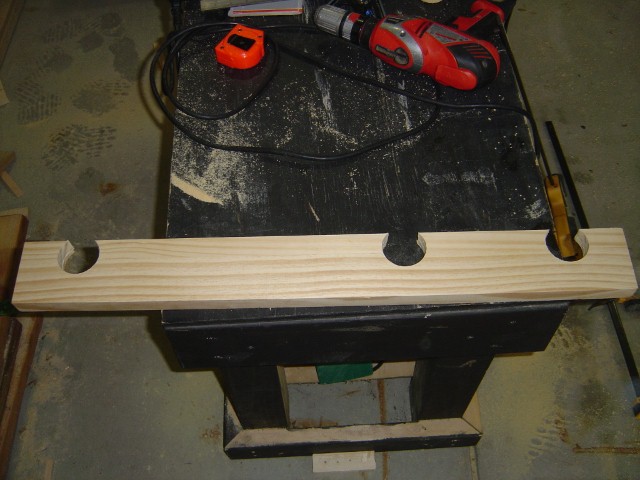

Next I made brackets for the top bunk/cot. First I cut a 1 1/2" hole using a hole saw.
Next I cut off the corners with a jig saw and then went around the entire board with a router.
Next I bolted in place using two 5/16" bolts and t-nuts.

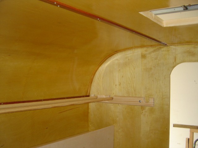

Heres the poles in the sleeping position.
And in the storage position.
Only have a couple more items to finish of the interior; ac, lights......

Postby StandUpGuy » Sun Jul 24, 2011 8:44 pm
That is an aweful long span for those poles to make. I think you are going to get a very lot of sagging under weight. It is a very cool idea but have you tested the poles with like 65 lbs on them?

Postby J.Heyboer » Mon Jul 25, 2011 7:13 am
I got this idea from others on the forum. It looked like they had used standard closet pole dowels. I will test it once I have the canvas sown up.
I can always upgrade to a larger diameter pole if need be.
