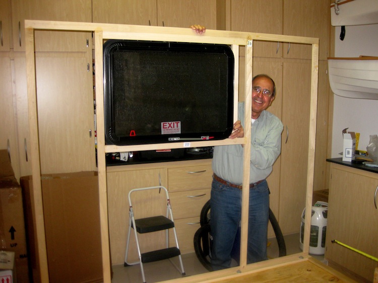

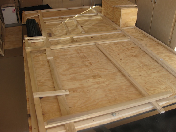

Today, with the excellent advice and assistance of Cliffmeister, we began construction of the walls--rear and front.

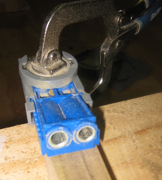

I was pleased to see that the spacing of pocket screw holes on the Kreg Jr. was just right for placing two screws in 1-1/2-inch wide strips. This adds more rigidity at this early stage.
Here's the structure of the rear wall with the window inserted for fit.
The front wall consists of two parts. This is the vertical section. Notice that the floor is now bolted securely to the chassis with eight 1/2-inch bolts connecting angle sections of the chassis, the 3/4-inch plywood floor, and the 3/4-inch poplar cleats that surround the perimeter.

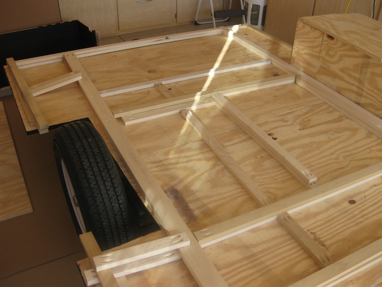

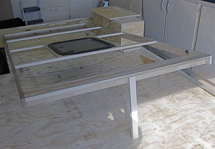

Again, not particularly exciting or informative pictures, but this is today's accomplishment: framing the pop top. The skylight in the center will be fixed, non-opening.
I deviated from my original design somewhat. In particular, I eliminated the two nearly 8-foot framing pieces that would have been placed on each of the long sides inside the 2-1/2-inch side pieces laid on edge. Eliminating these saved some weight and the rigidity seems satisfactory. I won't have any heavy snow load to contend with.
Oh, I also finished the upper front section left over from yesterday when the screwdriver battery ran out of juice.

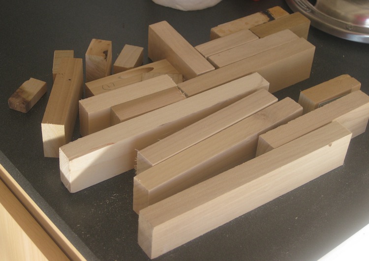

The next picture is the most interesting one I have taken so far.
What? Are you kidding? What's so interesting about a few scraps of wood?
Well, these are the only pieces of scrap that remain from all the 12-foot lengths of 1-1/2 framing that I used for all four walls, the pop-top, and the cleats around the perimeter. The largest piece is only 8 inches long. I couldn't have planned this more precisely in a million years. Sometimes you just get lucky.
