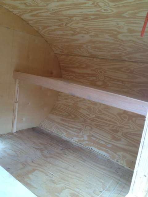

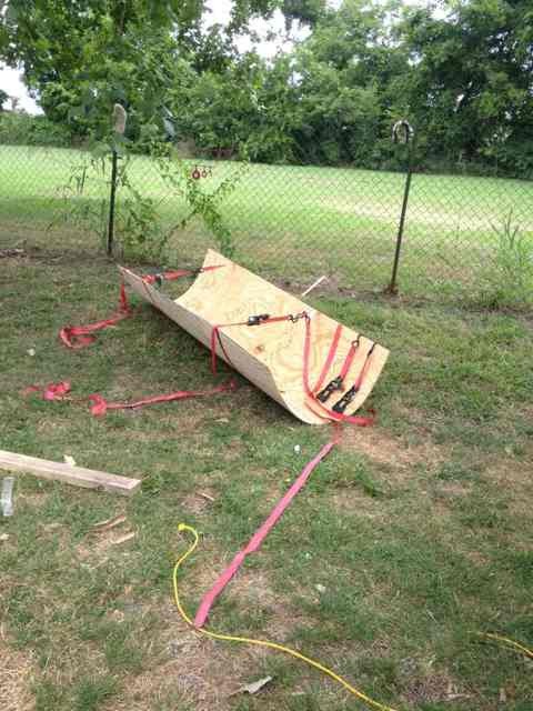

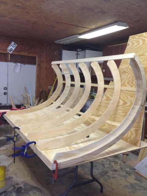

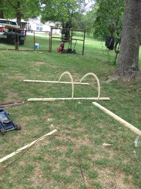

This is what's left of the old hatch. While taking it apart the ribs where breaking. Figure out that it was from running screws into the plywood end grain. So that lead me to trash it and start over. Also am beefing up the ribs and the side pieces. So I am guessing that building somewhat in place is the way to do the hatch? I was able to get the upper bunk made and installed.

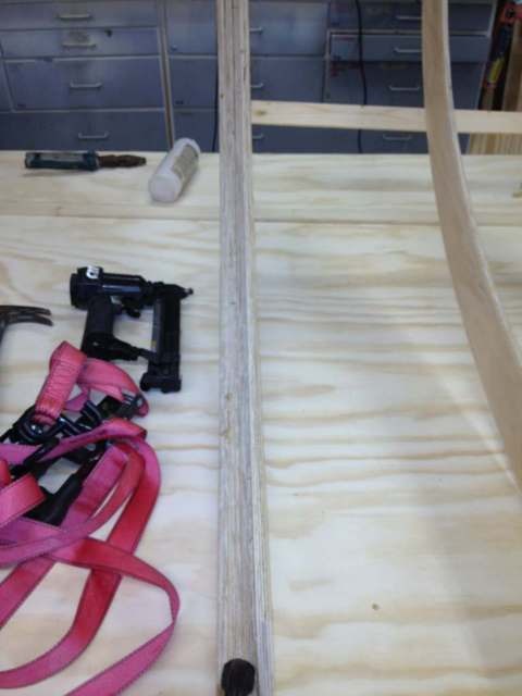

The ribs are now 4"x1/2" they where 2"x1/2". As you can see in one of the pics the nail gun. No screws on this go around. Using 1/4"x1" staples.
