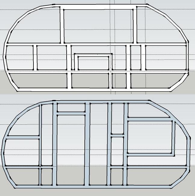

The only thing I have in the way of pictures, it the cookie cutter design for my side walls.

Postby absolutsnwbrdr » Mon Jan 23, 2012 9:21 am
Sounds like you're at least headed in the right direction Paul. Collect those parts and keep planning as much of the build as you can. When it comes time to build, then you should be able to really pick up the pace.
Nice work with the cookie cutter layouts!
