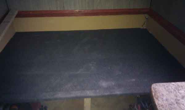

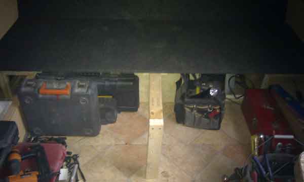

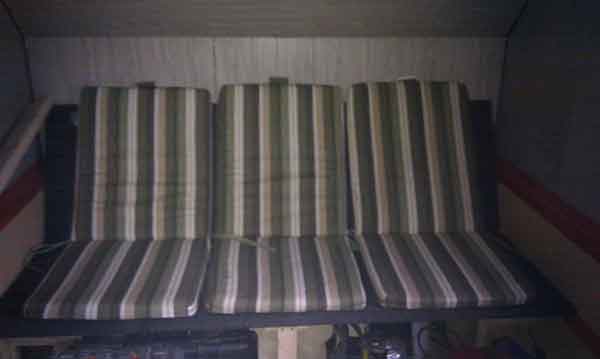

Kept trying to figure what to do to support the bed.
Had a brain fart that simple would work, so I notched the cross brace for a 2 x 3 with a simple leg in front and over the water tank.
It pulls out 22 inches and hits stops in the water tank cubby
The the back board for the couch lays across in and sits on cleats on wall,
The cleats were previosly installed because I knew I needed them
Holds my 200 lbs+ no problemo
Then I cut down a tabletop I had and mocked it up under the window,
Notice the indefinatly adjustable table leg to level table out if the campsite is not level, 20 tonn should handle that task sufficiently me thinks.
I think it will work out for morning coffee and cards/Yahtzee in the evening
have 2 light Bistro chairs that will probably be used here. Should be able to get up and have a coffee without making the bed back up into a couch.

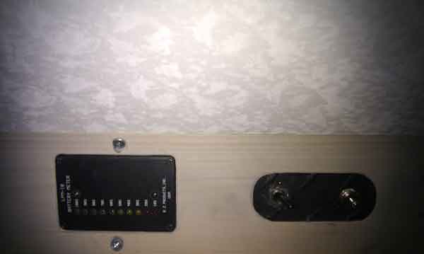

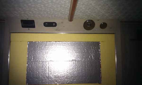

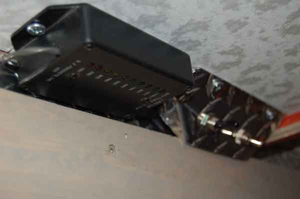

Well I really hated how I mounted the switxh for the fan and the battery monitor.
So today i cut a panel Positioned everything and then cut the holes, Still didn't completely like it so got out my trusty knife and chissel and counter sunk everything.
Why use a router when a knife and chissel will do? Not only that it takes longer that way so it killed my afternoon.
Much better...
Battery status and momentary switch for battery mon and on - off - on momentary switch for fantastic fan and I made a switch plate out of Diamond plate and painted black

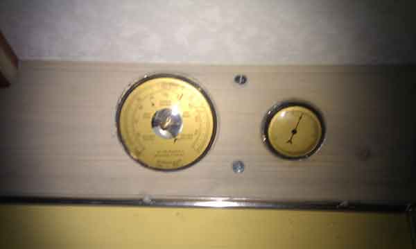

Barometer and relative humidity
Decided on no clock as I don't wear a watch cause I could care less what time it is, so when I'm camping I care even less

Chris those are some nice switch panels what all are the brass gauges that you have there? Keep up the good job :thumbsup: :applause: :thumbsup:

droid_ca wrote:what all are the brass gauges that you have there?
Barometer and relative humidity, Just because I had them...lol

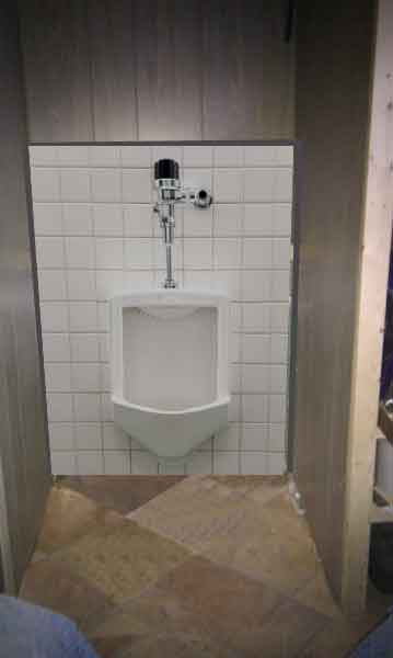

Postby Martiangod » Sat Mar 10, 2012 8:54 pm

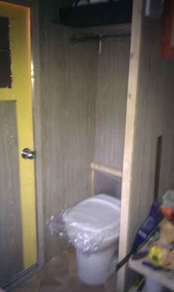

Well cut the hole and test fit,
And it fits
Once I fit the handsprayer should be great for washing hair and brushing teeth, seein as I dont have room for a sink :D
Gonna be nice this weekend weather wise so time to get the holding tank in.
One problemo has cropped up though, My stabalizer jacks interfer with the holding tank by about an inch, so off they have to come.
Oh well If I can't get them back there I'll move them to the front and rethink the back jacks.
Lots of rethinkin involved in this project.
Then the boss made me rethink, or not get fed, ever again, soooooooo!!!!!
Instead Seeing as I like food

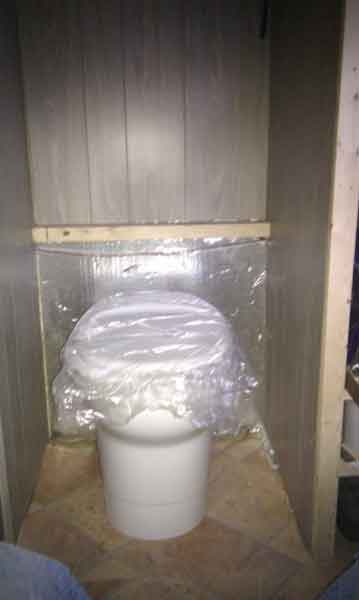

IFit the throne into its little spot, should work out.
Tossed around porta pot or throne and seein as my knees are getting no better and the wife has had one hip replaced
Image.
She can get stitchin now, and make the curtains for the window and a privy curtain.
Guess the closet is sort of no longer a closet, well its still a closet, a water closet,

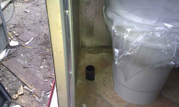

Postby Martiangod » Mon Mar 12, 2012 3:50 pm

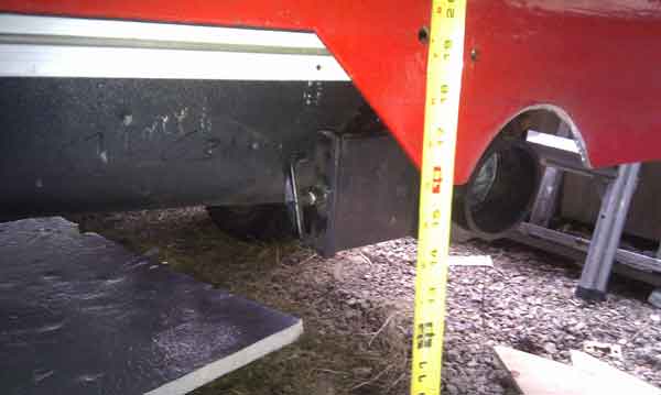

Got the holding tank installed today
Was pretty tight for this big tank, had to take existing fittings off repair crack and mount new stub and valve, not really where I wanted to have the valve, but the simplest, just behind the back bumper, had to cut out the half moon so a hose can be hooked up
I've got over 13 inches of road clearance on the lowest point of the valve, AAnd I will be going to higher profile tires so shouldn't hit it on anything
Wanted to do the vent up the other side of toilet but ran into a frame member, will elbow back and across then up through roof.
When I put sink in for kitchenette, it will tee into the vent and go into the black tank, unless I find another tank to go between the axels. But one tank should suffice for weekending. Might two way the kitchen sink, so if we are able to, can run it on the ground
Toilet is permanently installed, Just complete vent and the loo is done
Did have to move the stabilizer jacks I had to the front, was just not enuff room with the tank in to keep them on the back. May go scissors on the back, which I hate or possible drop down jacks bolted on the back corners

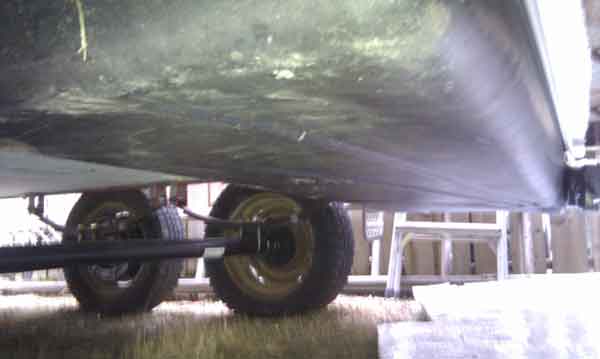

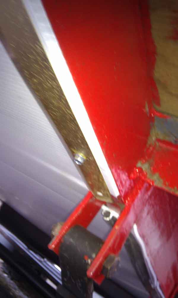

Well got the underbelly on and no black sticky goo required. God I hate that stuff, especially if you need to work down there later, it always haunts you.
Used 2 sheets of Coroplast, Cheap, very light, easy to work with, not sticky, no varsol required or horrible to work in plastic gloves.
Screwed it to the bottom of the frame to protect the styrofoam using aluminum carpet to lino transition strips I had kickin around.
Any bits and piece of aluminum cut offs, your waste would work fine
Another thing is it lessons turbulents under the trailer with a much more areo surface.
Now just need to plug the truck in and hope I didn't hit any of my wireing...., but its all in conduit so hopefully I'm good
Thank god this weather is so nice, been wanting to get that done .
Only thing left to do underneith is wire the brakes and a bit more paint

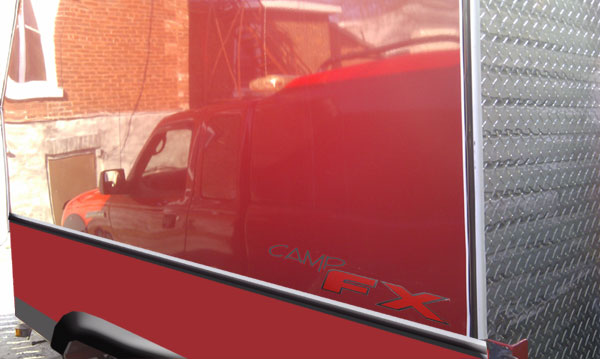

Think I'm just going to get another sheet of red aluminum, continue to the bottom, match the charcoal rocker stripe on the truck
Shouldn't cost much to get decals made up

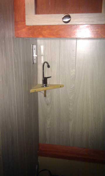

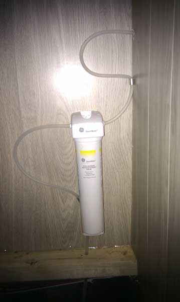

Well, installed the drinking water filter and a temp instal of the tap
FIlled the water tank, hit the pump and checked everything, all good

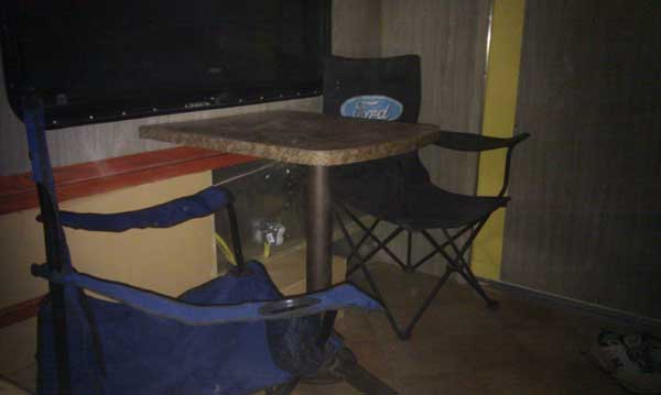

Then she needed to go shopping, we found a folding chair on sale for her, the blue one, $9, I might get one tomorrow

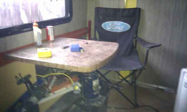

Rigged up the table semi permanent till I get a floor plug and leg

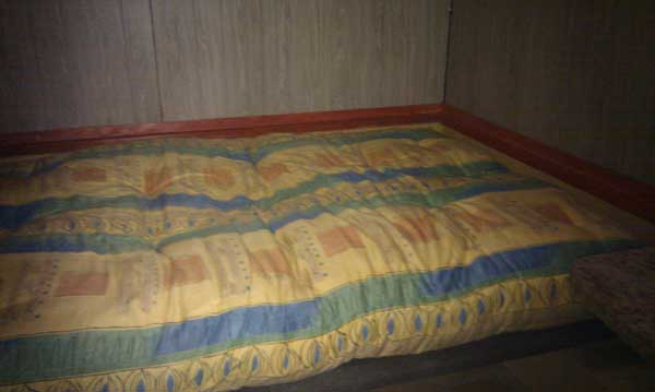

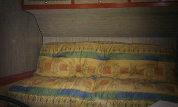

Then She picked out a Futon for the trailer, goes pretty good
and comphy too
