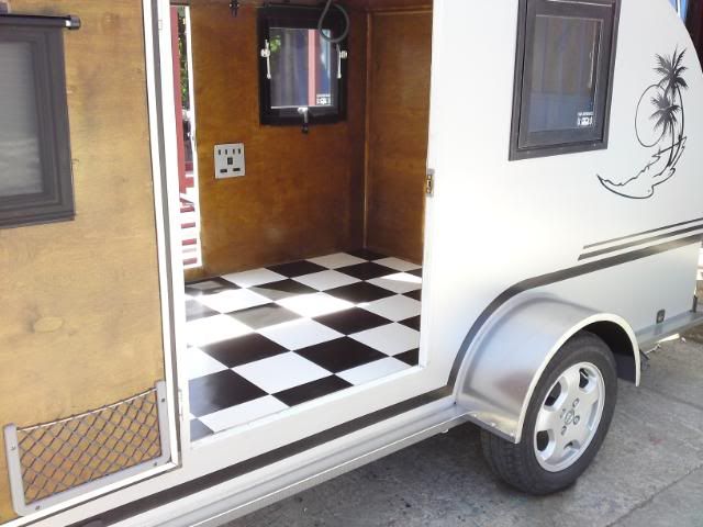

I am sorry to say this is
The trailer had to cut the side tabs
People are very curious
are sitting on top of
Unfortunately, I had to shorten the
Curtains can be used as mosquito nets :)

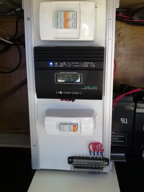

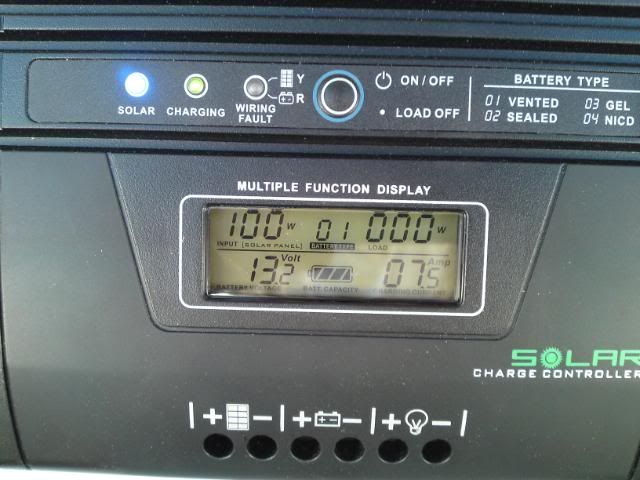

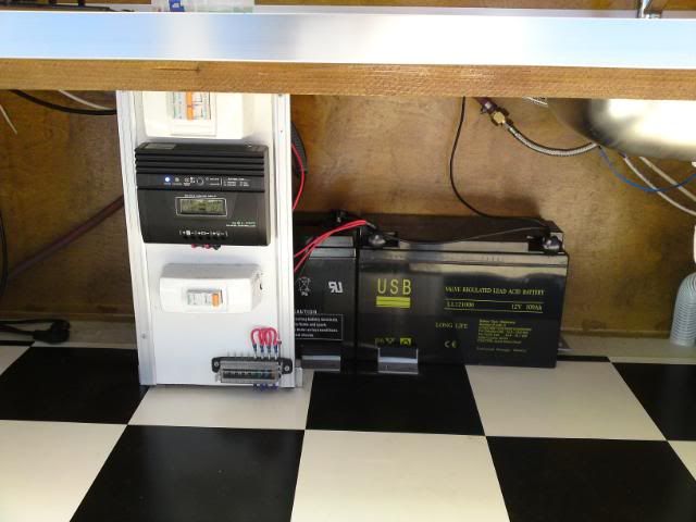

12/220 volt Led
Solar panels :thumbsup:
80*2=160 Watt
glued to the ceiling panels (Sikaflex -252) :D

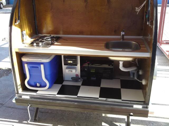

wow, thats some trailer there. :thumbsup:
galley is too pretty to use. :FNP

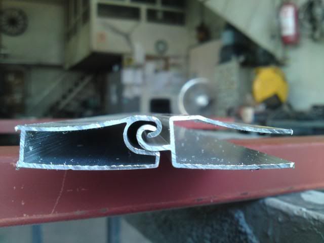

the rear door hinge
Automatic shutters of aluminum to build
store the energy provided
