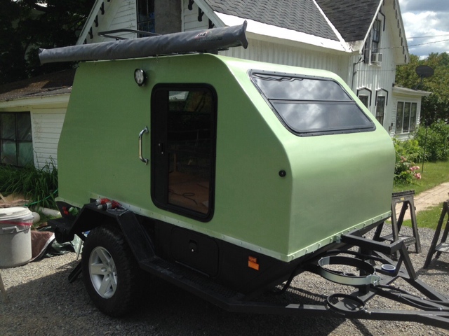

Postby matthewp » Thu Jun 26, 2014 6:34 pm
It's been a busy weekend, but I'm getting somewhere! I hope to have the exterior finished next weekend (Sorry the previous photo didn't show up!).

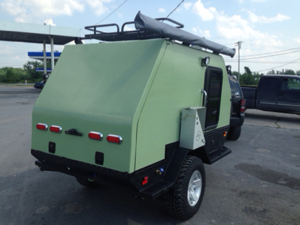

Matthewp's MuTTT (Multiple Terrain Tactical Teardrop).
Postby matthewp » Mon Jun 30, 2014 7:19 pm
Ok. So. She's a little fat! According to the scale, 1780lbs. fat! That's without 23 gallons of water, two batteries and no galley! I'm expecting a total weight around 2300lbs., which is at the top of my weight plans. At least the outside is finished!

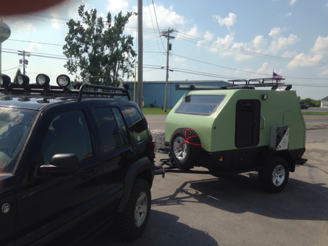

Postby matthewp » Sun Jul 13, 2014 4:14 pm
Look what followed me home yesterday...
