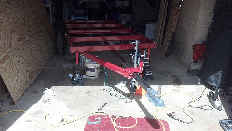

Postby Kharn » Sat Mar 15, 2014 1:27 pm

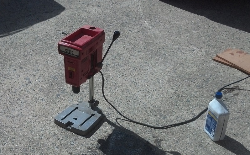

So here's what I had to work with for drilling the remaining 3 holes. :lol:
And here's the test fit.
Tongue test fit.jpg (151.24 KiB) Viewed 2944 times
I've disassembled it so I can paint the extension and the factory tongue.
Going slow, and using a ton of 5W30 as cutting fluid made it super easy. But now I have a big 5W30/steel shavings stain on my driveway. :thumbdown:

I did find out my 3" tongue/coupler bolts aren't long enough, I never thought about how thick washers for 1/2" bolts are so I need to get two 3.5" bolts sometime this week as the 3" ones don't touch the nylon part of the lock nuts. I must not have mixed the paint up very well for the third coat, it has more of a flat appearance than the intended hammered finish, but those spots are mainly in non-visible areas.
I also tested out my tongue lock, it works with the new coupler.
Painted frame 20140321.jpg (192.46 KiB) Viewed 2756 times

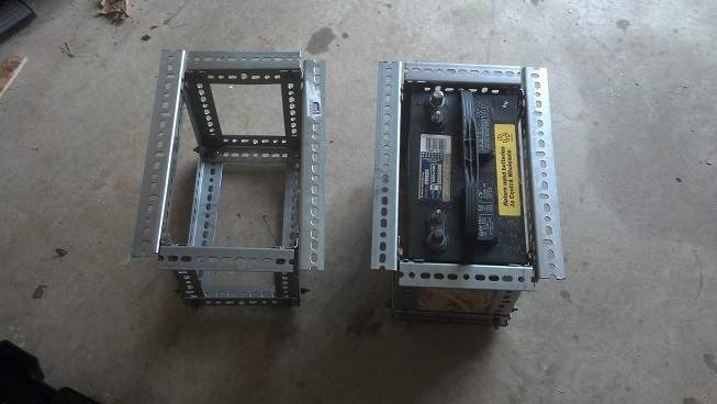

I decided to jump into the double-battery-under-the-bed design with both feet.
Zach might brag about using a jigsaw to cut his, but that didn't work for me as it broke one blade and just made a mess of things (it seemed like half the stuff on my workbench ended up on the floor :x ). So I switched to the angle grinder and woke up the neighborhood around 8:30 this morning.
The angle grinder worked awesome. I also found another key to using angle iron is to always cut through the middle of a hole or slot, to keep the spacing correct and make squaring everything easier.
I included an extra 1/2" of space on each side of the battery so that each front and bottom face, plus the outer face (since they'll be just 4" apart across the tongue bar, I didn't think they warranted protection between them), can have a piece of plywood to keep a stone or whatever from wrecking a battery. I'll probably just use one battery for the time being and add the second one if we are going to do any cold-weather camping, but I wanted to have both cages installed during the build vs trying to copy the first cage afterwards.
20140322 battery cages small.jpg (84.11 KiB) Viewed 2712 times
You can see one of the scraps of OSB I was using to test the sizing.
The battery protrudes above the cage about an inch, since it will be lag-bolted to the 2" joists that will support the bed, and accessed from above, so it didn't have to be the full depth of the battery.
