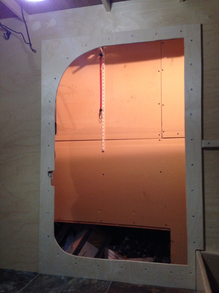

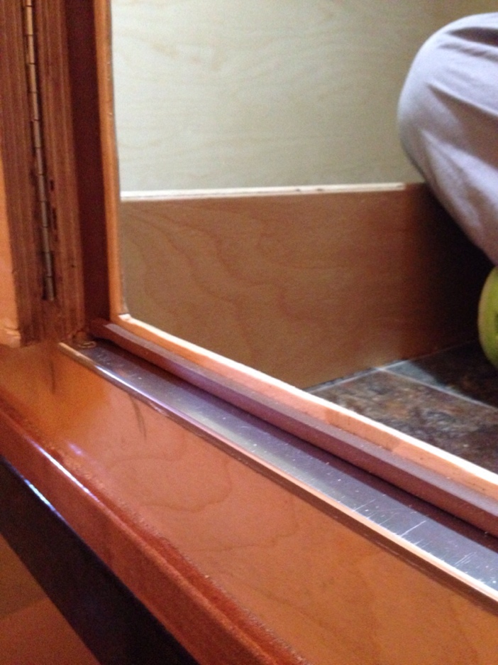

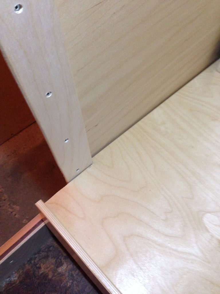

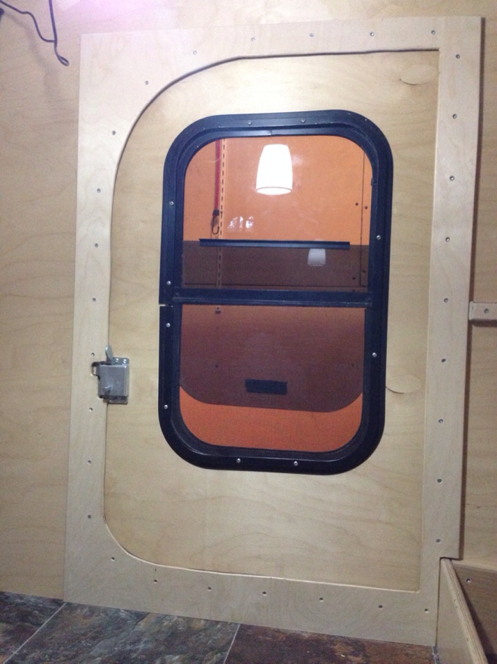

Second job I've been putting off was to get the cabin door sealed so no water or insects could attack the unsuspecting camper inside. Not having any easy (read cheap) access to aluminum T trim or other beautiful and typical TD parts and seals I decided to make trim ring for the door opening on the inside for the cabin and seal it from the inside rather than the out. It seemed like the most reasonable and easiest to do. I think for the most part I used the Steve Fredericks method? I might have that wrong - sorry If I do. i read a lot of threads trying to get a plan in my head. Here's what I ended up doing:
1. Took some 1/2" birch ply and cut out a 28"x 42" rectangle. That sheet was about 4" wider than the door opening and 6" taller than the opening.
2. I put that sheet on the inside of the cabin against the door opening and traced a pencil line around the door opening and onto the plywood. Then with the sheet outside again I penciled in a line 5/8" smaller than the line I just traced of the door opening.
3. Jigsaw out the centre using the line just drawn.
4. Then I used a router to cut a 3/8" wide by 1/4 deep rabbet along the inner edge of the hole in the sheet of ply. After that some sanding, 1/8" round over routing on all edges and a few other little cuts to notch out some spots for the door latch.
5. From the inside of the cabin I screwed this trim ring to the cabin wall with the rabbetted edge toward the outside of the trailer. To complete the rabbet I used a 1/2" flush trim bit in my router and carefully by hand guided it around the door opening so the bearing ran along the existing door opening edge. A bit more sanding and some trimming with a chisel and I had an inch of wall material the same shape as the door opening and then a 5/8" ring that 1/4" thick and was smaller than the door opening.
6. Lots of coats of poly to seal it all up.
7. Reinstall the aluminum trim peice.
8. Install a 3/8"x3/8" epdm rubber door and window seal (wave profile according to package) from local hardware store. I have a gap between closed door and inner trim of 1/4" so the 3/8" seal adequately squeezes but doesn't completely crush when closing door.
... That's it. I haven't water tested yet but it looks like it will work. Here's some photos to help make sense of all this...

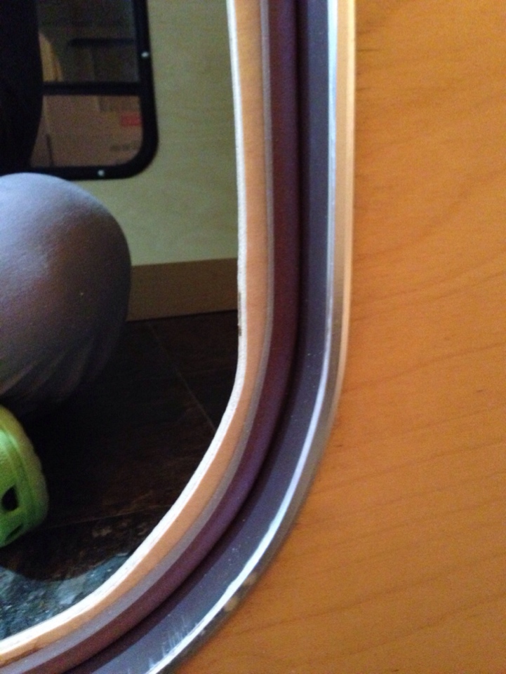

Here's a couple detail photos of the trim and seal setup from outside...

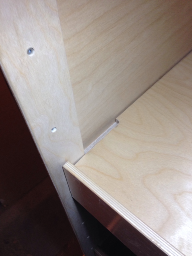

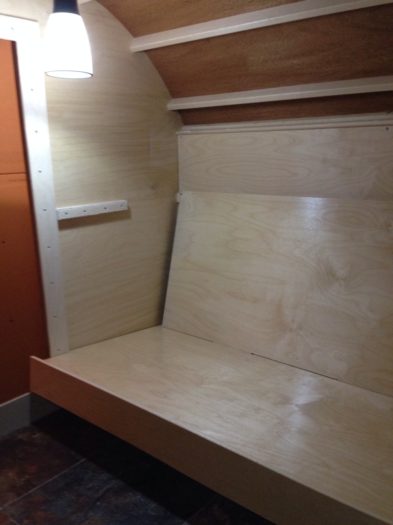

Last small job for today was to refit the bunk bed and couch. Now that the door had an extra 1/2 of thickness I had to cut some notches out of the bunk bed base so it would fit back into the correct position in the trailer. Also I had decided earlier that I was also going to take a little off the length of the bed base so it wouldn't be such a perfect fit. I cut a 5/8" notch in the front left side of the bed base and then took only an 1/8" off for the remainder of the left side. I'm happy to report the notch and 1/8" extra off the end worked great and now the bed base is actually very easy to move from bunk position into couch position. Sweet... Now time to sit on the couch in the trailer and close my eyes... No wait I might fall asleep.
Here's a couple photos of the bunk and couch positions showing the notch I cut to fit this around the door trim.

Re: 5x10 renovation and build
Postby inthewoods » Tue Aug 26, 2014 10:52 pm
One more photo of the couch setup and door trim... Really thinking I might grab the iPad and read some build threads on this couch...

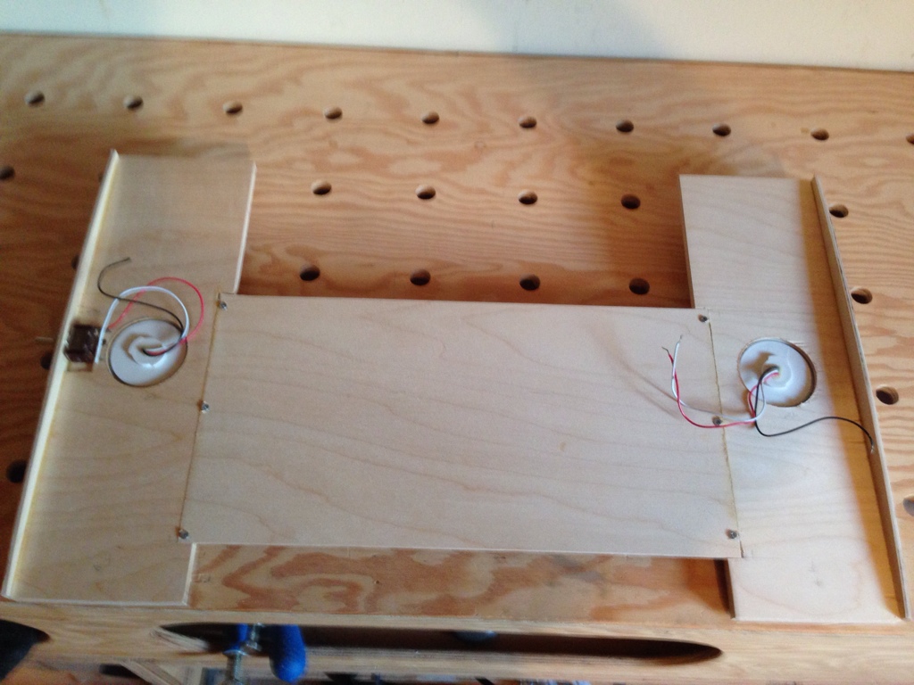

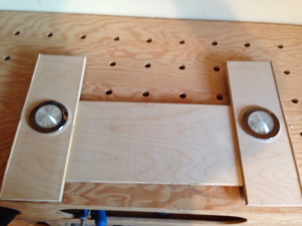

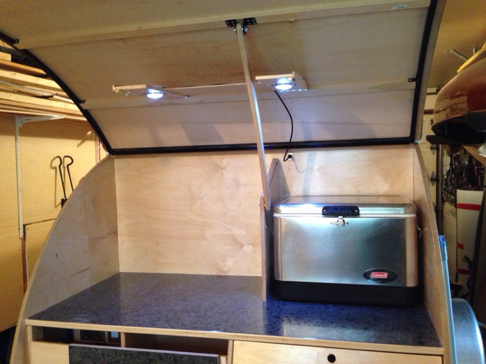

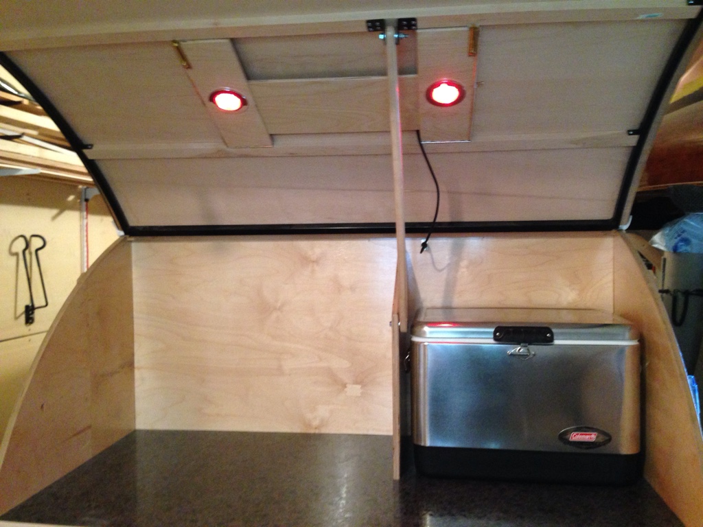

Today I got around to building the assembly that will hold the galley lighting in place on the underside of the hatch. I was all excited to get it mounted and then realized I didn't buy the hinges and hardware I needed to finish the job. Oh well... I will put it aside so I can put the clear coat on later this week then get it mounted next weekend.

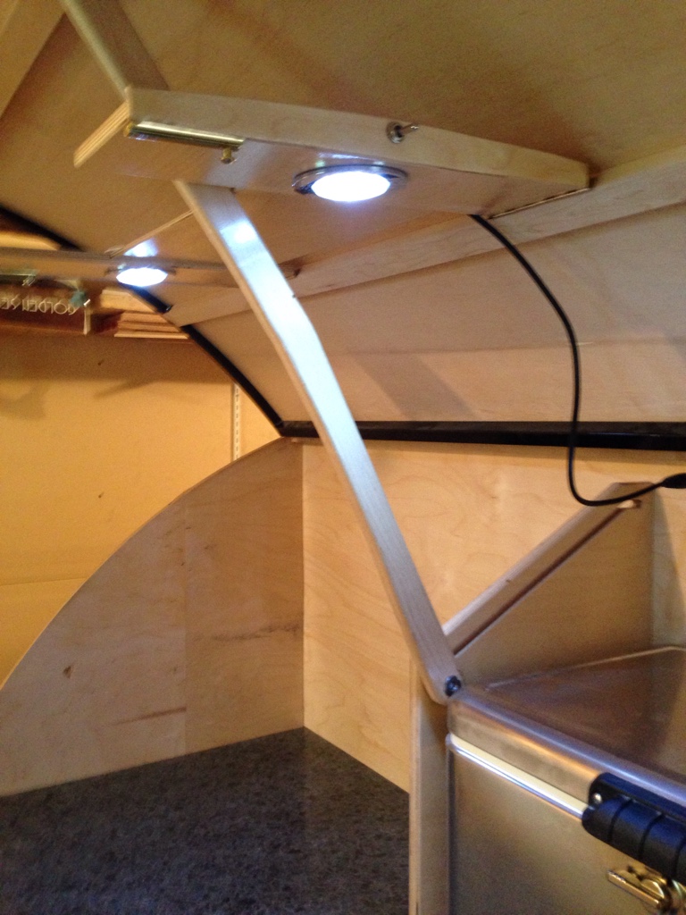

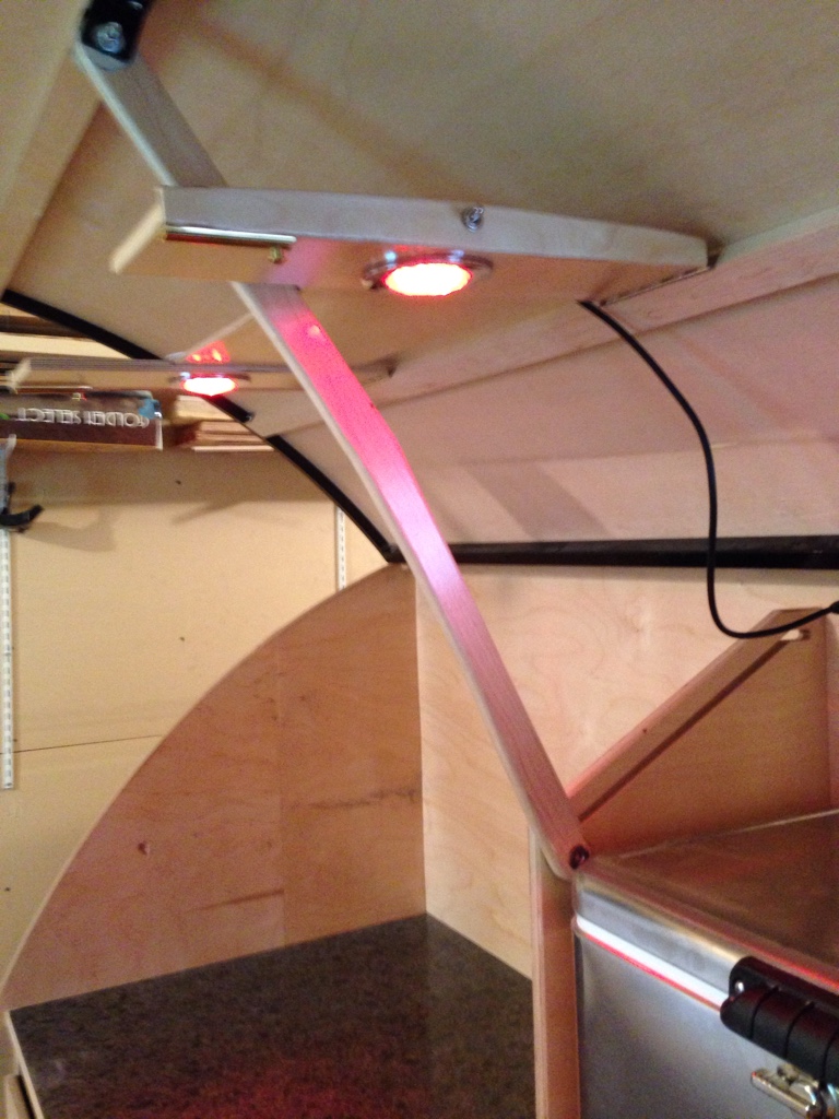

Postby inthewoods » Sun Sep 14, 2014 11:00 am

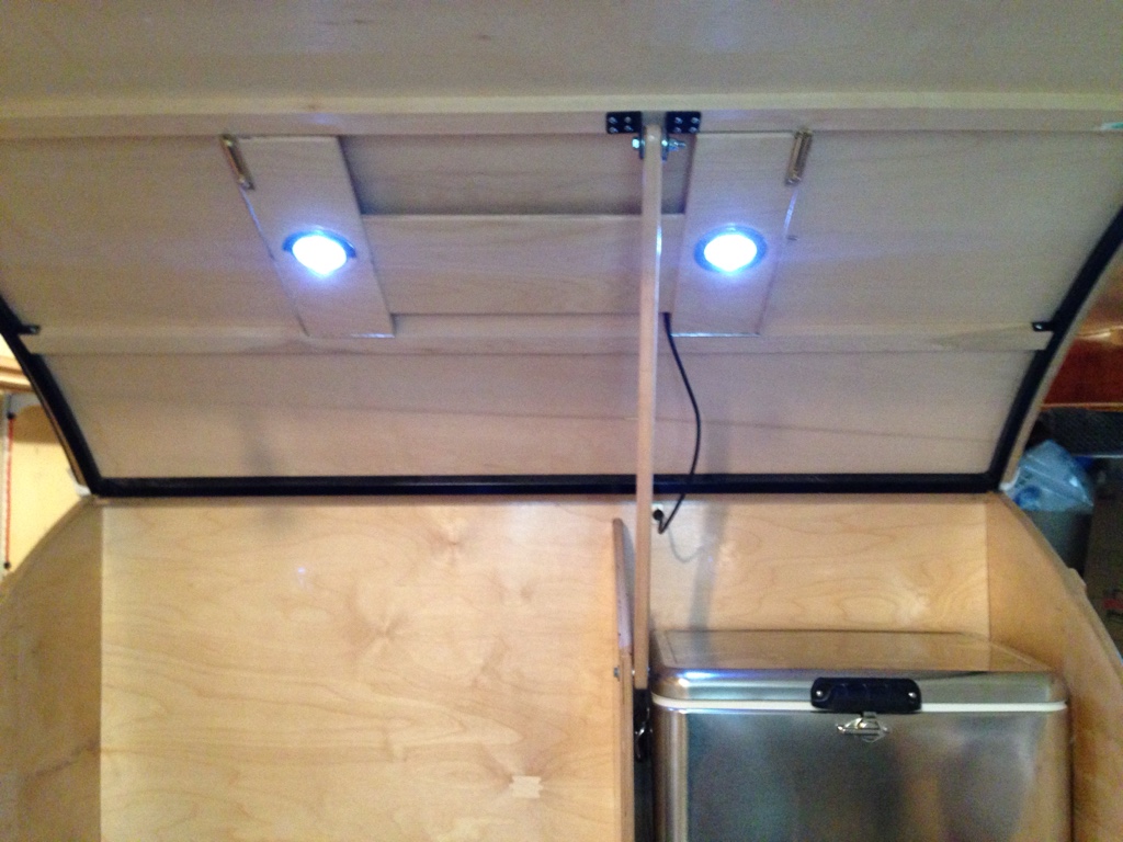

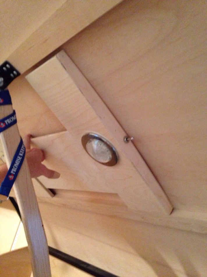

This weekend I found down time to complete the galley lights wiring and I mounted the assembly that holds the lights to the underside of the hatch.

Postby inthewoods » Sun Sep 14, 2014 11:02 am
And a few more photos...

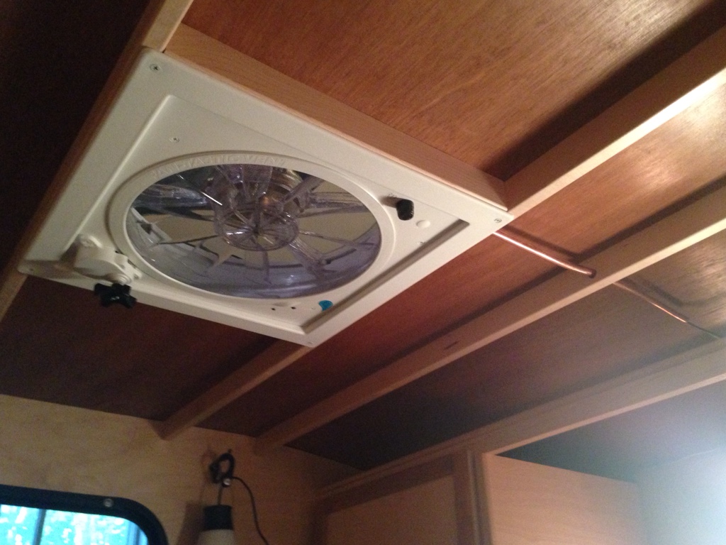

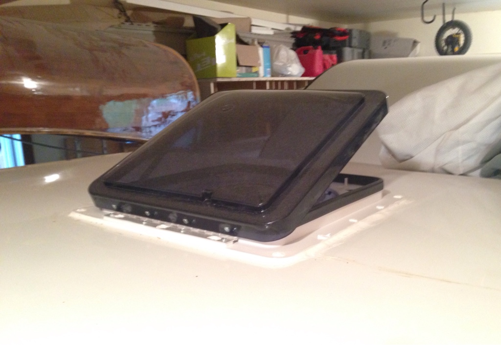

With parts in hand I first attacked the roof of the teardrop and installed the fantastic fan. The original owner of the teardrop had roughed in the framing of the roof to accept a roof vent so it was an easy installation. I didn't take any photos of the install because it was very straight forward according to the many post on this forum.. Here are photos post install....
The photo of the interior shows how I've hidden the DC power lines to the fan. I bought a piece of flexible copper plumbing pipe and carefully drilled out holes in the roof rafters. I slid the pipe through the rafters and then put the wiring through the pipe.
I'm happy with the results and the way the fan trimmed out nice on the inside.
