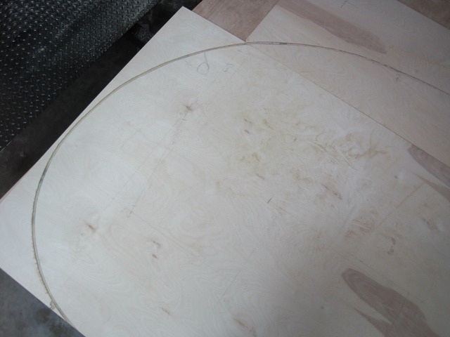

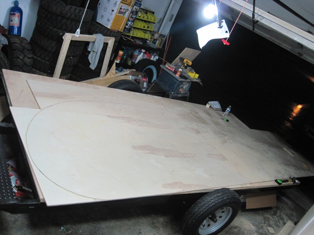

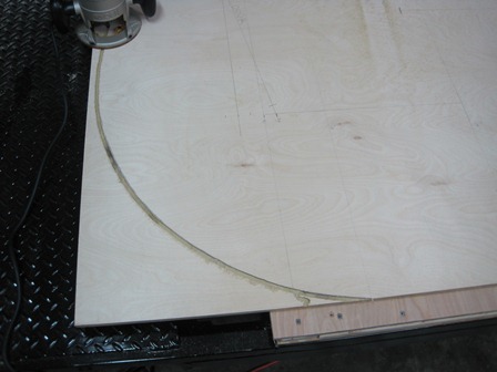

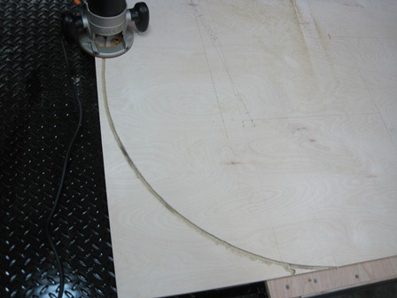

Ok, Finally made it back out to the garage, I still need to get some Biscuits to join the plywood together for the walls, should get them tonite. Last night I feel like I got a huge portion accomplished, even though it may not look like much. I routed the profile shape, which is a relief of my mind, as I was a little worried that I wouldnt achieve the shape I wanted, but I went slow and was very please, " the photos shown dont give a good view of the profile because of the angle the photos were taken." Goal for tonight is to make it to Home Depot, get the biscuits, join and glue the walls together. Goal for Saturday, Rout both walls and attached to trailer, get a good profile shape photo. Let me know if what you guys think of the photos.

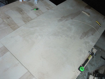

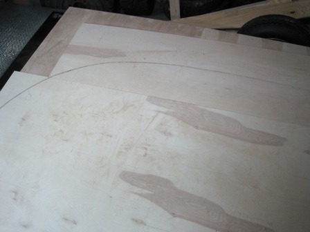

Postby BuildingForFun » Fri Aug 01, 2014 8:29 am
Getting closer....

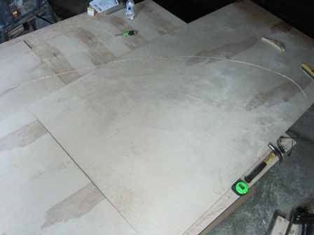

Re: 1st time build, A surprise for the Wife :)
Postby BuildingForFun » Fri Aug 01, 2014 8:30 am
Finished up...... :)

Postby KCStudly » Fri Aug 01, 2014 9:32 am
It looks like you free handed it? Pretty good job at that. :thumbsup:
I would have waited to cut the profile until after the panels had been joined; at least have them both joined and clamped together before you sand the final profile to match.
Postby BuildingForFun » Fri Aug 01, 2014 9:44 am
KCStudly wrote:It looks like you free handed it? Pretty good job at that. :thumbsup:
KC, That is still the plan, all I did was Rout about an 8th of an inch grove to get the profile cut, am waiting to Rout all the way through till they are all joined. And it all was free handed, kind of nerve racking for me.....just had to take my time and keep re-drawing till it looked right.

Postby KCStudly » Fri Aug 01, 2014 12:07 pm
Look for large truck repair facilities in your area. They usually have a big roll of white coated aluminum skin used to skin semi trailer vans. I want to say 102 inches x any length you want.
What I meant was it looked like you ran the router to your pencil line free hand without a template or guide bearing.

Postby BuildingForFun » Fri Aug 01, 2014 12:20 pm
That is a good idea and I will check into that, but I was going for the bare aluminum vintage look..... so im not sure if the semi trailer metal would work with it being white.
Yes it was cut with out a template or guide bearing by free handing it.
