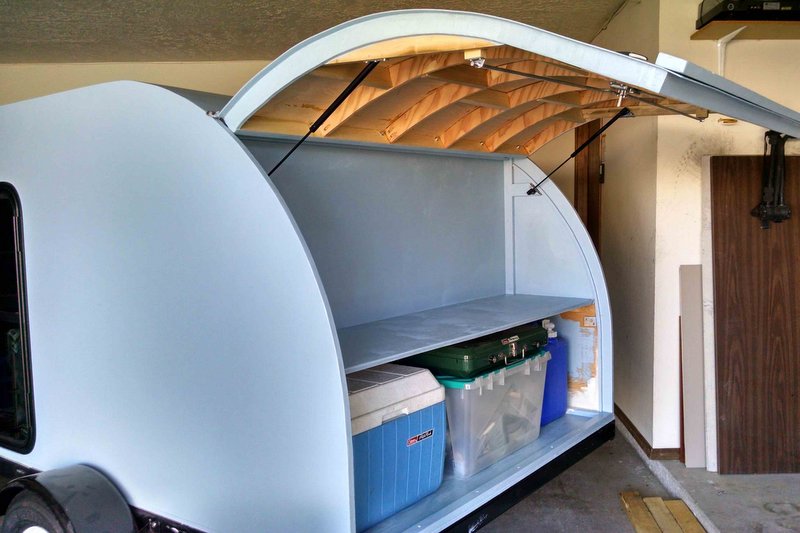

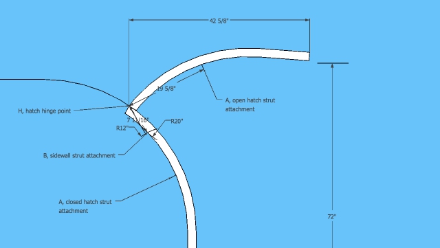

I had to perform some detailed calculations to install the gas strut brackets and braces on the hatch today.
I weighed and measured the hatch. According to online sources, a strut should be about half the length of the hatch. Using statics, I calculated two 20 inch long, 50 to 60 pound struts would be needed. I bought two 20 inch, 60 pound struts and brackets from Albuquerque's Central Trailer Supply.
After observing my Subaru wagon's struts, I used Sketchup Make to check strut layouts and locate best mounting points. The diagram shows how I determined the best mounting points.
My struts were 20" long extended, and 11-3/4" compressed all the way.
Point A was almost 20" from hinge point and three inches inside hatch skin.
With hatch up, I measured an arc with 20" radius from point A.
With hatch down, I measured a second arc from point A with 12-1/4" radius so strut was almost but not fully compressed.
Where the two arcs intersected is where to locate point B, second strut point.

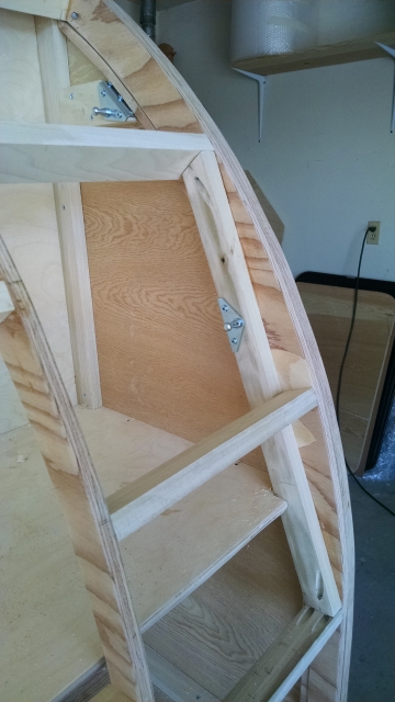

On each side of the hatch, I installed strut brackets and 1x2 poplar braces for extra strength. Next, my wife held up the hatch and I struck the first arc, closed the hatch and struck the second arc. Point B was where the two arcs met. I installed a second set of braces and brackets on the side wall interiors.
I will install gas struts after the hatch hinge is installed.

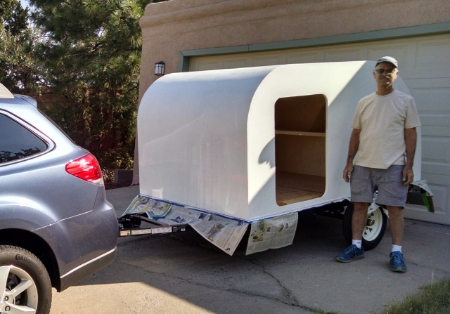

Re: Albuquerque teardrop - primer done, ready for color
Postby ChasCABQ » Sat Aug 22, 2015 2:34 pm
I finished two coats of exterior latex primer. Teardrop is sanded and ready for color now. Then I'll do the interior with zero VOC paint. I keep reminding myself "it's only painted plywood".

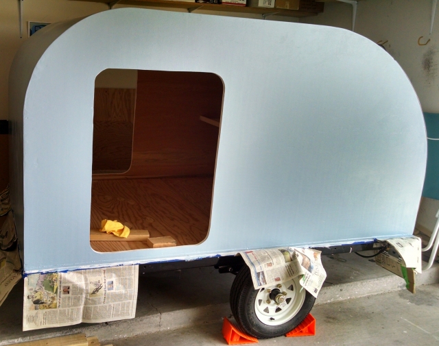

Re: Albuquerque teardrop - top coat done
Postby ChasCABQ » Sat Sep 05, 2015 2:28 pm
Okay, after some delays I did the top coat (third coat of paint so far). After waiting a bit I went back around and touched up areas as needed. I used high gloss exterior enamel paint applied with a 4" wide mohair roller. Next I'll paint the inside surfaces: galley and hatch will get the exterior paint and the sleeper with interior zero VOC paint. Ignoring the flaws in the marine plywood sides it looks pretty good... at 20 feet ;)

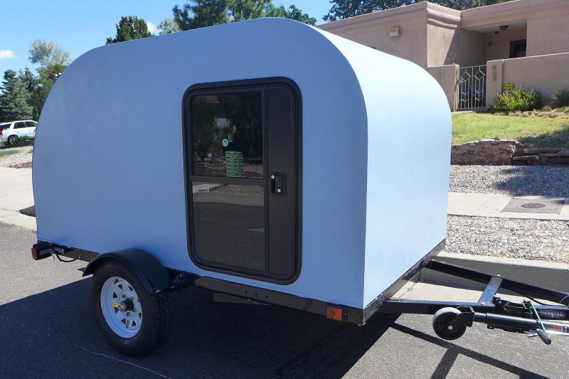

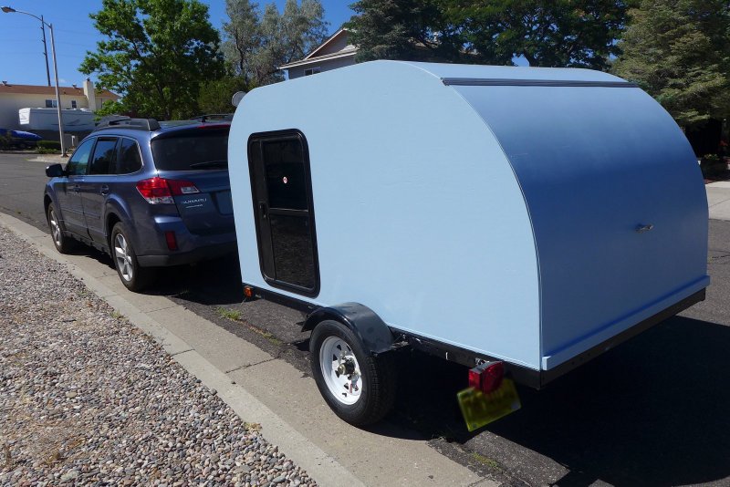

Finally finished and ready for camping!
Postby ChasCABQ » Sun Jul 03, 2016 2:45 pm
FINALLY I got her done after many moons of procrastination! Last year I was wondering how I would be able to go camping and perform dialysis in the field. No longer an issue as I received a kidney transplant in January. So I finished up and installed doors, fenders, and put on highway rated wheels. I have some cleanup, screw tightening and touch up paint but those are all minor things.
One thing: my strut calculations were off somehow. The 60# is fine but length or placement is off. I have headroom standing next to galley but far end is low and will be a head knocker I'm afraid. I'll review it and maybe make a change after my first camping trip week of July 11, 2016.
