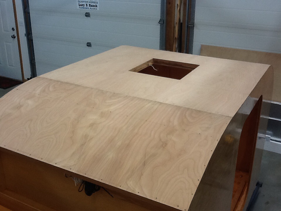

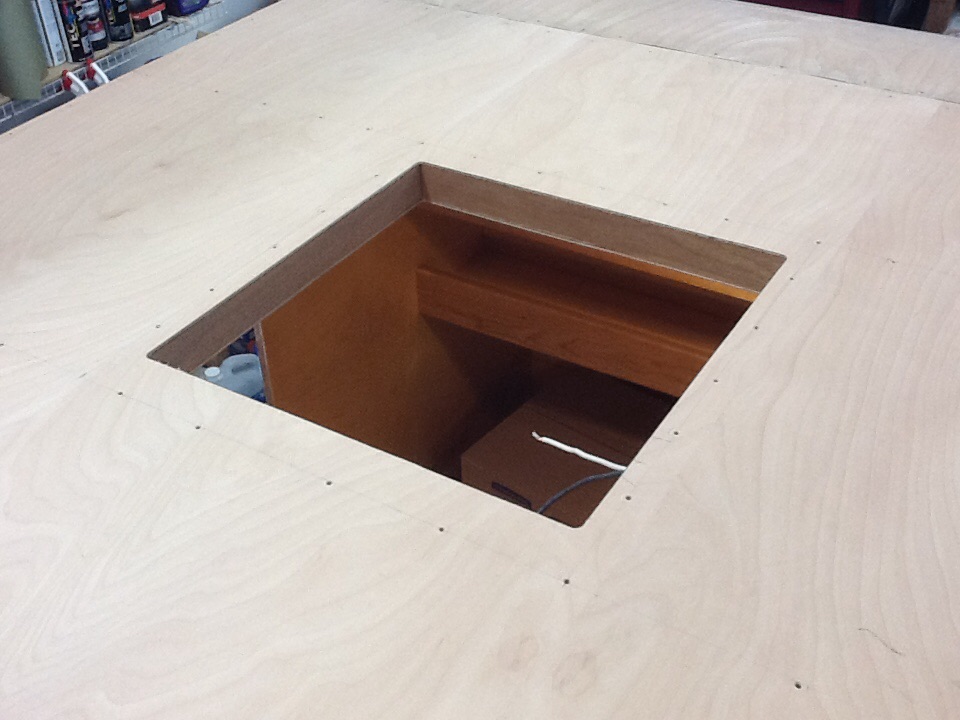

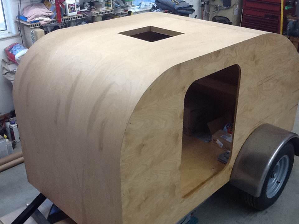

Postby ratrod71 » Wed Sep 09, 2015 10:00 pm
Removed the temporary screws from the roofs 1/8" plywood. Then took a router and trimmed all the edges and opened up the roof vent hole.

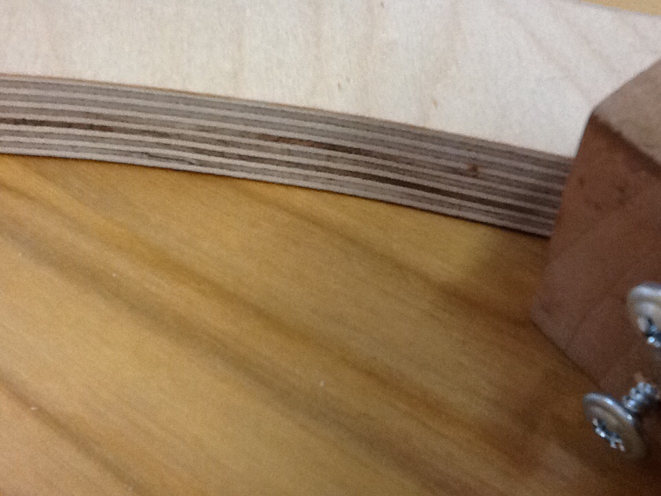

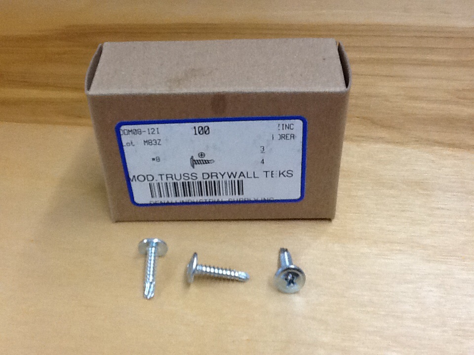

Postby ratrod71 » Sat Sep 12, 2015 1:18 pm
Just wanted to post a helpful tidbit photo of the screws I used to fasten down the 1/8" plywood on the top while the adhesive was curing. The self drilling feature and large head desgn worked very well. I bought them at a local industrial supply store here in Fairbanks. Happy building, Bryan

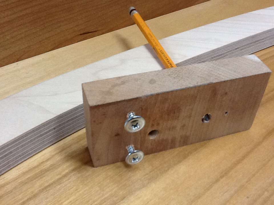

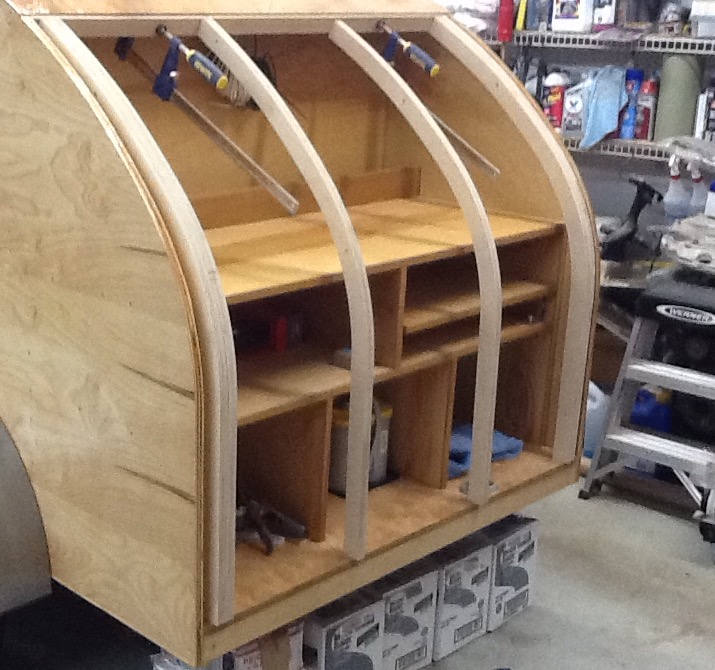

Postby ratrod71 » Sun Sep 13, 2015 8:41 pm
Finished coating the roof with "West System" epoxy. That completes applying epoxy to all the exterior surfaces. Next item on the agenda is the dreaded hatch. With fear and loathing I began. I made the first rib which will be the Master Rib. My intentions are to rough cut all the others and router them to the Master. I chose to use "Apple Ply" for the ribs which is a brand of hardwood plywood that has 15 plys. The kind owner of Superior Hardwoods here in Fairbanks made me a deal on it I couldn't refuse. I am hoping to reduce springback by using this type of plywood. I stole the idea for the scribe tool from this website. Thanks to whoever first put forward the idea. Happy building, Bryan

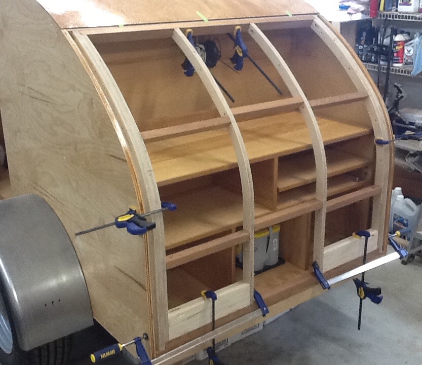

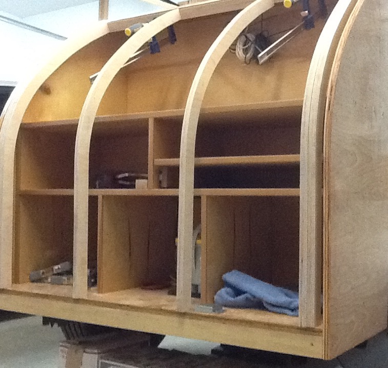

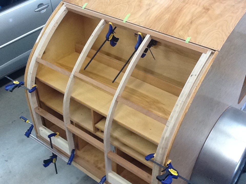

Postby ratrod71 » Sun Sep 20, 2015 8:53 pm
Got all the hatch ribs identical and ready to start putting them into place. Pictures show them just in a mocked up position to make some final calculations.

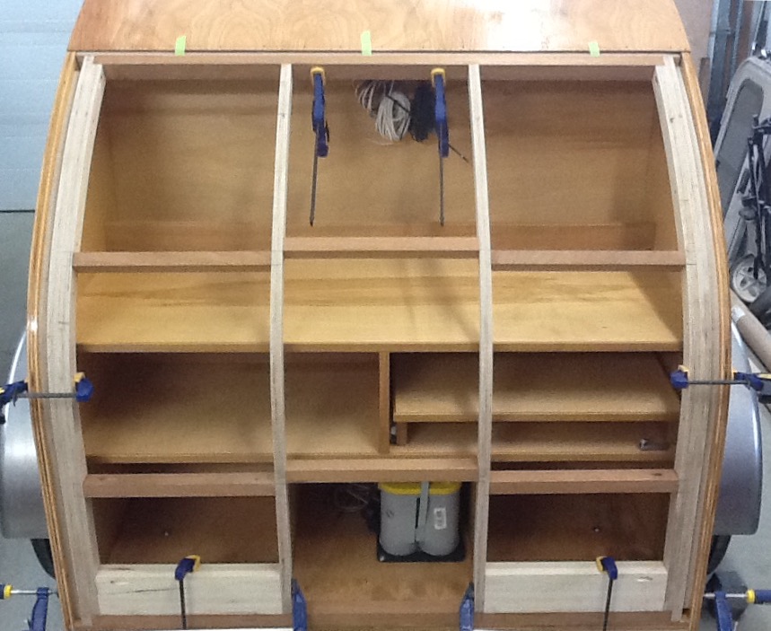

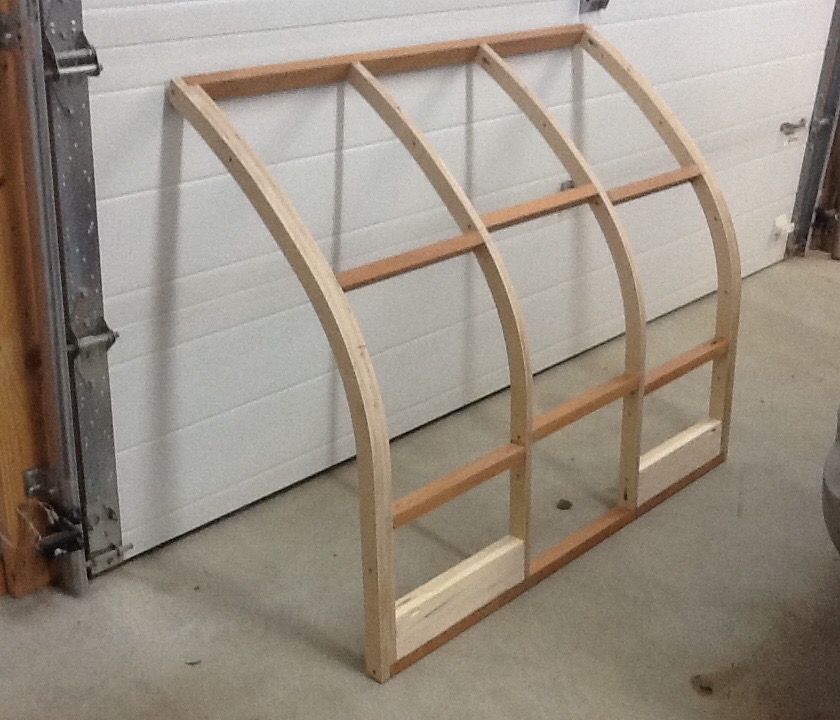

Postby ratrod71 » Sat Sep 26, 2015 4:51 pm
I have a hatch! Finished the framework for the hatch and so far so good. Major milestone for me. This was an area I was dreading. But slow and steady payed off. I am going to let the TiteBond III dry overnight then unclamp it to see what I have. Materials are... ribs made from 15 ply hardwood "Appleply", spars are mahogany, and the corner gussets where the latches will be mounted are poplar.

Re: Alaskan Benroy
Postby dales133 » Sat Sep 26, 2015 5:30 pm
Nice one
Not half as bad as you think is it
How are you skinning it and finishing it off?
dales133
Posts: 4605
Re: Alaskan Benroy
Postby ratrod71 » Sat Sep 26, 2015 7:13 pm
dales133 wrote:Nice one
I think I dwelled on it about 50 times more than it took to build. Kinda fun building it in retrospect. I plan on skinning it on the inside and outside with 1/8" birch plywood. Then .040 aluminum on the outside. Two slam type latches, and offset "T" molding. Inside will be Spar Urethane Varnish on the birch plywood.
