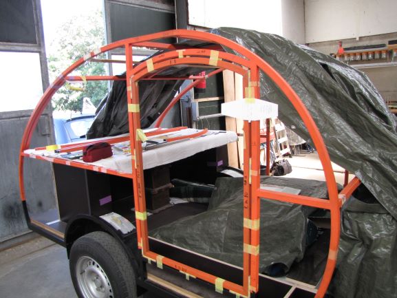

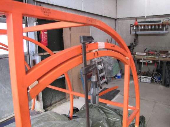

So it took some mental adjustment for me to go from metal to wood.
First of all i was not really impressed by the quality of my sawcuts using the circular saw. Even using a guidingslide. Yes 1 side (the underside ) of the sawcut of the plank looks great.
But the upside of the sawcut not that good enough. It is just the nature of a circular saw, and yes i had taped every sawline before sawing.
So i went on using a router for all the parts who are in the line of sight.
You can work very precise with a router but it takes some sweet time doing the math leveling the router guides. U can make a mistake easily.
And considdering that some planks needed up to 9 differend cuts so far, you didn't want to make to much mistakes.
Keep in mind that i want to build this part of the teardrop somewhat like a kind of Lego system. And also that the complete floor must be removable.
By that i mean that i want to have the possibility to demount all the loose parts easily when nessesary by just some screws or bolts.
It takes some creativity at times to design al kinds and placing of mountingbrackets.
But after all i am pretty pleased by the result so far.

Postby smeerkees » Tue Mar 10, 2020 6:05 pm

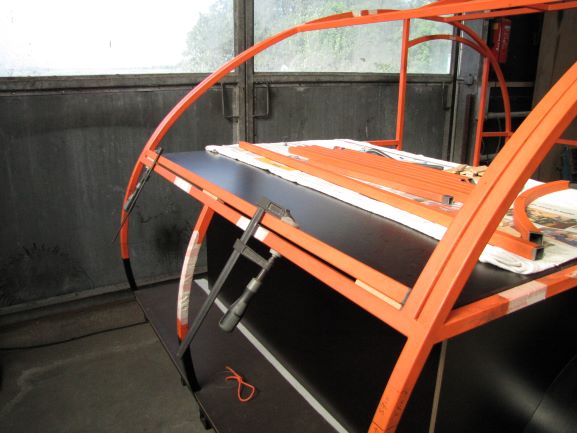

I want to route some slots into the top of the horizontal planks to hold the inner walls, and than make some lids with piano hinges for some holdingspace.
On the last foto u can see that i can mount the outerwall directly on the frameribs.
Meanwhile i am sawing al kinds of mounting brackets. Some have to be pretty precise using a mitersaw, and others just with an angle grinder.
I will tig weld them on the existing ribs.
So you know what i am busy with, coming time.
Greetz, SmeerKees.

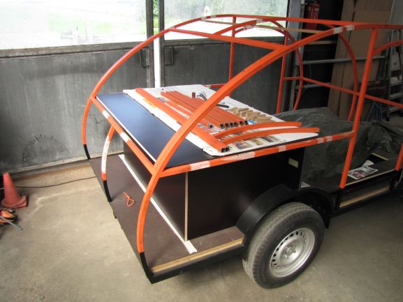

Last winter i have been busy with some woodwork.
Here the basics for the inside deviding walls.

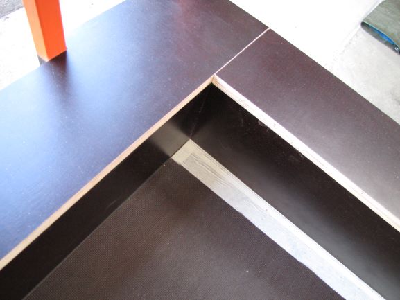

Re: Meanwhile in the Netherlands,...

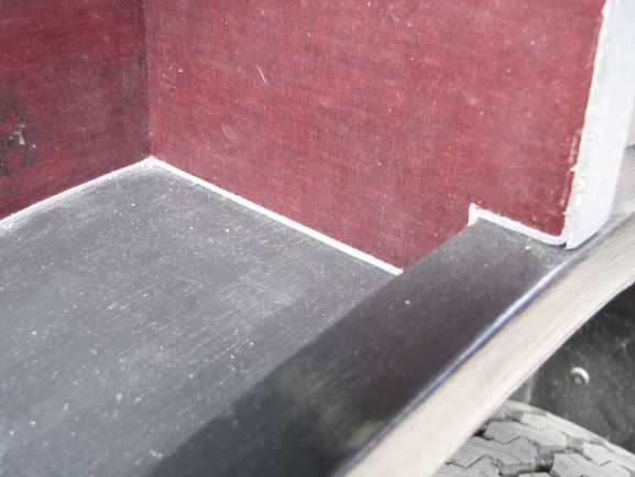

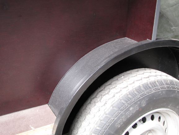

Postby smeerkees » Thu Aug 05, 2021 11:26 am

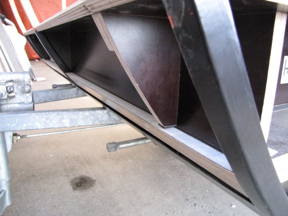

As you can see i have added a 2 mm. thick piece of neopreen on the vertical, and horizontal pieces on the floor. Mainly for eliminating rattle's and squeeks.
The horizontal (counter) plate will be fixed to the steel beams with brackets and screws.

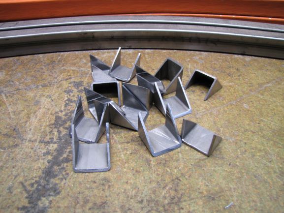

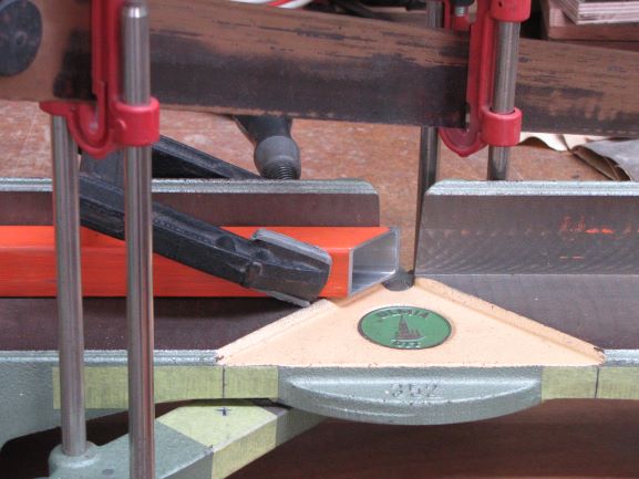

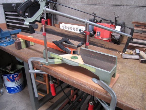

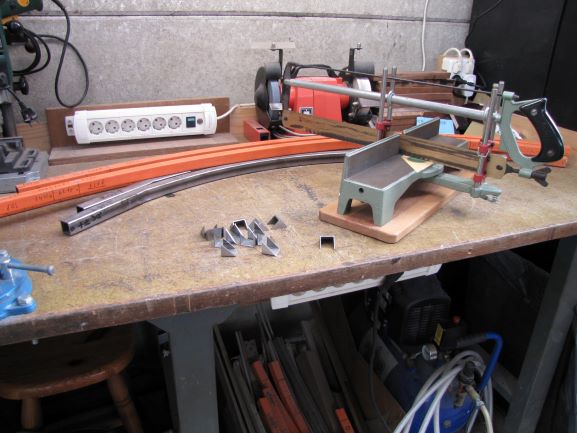

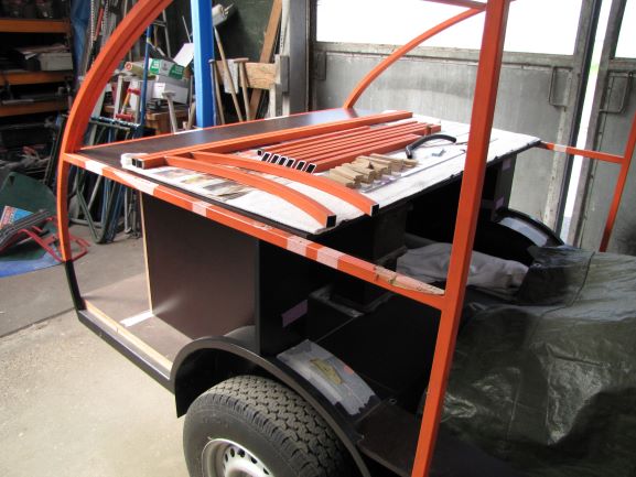

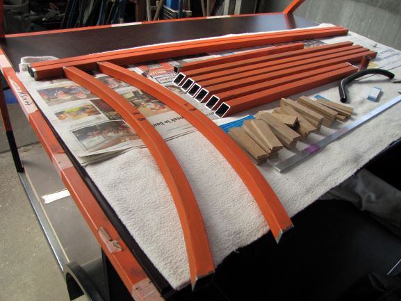

Postby smeerkees » Thu Aug 05, 2021 11:45 am
And now for the fun stuff. (miter)sawing the metal for the doors and hatch.
IMG_2112 verkleind voor tnttt.JPG (50.47 KiB) Viewed 1653 times
IMG_2118 verkleind voor tnttt.JPG (55.3 KiB) Viewed 1653 times
Postby smeerkees » Thu Aug 05, 2021 11:58 am
I had to make a lot of spacers for fitting the doors and hatch. Remember, the doorskin will be wrapped around the sides of the doors, and hatch. And i want to mitersaw each part in a 45 degree angle for welding. The initial tack welds will be done in the actual doorjams using the spacers and clamps.
IMG_2128 verkleind voor tnttt.JPG (46.69 KiB) Viewed 1648 times
IMG_2138 verkleind voor tnttt.JPG (47.68 KiB) Viewed 1648 times

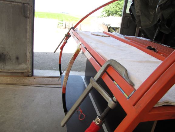

Postby smeerkees » Thu Aug 05, 2021 12:22 pm

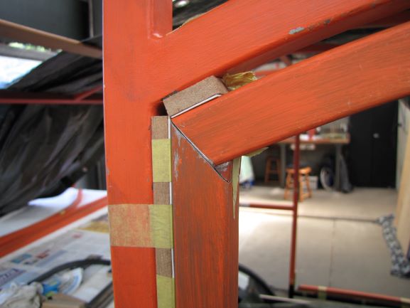

As you can see the vertical beams of the hatch must be cut very precise especially because the back form of the teardroptrailer is not round but partially elyptoid.
when you cut more than about 2 mm. in the wrong place the form of the hatch will not be on the same place of the silhouette of the teardroptrailer.
This plus the space for the wrap around skin, plus the mitersaw angles of the squares of the hatch....
But first i need the hinge to use for the hatch. Because it can influence the hight of the hatch.
After that the water seal system.
Now u understand why i think this part of the build is the most difficult, and time consuming. Especially while building with steel.
Oh ja and when welding the curved pieces, try to use as less heat as possible. the bended pieces of steel want to lose their form caused by heat.
When you think about it there is a lot of inner tension (stress) in the bended steel pieces.

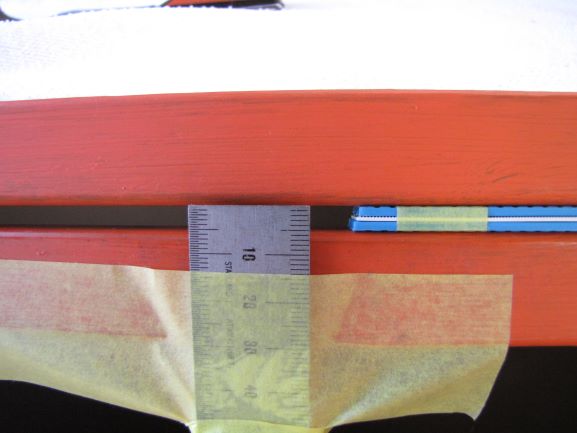

Postby smeerkees » Thu Aug 05, 2021 12:33 pm
AND NOW FOR US NERDS!

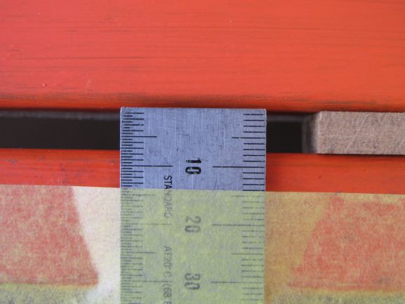

The hatch gap spaced with just the frame. Is about 8.5 mm
IMG_2131 verkleind voor tnttt.JPG (43.27 KiB) Viewed 1649 times
IMG_2148 verkleind voor tnttt.JPG (32 KiB) Viewed 1649 times
smeerkees
Posts: 111
Joined: Thu Feb 26, 2015 6:03 pm
Location: Netherlands
Postby smeerkees » Thu Aug 05, 2021 12:45 pm
And this would be the theoretical endgap of the hatch with the doorskin wraparound. This would be around 5 mm.
I measured the door and hatch gap(s) of my car (a fiat 500 eurospecs) the doorgaps were about 3 mm on the front and back.
The hatchgaps were about 4 mm on the sides and underside.
(Have you ever thought about the size of your cardoorgaps?).......me neither. :o
