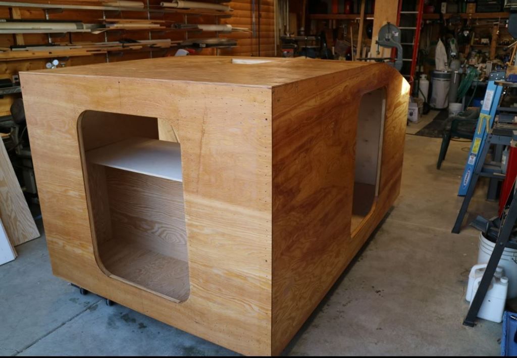

My CPES came today the body will get 2 coats with more time spent on the edges.

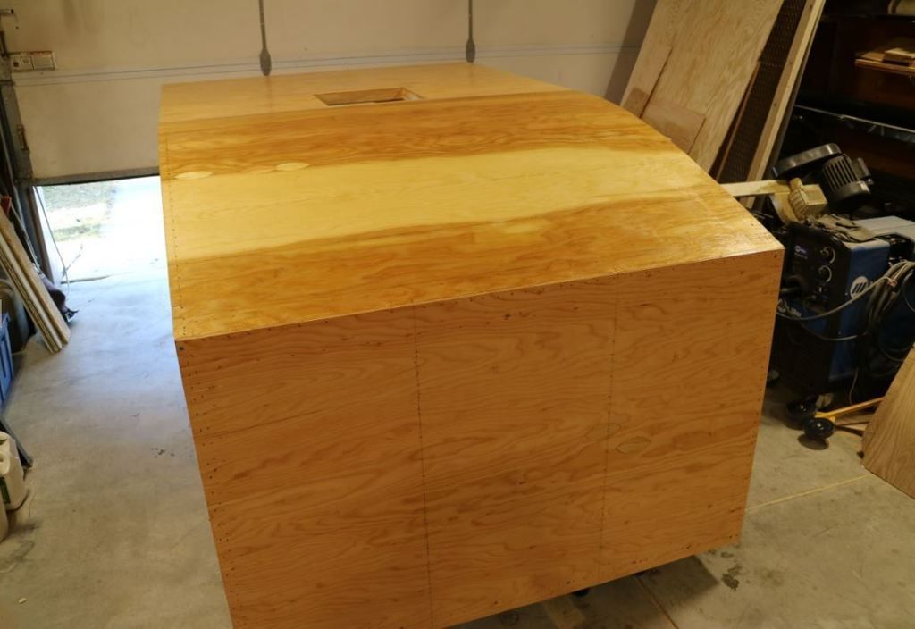

Postby tawright915 » Thu Mar 03, 2016 3:23 pm
jkidd6339 wrote:Yes Baltic Birch
Curious, what was the thickness and how did you attach it?

Re: Overland Trailer build Jkidd6339
Postby jkidd6339 » Thu Mar 03, 2016 11:00 pm
6mm about 1/4" on the ceiling glue and just enough staples till the glue sets. The walls will be glued and pin nails to hold it in place while it sets.

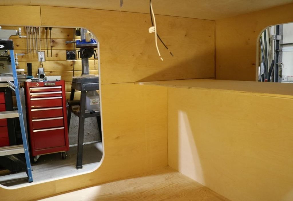

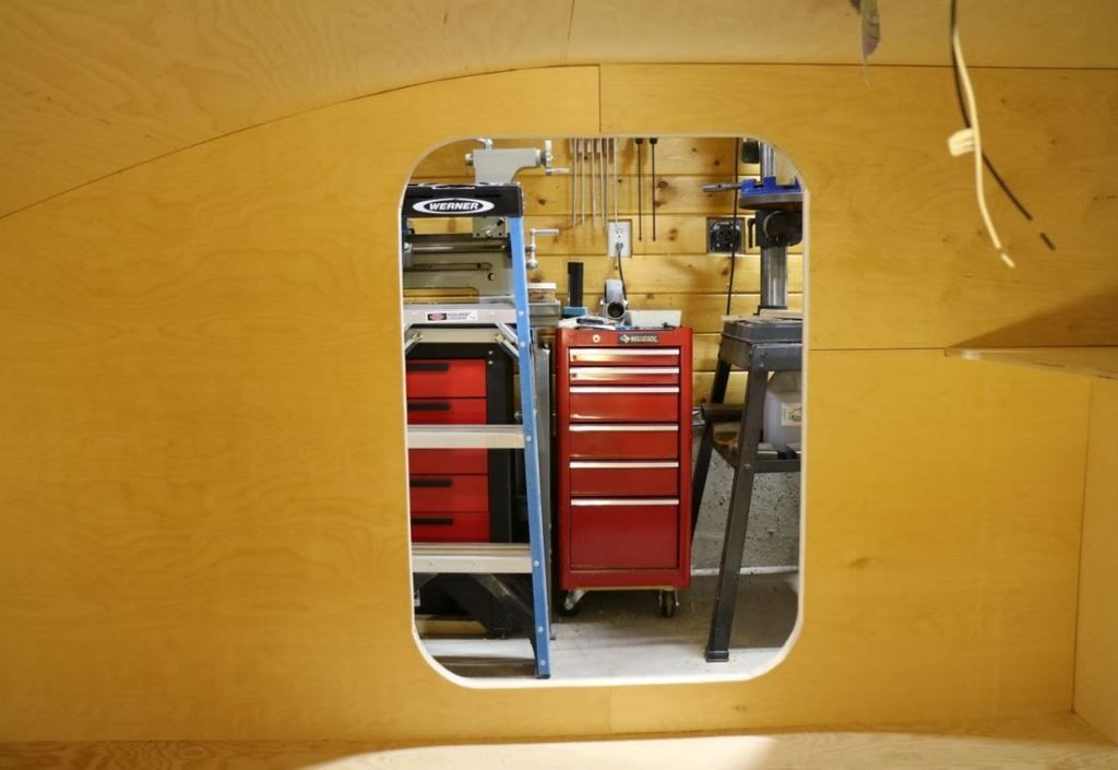

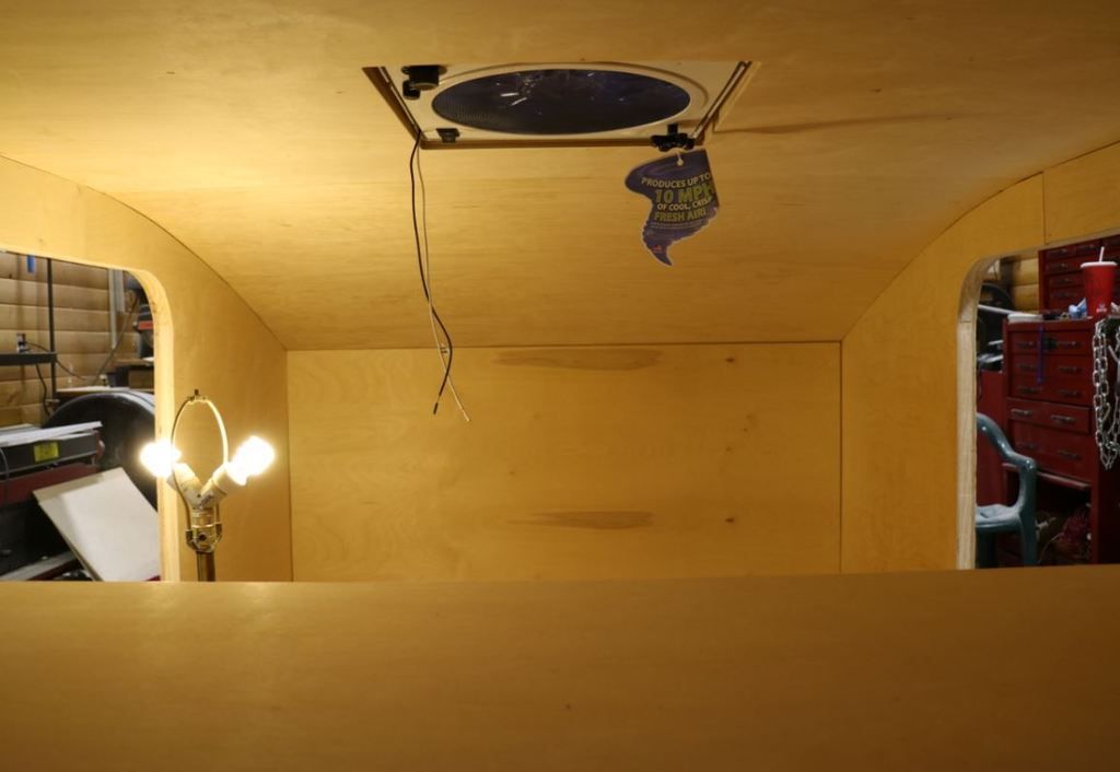

Postby jkidd6339 » Mon Mar 07, 2016 8:59 am
The insulation is in and the inside walls are up. I will do the trim a little later.
Postby StPatron » Mon Mar 07, 2016 10:13 am
Lot of progress. Congratulations! This is a faaaaast build.
Postby lfhoward » Mon Mar 07, 2016 10:42 am
The interior is looking fantastic. Nice work! 8)

Postby jkidd6339 » Sat Mar 12, 2016 11:37 pm
Three coats penetrating epoxy.

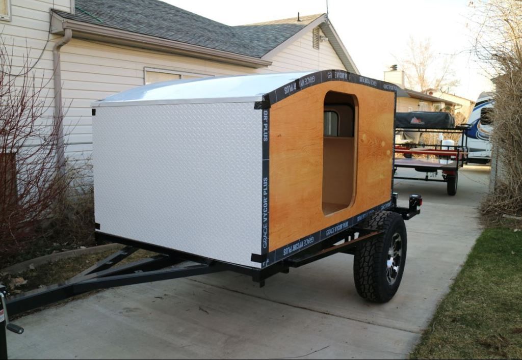

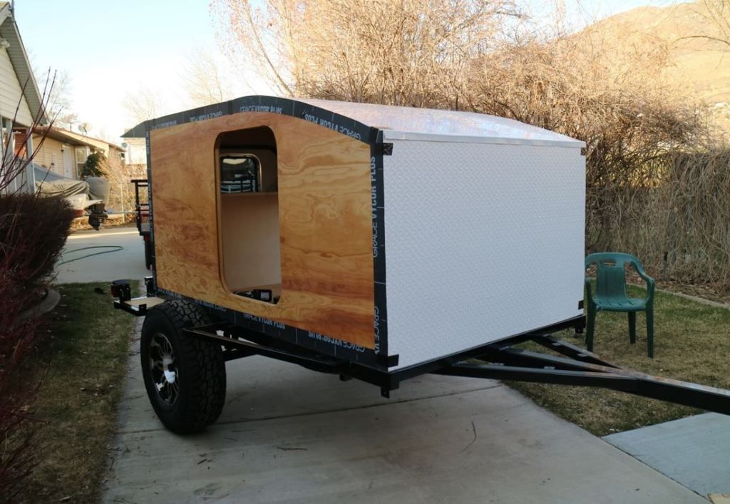

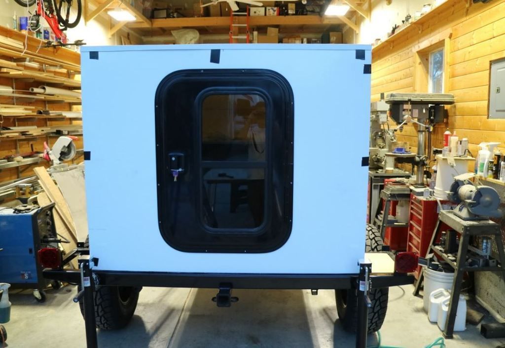

Postby jkidd6339 » Sat Mar 19, 2016 11:33 pm
Got a little more work done today.
Postby lfhoward » Sun Mar 20, 2016 7:56 am
The aluminum looks great! What sheet thickness did you use? I have 0.04 aluminum on my build and it is too thick to bend in a roofing brake. How did you go about bending the roof over the front and rear walls?
