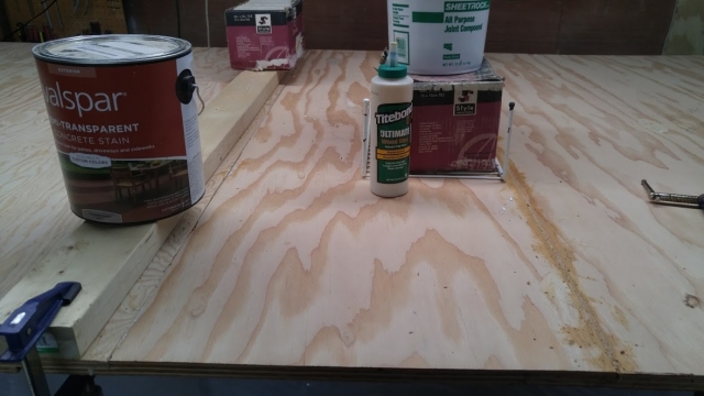

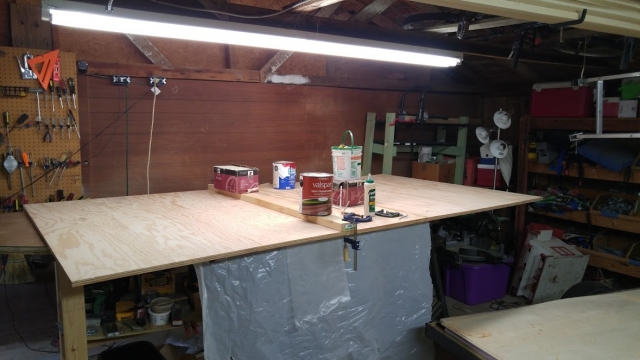

Postby plectrudis » Sat Jun 04, 2016 7:57 pm
Thanks for asking, Nobes! I've had some family stuff going on that took me away from the project for a few weeks, but last weekend I was able to start back up again. I spent most of last Saturday routing out the 3.5" lips on the plywood for the bottom of my floor--the subfloor, I guess.

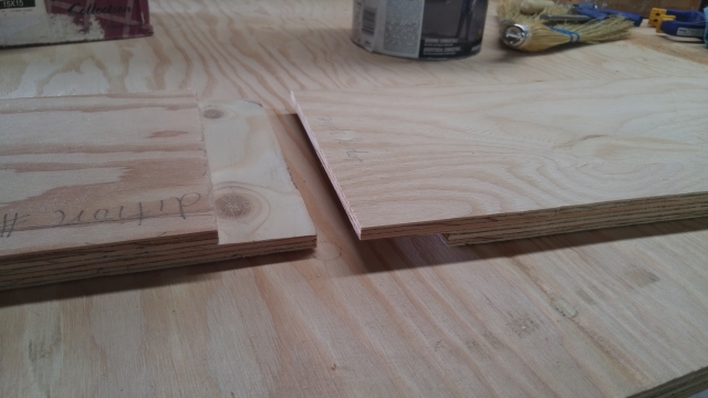

I'm doing an insulated floor with 3/4" plywood on the bottom, and it has to be 5' x 10.5', which means that I had to join three pieces of plywood. This was a real pain, and I now fully appreciate why some people opt for a 4'-wide teardrop. I still think that would be too cramped for my comfort, but I completely grasp the appeal now.
It surprised me how long this took, but the router and I had some little failures to communicate. It got hot, and the bits kept slipping up into the body or slipping out, with hideous results (to the wood, not to my person). At other times, the bit would be so tightly wedged into the collet that I had a b$tch of a time getting out--in fact, I had to tap assertively it with a hammer and screwdriver and use pliers.
I think the main issues were:
(1) I didn't give it enough down time. After every 2-1/2 feet, I need to stop, check the depth of the bit, and check how warm the body is.
(2) I was making my initial pass in the middle of the wood (using my router's edge guide), rather than starting from the outside edge in, which meant the bit had less air flow to cool itself off.
(3) I was using 1/4" bit to clear a 3-1/2" swathe of wood on each section--I probably should have used a larger bit.
(4) The router is old and a little crotchety.
After a frustrating afternoon, my favorite bit broke, and I called it a night.
:disappointed:
There wasn't actually that much wood left to clear after that, and I went after it--gently--this morning, with a 1/2" bit and lots of pauses to check the bit depth. No major problems, and I got the joins glued and nailed with a minimum of drama. Sometimes the lumber gods are with you, and sometimes they're not.
:phew:
Join curing per Tony's excellent advice: (http://www.tnttt.com/viewtopic.php?f=21&t=63635#p1134192)
I don't know how in the heck it can take a day and a half to assemble the bottom piece of a floor, but evidently this is my pace. Since I don't have a deadline, I guess I'll just embrace it. Mr P--either out of husbandly supportiveness or else because his initial expectations were just that low--keeps telling me that he's amazed at how fast I'm moving. Which is consoling.
Next steps: I have a few remaining crevasses to fill with wood filler on the subfloor (I ran out of Titebond3--need to buy the mongo-size jug next time). Then, once the joins are set, I'll lay the subfloor on top of the trailer tap it with a mallet to mark each trailer bolt, then use a spade bit to gouge out a little cavity in the subfloor for each bolt. Got the idea from this guy (http://www.instructables.com/id/Teardrop-Trailer/step7/Day-7-February-15th-2012/).
Then on to the Henry's (HD only had the 201, so I'll be using that rather than the 107), and then I'll assemble the floor frame and insulation.
Ta-da. It's... a large piece of plywood. A little anti-climactic. But it appears to be more or less rectangular and more or less flat, so I'm going to call this one a win.

Re: Little Ferdie - 11-ft Grumman: FIXING GOOFS, PLUS MATH
Postby plectrudis » Tue Jun 14, 2016 11:22 pm

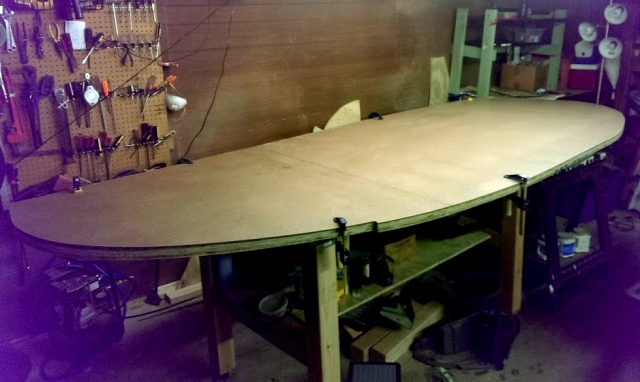

I spent all of Sat and half of Sun in the garage, which, in our current heat index, verges on the heroic. If sweating purges the body of toxins, mine is now a temple of purity.

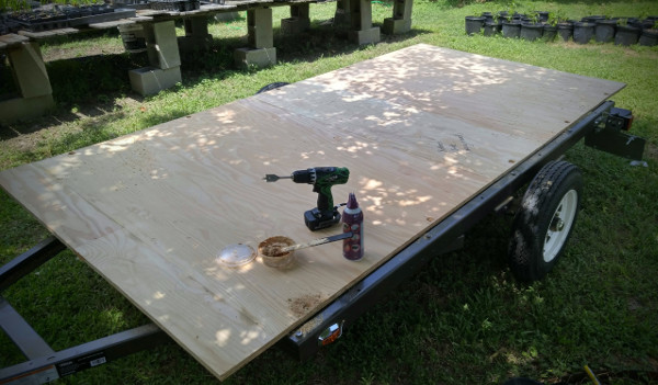

Annoyingly, though, most of that time was spent fixing goof-ups. My beautifully stretched plywood subfloor? 6-1/5" inches too short! How can this be? I measured THRICE before cutting once!
But all the careful measuring in the world won't help if the underlying math is wrong. I forgot to account for the overlap at the joint when calculating how much length I needed. Oh, OUCH.
For a minute, I considered shaving off the extra length on the profile and just resigning myself to a shorter teardrop, but I eventually talked myself round to the path of righteousness. I spliced on a little extension to the deck, and, annoying as this whole exercise was, I will say that my joint are getting better--these were the tidiest I've accomplished so far. Look how crisp!
I applied some filler to any seams that weren't nicely flush and sanded anything rough or uneven, then a repaired a shelf that I hadn't installed correctly on my workbench (arg!), and that was about all I had time for.

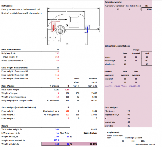

Soon I'll be ready to attach to the frame, but I'm being extra-careful about my math, which has taken most of the evening.
The tricky bit is that the box will be 22" longer than the metal trailer frame. Where do I put the overhang? All off the back end? All on the tongue? Split the difference half and half? Other?
So I fiddled with Andrew's trailer balancing spreadsheet to test different options.
It looks like half and half (11" hanging off the front and 11" hanging off of the back) will do me fine, assuming I did everything correctly.
If anyone has the time to take a glance at my numbers and see if everything looks legitimate, though, I'd be grateful.
Summary: I'm estimating about 1000-1100lb overall weight. I'll be adding an AC (63lb) in a box (40lb) on the tongue plus two batteries (60lb ea) and an ice chest (~90lb full) in the back. With a wheel center 52" from the back edge of the cabin, the spreadsheet estimates a tongue weight that is 12% of total weight, or 164 lbs.

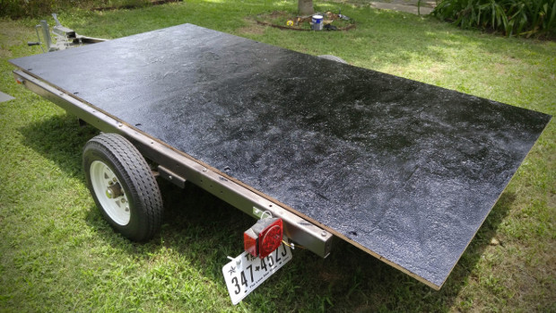

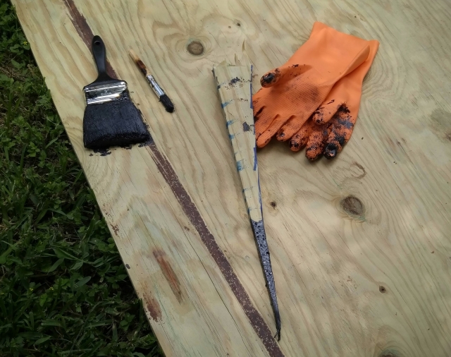

This weekend, I applied the roofing tar. There wasn't much to it--I sanded down the wood filler that I had used on any gaps in the seams. Then Mr P & I flipped it over and nudged the floor into its final location--11" sticking over the front, and 11" sticking over the back. (The little piece that I had to add on due to mathematical failure is over the tongue, so if it needs extra support I can always brace it on the tongue.) Then I used a hammer and a spare block of wood as a cushion to bang on the subfloor where it rested on the bolt heads sticking out of the trailer.
This worked well-ish, but this plywood (from Brazos Forest Products--shout-out to them) is quite hard, so not all of the banging produced very clear indentations. Fortunately, I also used a Sharpie to make a little line on the outside edge where the bolt head met the wood--this made the fainter indentations easier to spot.
Then I used a 1" spade bit to carve out some little bubbles for the bolt heads to fit in so the plywood will sit snugly on the trailer frame. This was the only surprising part of the day--I hadn't realized how deep the spiky part of the spade bit is. In order to make the bubbles deep enough, The spiky part ended up stabbing all the way through to the other side, making a little hole. I stoppered the holes with my homemade wood filler (sawdust + TB3), so I think it should be fine, but I would have rathered left the subfloor unpierced.
Finally, I smeared on the Henry's 201, using the cheapest brush I could fine at Home Depot. Someone here on the forum said that you won't be using the brush again, and they were right. I also bought some (again, super-cheap) skinny round brushes for mudging the Henry's into the little bolt head bubbles. Glad I did, as the big brush would have filled them with big puddles of solid tar, when all I wanted was a thin veneer. Because the Henry's is so thick, and because it's so important to get every spot covered, I ended up kind of mushing and massaging it with the brushes to make sure it went absolutely everywhere.
As many have noted, Henry's does stick to everything it touches. It's highly commitment prone. But I was forewarned, so I worked outside, wore rubber gloves and a grody old shirt, and I didn't have any problems. I also used a piece of scrap plywood as the stirring stick--again, thanks to the forum: one poster noted that standard paint stirring sticks just snap in the viscous glop that is Henry's.
It's now hardened and ready to be flipped, and then I can cut and fastened the floor frame.
