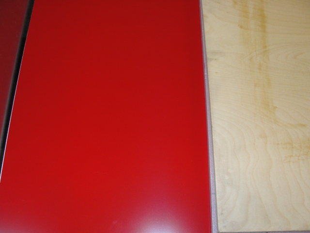

I ordered aluminum for skinning through a very helpful local aluminum cabinet manufacturer. He was able to get the .040 red that I wanted for the sides and galley lid. His suppliers didn't stock .040 mill finish, so I had to go with .060 for the roof. 2 @ 4' x 10' red, 1 @ 4' x 8' red, 1 @ 5' x 10' mill finish, and 1@ 4' x 8' mill finish came to $447 with tax. He tacked my order in with his order for a recent big job he's about to start.
Red!

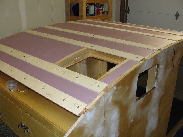

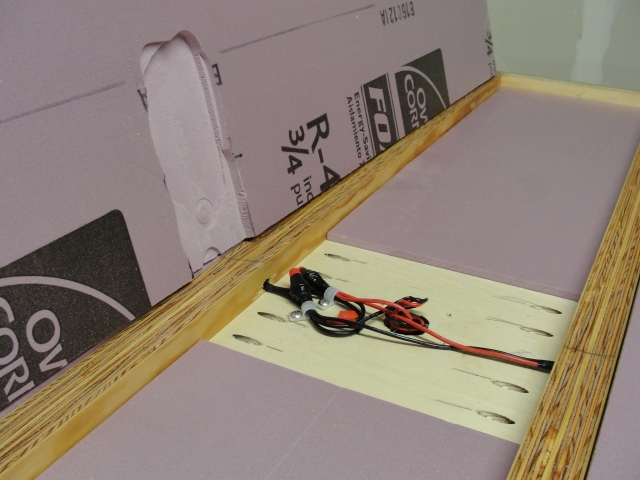

Postby Dusty Mark » Sun Jun 05, 2016 12:18 am

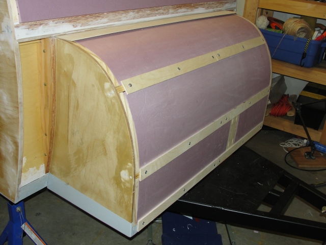

I'm making steady progress on the teardrop. The 1/8" plywood roof panels are fitted and sealed. Today I fitted and glued in the roof insulation. This took way longer than I expected, but it turned out well.

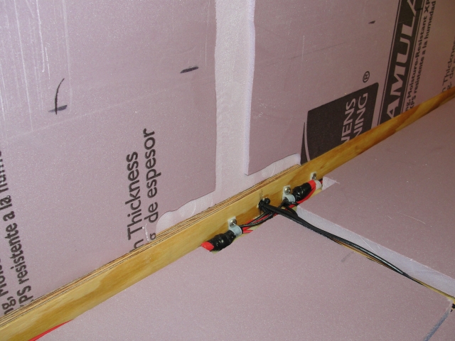

I insulated the front storage module first. Notice the vertical solid wood piece that will provide a solid mount for my LP gas regulator.

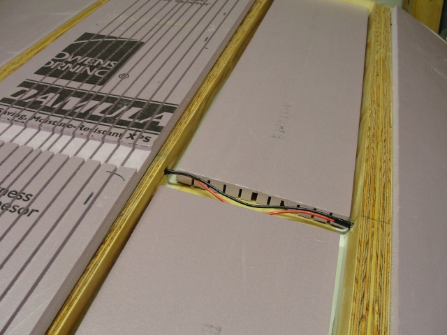

Deep relief kerfs allow the foam to bend around the roof curves. I routed channels for the wiring.
This is over the cabin dome light.
This is the porch light junction.
1/4" Baltic birch clamping boards screwed in with washer head screws provide enough pressure to hold the foam in position while the glue dries.
I'll even out the plywood roof edge and the solid wood spacers with a hand plane tomorrow and then staple and glue the roof in place. I also need to install foam in the space on either side of the front storage module. The plan is to apply the aluminum sides on Tuesday afternoon!

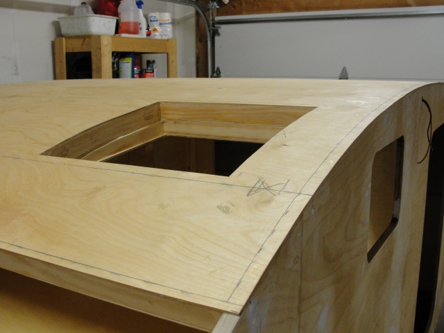

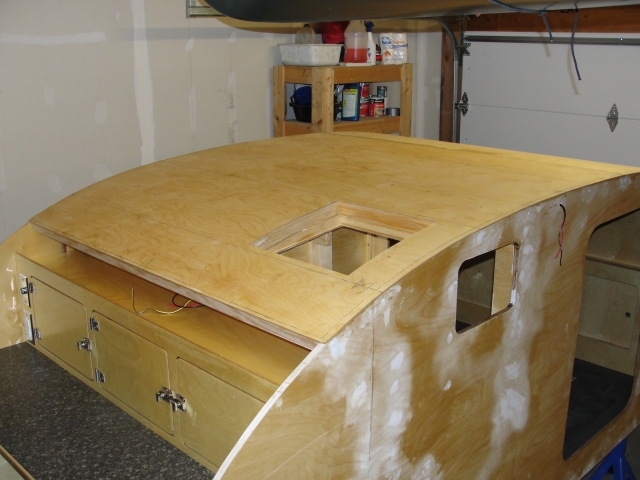

Roof Installed

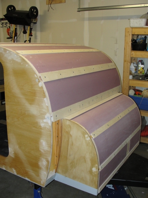

Postby Dusty Mark » Sun Jun 05, 2016 11:38 pm
Mary helped me install the roof tonight. I used polyurethane construction adhesive and 3/8" crown staples to hold it down.
It's looking more and more like a camper.
It was a pretty uneventful assembly since I drew lines for where the staples should run and also laid tape where they were supposed to avoid the wiring in the ceiling.
I smoothed the curve at the roofline with a hand plane before assembly and this helped give clean lines in the final assembly.
I'll flush the edge with a router tomorrow and apply some CPES to the end grain. We'll then be ready to fit the aluminum skin for the sides!
