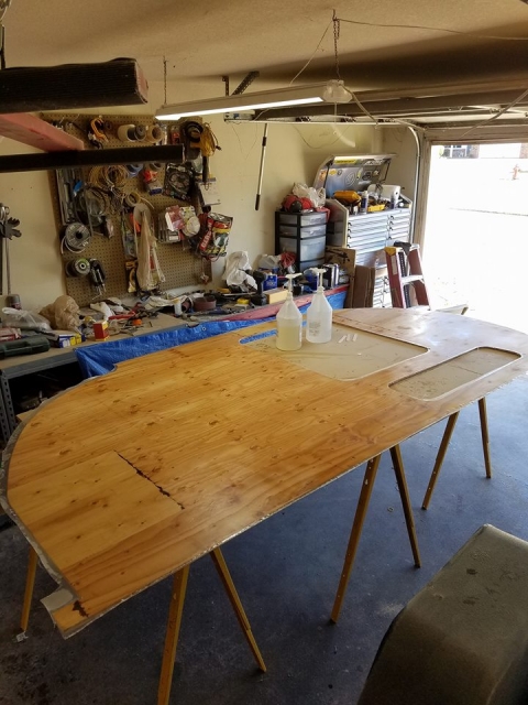

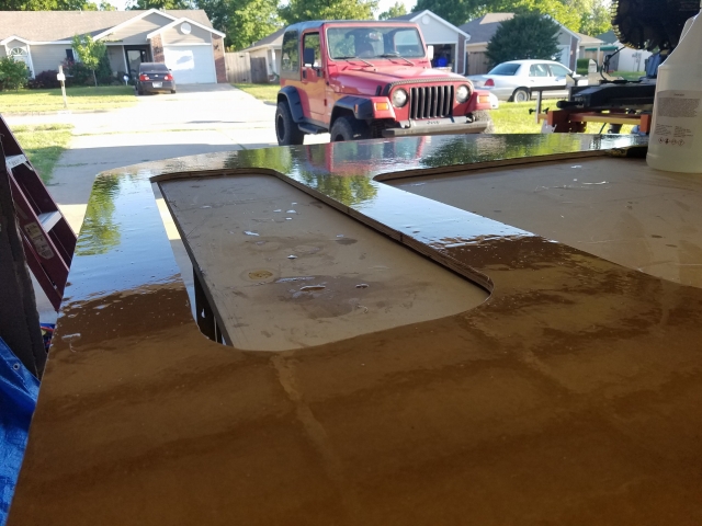

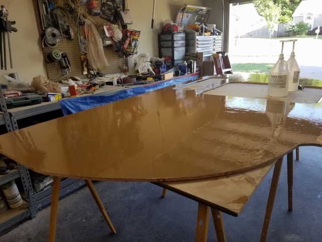

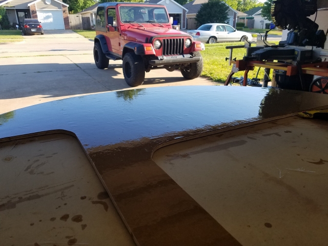

SW, I used a bondo spreader and actually was able to wet it out pretty decent. Just had to learn the proper angle with the spreader. That way it would wet out the cloth and wood, plus not pull/raise my cloth.
The main problem I had was the additional coats. I did wait for the first coat to get tacky. Then I used the spreader and a brush for the second coat. For some reason I could not get it to level out correctly. Some parts were nice and others still showed the cloth. I tried to brush it around/level it to make it look better.
Since that wasn't working, I waited for the second coat to get tacky. I figured well maybe a third will be easier to fill in the low areas. Still didn't work. Practice will help I guess. I did pick up an epoxy roller. Maybe that will help for the additional coats? Overall I got good coverage just looks like crap lol
Thanks for the help!

KCStudly wrote:Another tip is to trim the edge closer when wet, about 1/2 inch or less; that way it doesn't tend to try and droop of the corner, which in turn lifts the fabric right next to the edge, resulting in a ridge or dry cloth/bubbles.
KC overall/mostly I was able to get it to wet out with no problems. I could definitely tell the difference in the second half of my layout than the first half. Hopefully the roller helps with the additional coats.
Thanks for the tip about cutting the cloth closer. I did notice bubbles on the edge. I also kept bumping it while I was reaching over into the middle of the plywood.

DWT77 wrote:The main problem I had was the additional coats. I did wait for the first coat to get tacky. Then I used the spreader and a brush for the second coat. For some reason I could not get it to level out correctly. Some parts were nice and others still showed the cloth. I tried to brush it around/level it to make it look better.
For the additional coats wet on wet I always used a small foam roller or a really short nap one. First coat was done using a spreader like described but the subsequent coats go on really well and evenly with a roller.

Postby KCStudly » Wed Apr 12, 2017 12:54 pm
:thinking: I wonder if your tack wasn't tacky enough. Not sure if it is possible, but if it wasn't tacky enough in spots perhaps the weave "floated" (or was pushed) up.
Re: Off Road Grumman 2 (5x5x10) Build
Postby DWT77 » Wed Apr 12, 2017 8:14 pm
KCStudly wrote::thinking: I wonder if your tack wasn't tacky enough. Not sure if it is possible, but if it wasn't tacky enough in spots perhaps the weave "floated" (or was pushed) up.
I did put the second coat on to soon. I figured that out about a 1/4 into the second coat. I stopped and waited about an hour before putting on the rest of the second coat. For the third coat I waited 2 hours.
I thought it would set up quicker then it did. Of course I had only tested a small board and checked it well after the epoxy had dried. I had noticed how fast it sets up in a cup so that is what I was kinda going off of.
After reading Raka manual a little more it states "Generally speaking, for up to twenty four hours you can re-coat without sanding and still get a good chemical bond" Which the 24 hours seems a little long because mine had definitely set up by the next morning
I think I have a better feel of what I need to do now. Hopefully anyways

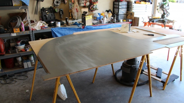

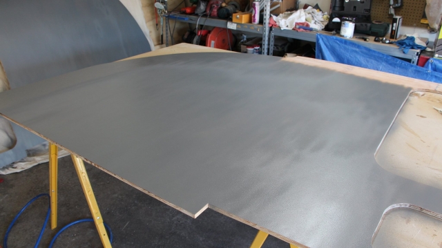

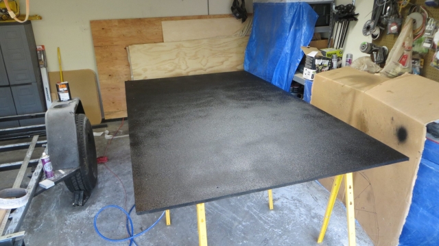

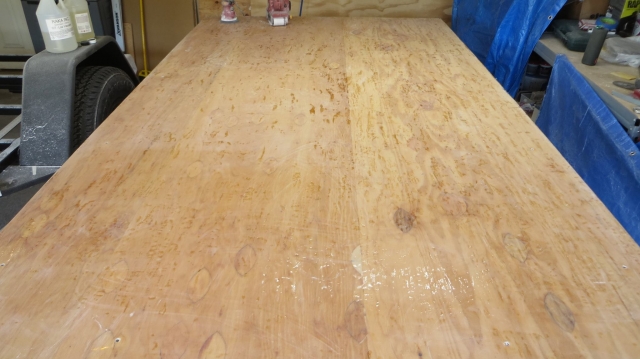

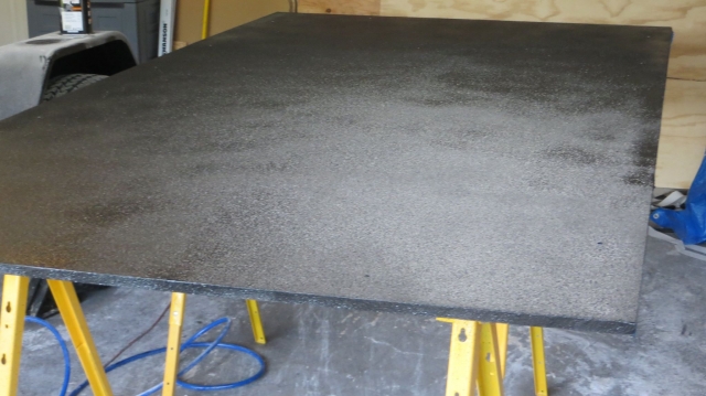

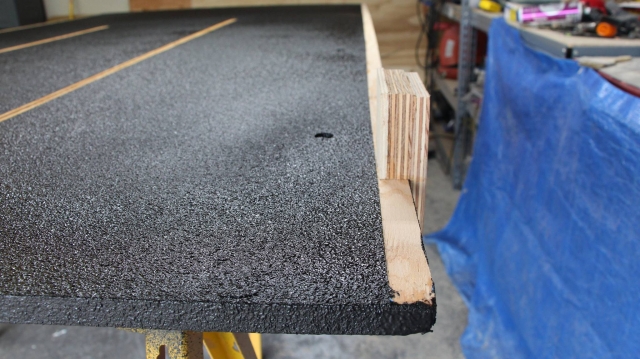

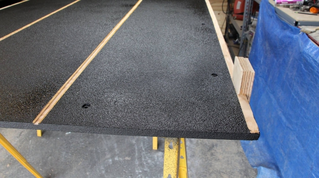

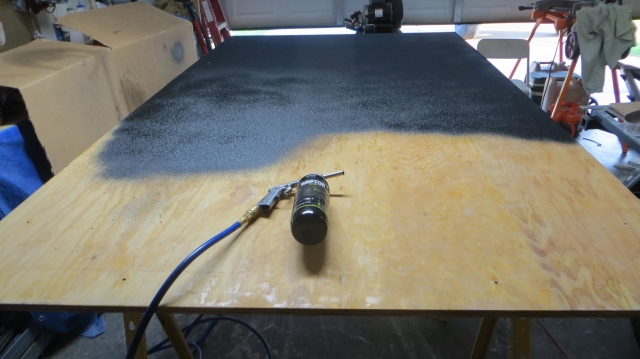

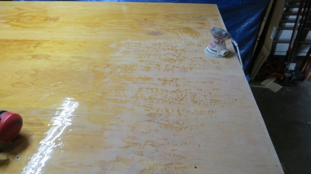

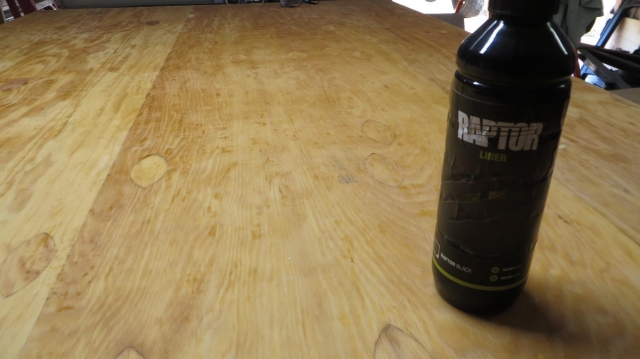

Tonight I finished sanding the fiberglass. I started with 60 grit orbital sander and found that wasn't working very fast. Then I tried the belt sander with 80 grit and that took to much off to fast. Then I switched over to 120 grit on the belt sander and found that worked the best for me.

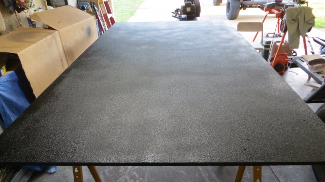

After sanding and cleaning off the fiberglass I put down the Grip#4 adhesion promoter. Waited about 20 minutes and sprayed it with Raptor Bed Liner.
It took about 2.5 bottles for 2 coats and to get the coverage I wanted (Plywood is about 5x9). Once you start a bottle you may as well use it, so I just finished off the plywood with the remainder of the bottle.
In a few days when that is good and dry I will flip it over and start marking out the dados I will need for my flooring system.

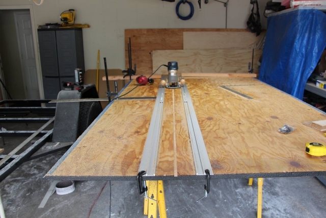

Postby DWT77 » Sun Apr 16, 2017 5:57 pm

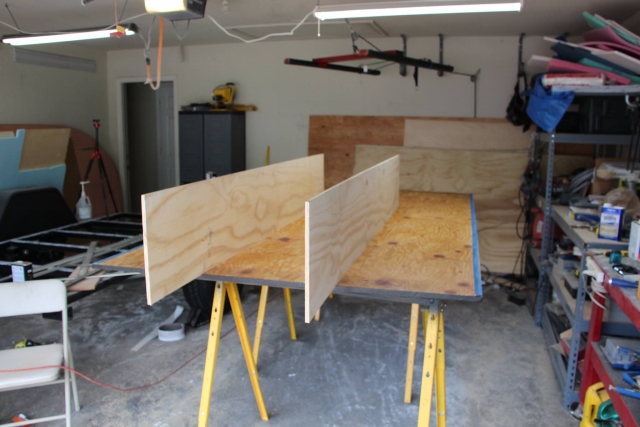

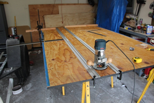

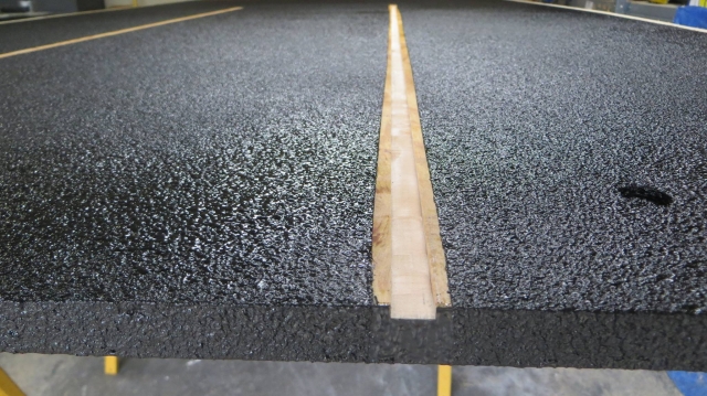

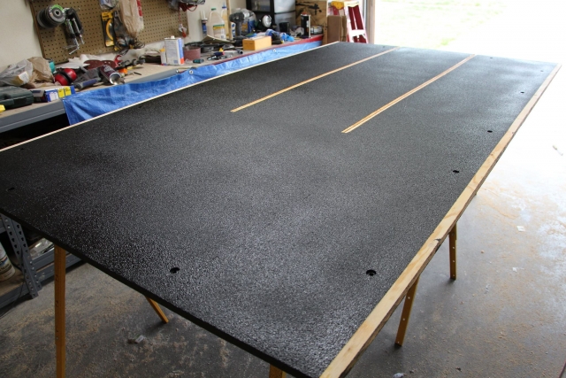

Today I got the top side of my floor completed. I got the dados done for the dividers that will make up my storage area. I may cut those down a couple of inches. They seem a little tall and I'm sure an extra couple of inches in the cabin would be nice.
Then I sprayed it with bed liner. I taped off edge so I can wet it out and apply epoxy when I go to permanently install the sidewalls.

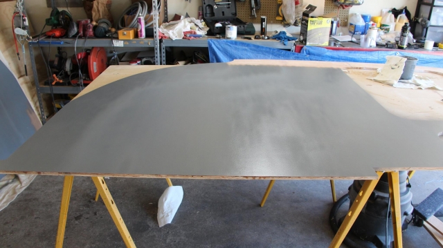

Postby DWT77 » Sun May 14, 2017 5:35 pm

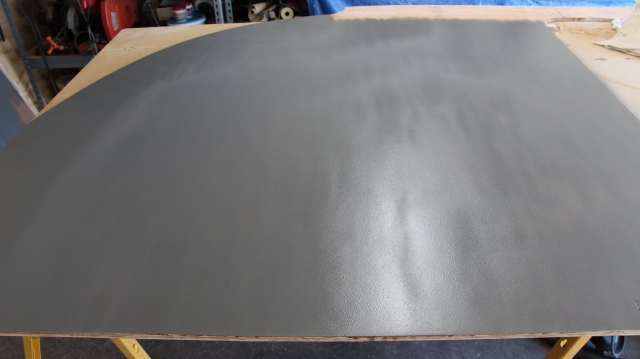

I got my two exterior walls sanded down. Then I got one coat of bed liner sprayed. I wanted to get part of them done because when I put up the walls the fenders will be in the way so I wouldn't be able to spray that area. I didn't go all the way to the top because I still need to fiberglass where the wall and roof edge meet together.

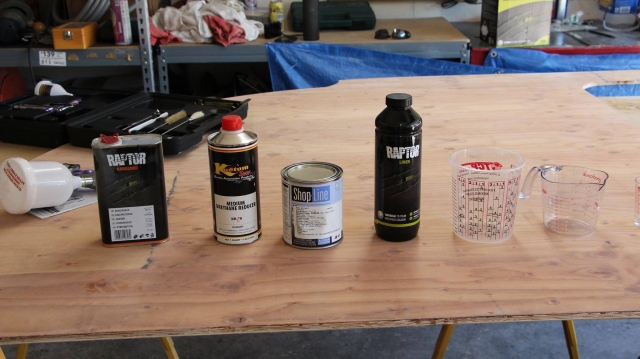

I wanted a smoother finish for my walls than I did with my floor I sprayed previously. I did some research and found a way to reduce the bed liner so it is not as coarse.
Fine texture using a HVLP Gravity Fed Gun -
15% Urethane Reducer -
1.6-2.0mm Tip -
29 PSI -
Spray at a distance of at least 6" from the surface -
Spray one even, wet coat, and then a second coat reducing the pressure and material flow to achieve a fine mist
Amounts used
750 ml = 25.3 oz – Raptor Bed liner
250 ml = 8.4 oz – Hardner
150ml = 5.0 oz – Urethane Reducer
100 ml = 3.3 oz – toner/paint
It's definitely slower than using the schultz gun but you also get about 25% more coverage out of the bed liner adding the reducer.
I will have to add another coat. Then they are ready to put the wiring in for the switches and mate together.
