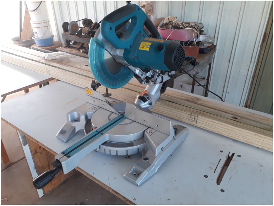

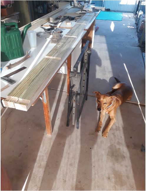

Postby MickinOz » Fri Nov 15, 2019 2:48 am
And so begins the wood butchering.
Bought some timber, cut a couple 9 foot side rails and cut some housed joints for the cross members.
Happy with the way they came out.
Housed joints.JPG (63.08 KiB) Viewed 4679 times
MickinOz

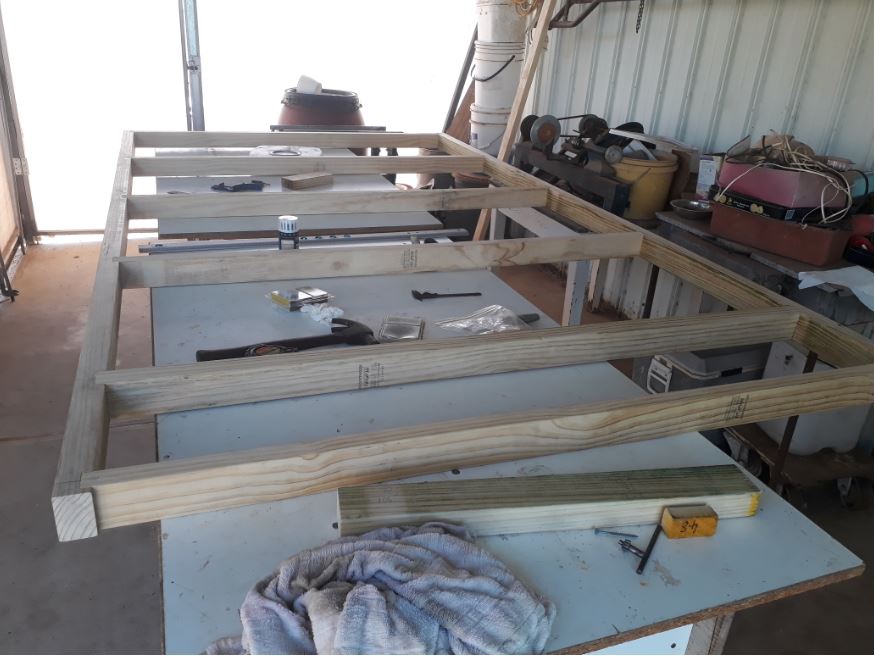

Postby MickinOz » Sat Nov 16, 2019 10:51 pm
Floor frame assembled.
The 'drop will be 61" x 106" internal measurements
floor frame 17.11.2019.JPG (82.14 KiB) Viewed 4628 times
MickinOz
Posts: 1305

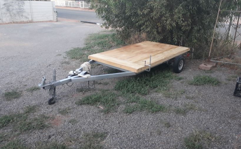

Re: Slow Build in Oz
Postby MickinOz » Mon Dec 16, 2019 4:21 am
Got me a floor. It's been slow, but I do a little every weekend and see a little progress.
5'1" x 9'.
Frame 2 3/4" x 1 3/4 longitudinal, 2 3/4" x 1 3/8" transverse joists.
10 x 3/8 bolts hold the frame to the trailer chassis.
floor on trailer.JPG (94.19 KiB) Viewed 4443 times
MickinOz

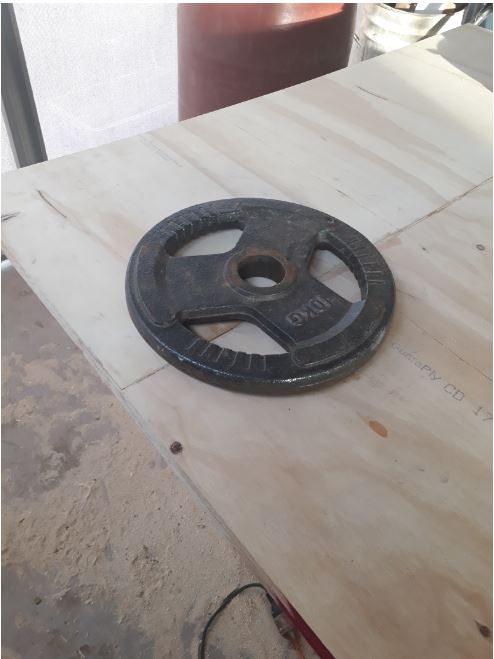

Postby MickinOz » Sun Dec 29, 2019 3:20 pm
Well I've successfully turned 2 x 2400mm sheets into 2700mm sheets.
They are not perfect to my eyes, but my super fussy DIY mate said, "Heck, they came up alright mate."
While I obsessed over the adequacy of 85mm of overlap in the join, he laughed and said "You're not building a tank."
Seems to be a common theme. :)

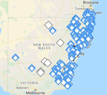

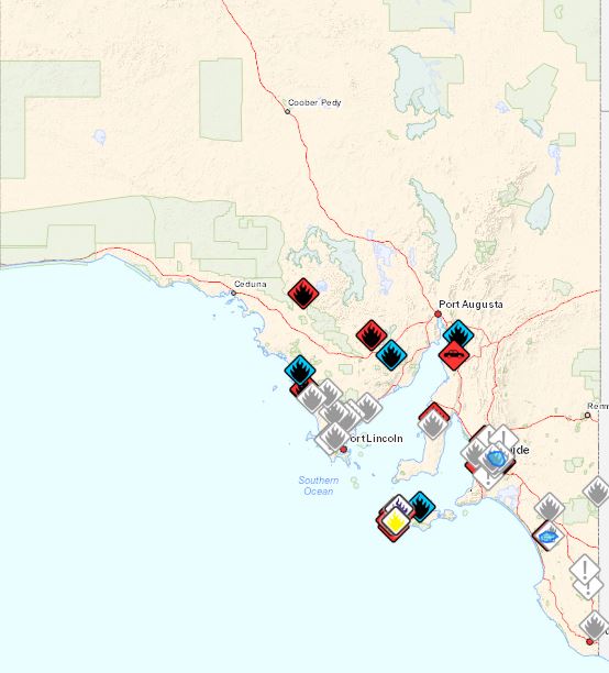

So hot here.
Over the border in Victoria 30,000 people have been told to leave East Gippsland.
If they are not out by 09:00, the roads will probably be closed and they'd better hope their bushfire survival plans are adequate for the worst fires we've ever had.
Add in 15,000 from the cancelled Falls Festival, and there's a chance the highways in Victoria will become giant carparks.
Fire commanders on the news are using phrases like "only so much authorities can do", "people need to be personally prepared" and "leave now, can't guarantee your safety, etc".
Here in South Oz, the Adelaide Hills and Kangaroo Island are in strife.
