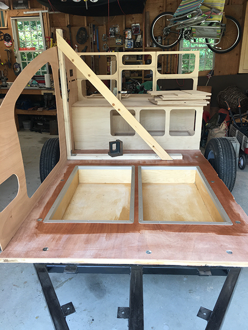

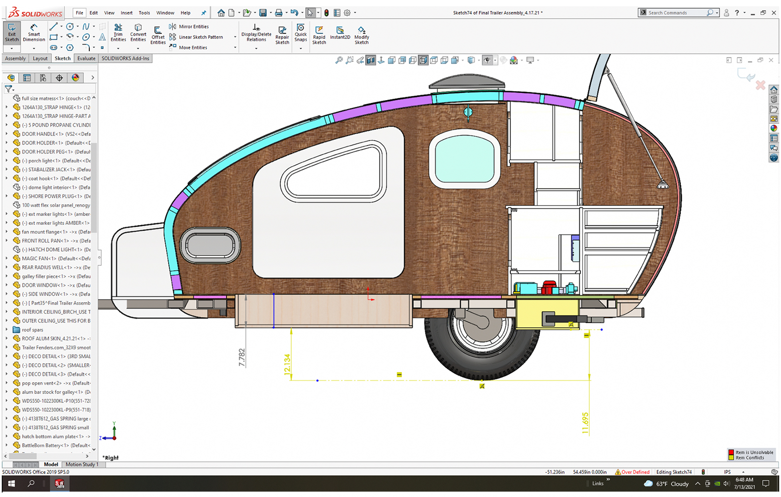

John, great progress! I like your well thought out planning and execution. I am curious how deep your storage boxes are and how much ground clearance you have. Mine are at 10” ground clearance and set back far enough that I hope I have enough for uneven ground. They also have two layers of glass on them as well. I may add some sort of chip guard to the front like aluminum sheeting for protection. I hope I don’t have to adjust the axle.

western traveler wrote:John, great progress! I like your well thought out planning and execution. I am curious how deep your storage boxes are and how much ground clearance you have. Mine are at 10” ground clearance and set back far enough that I hope I have enough for uneven ground. They also have two layers of glass on them as well. I may add some sort of chip guard to the front like aluminum sheeting for protection. I hope I don’t have to adjust the axle.
Good point. :thumbsup:
My first TD the under bed storage box would scrape on those driveways and entrances to shopping centers that drop below the surface of the street.
It's the leading edge that was getting hit.
I ripped it out and cut it down.
I now leave 12" of ground clearance, 80" from the hitch and haven't had the problem anymore.

Western Traveler.... in answer to your question about ground clearance, I've attached an image showing those measurements. Basically around 12 inches of ground clearance (batt box is a bit closer to the ground, 11.695 inches). The footwells have an interior depth of 7 inches. Hope that helps.

After recently taking the trailer chassis out for a drive the other day I now keep noticing little stones embedded in the tire treads ( I find myself flicking them out, hurts my pride to see them there). This was just a small ride up the road and back... but gives me a feel for the amount of stones that probably will contact the trailer doing 60mph down the highway or back roading.

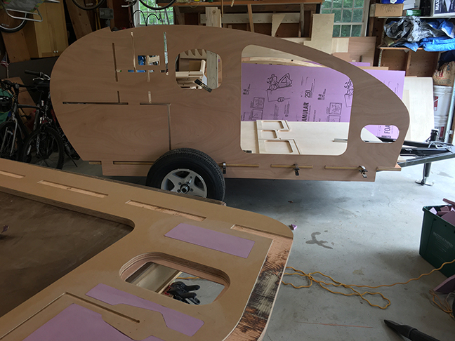

installed the rear cabinetry/headboard. Will have to wait to install the upper portion until I receive the laminate I ordered (3-4 weeks wait :( )
Installed the angle molding around the footwells. Now working on the sidewalls. Was going to work on the bed/couch mech and set that up but thought it might
be good to get the sides established so I know an accurate interior measurement.
If I had my druthers and a chance to do it all over again I would have skipped the dados in the side walls that match up with the cabinetry and just pocket holed them in place.
Turns out the CNC'd dados on the side walls are a bit off from my cabinetry geometry so need to make some adjustments. Workin' on it.

I’m assuming what you referred to as dados are the slots that your interior members go through.
Never seen that method , are you going to trim the protrusions flush?

The "dados" I was referring to are the slots located in the ply of the interior panel (the ones the cabinetry ends mate with). The birch cabinetry is cut just long enough to be flush with other side of those panels and where the middle panel would butt up to those cabinetry ends. My original intent was thinking it would kind of "lock" everything in place. But because my cabinetry location is a bit off from the slots CNCd into the interior panel, that is causing some headaches. I needed to widen the slots on the interior panel a bit to allow the cabinetry to fit into the slots. I'll either gingerly fill the spaces with strips of panel material (glue in place, sand and hope for the best) or cover the gaps with a molding of some sort.
