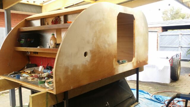

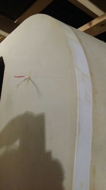

When I belt sanded the ribs I put a flat spot on the outside of the right hand profile but the inside was ok so I cut the rebate both inside and outside.
Where they met I didnt cut far enough and when I changed the the top bearing flush trim it took off on me.
Least it didn't damage the inside of the galley.
Recon I should prime the filler or smear spack over it before the pmf?
I'm concerned about it sticking to the bog (bondo)

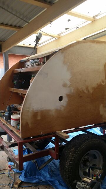

I got that far before I pulled the pin last night

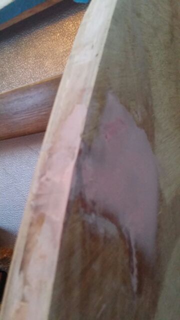

Used some fiber reinforced bog aswell as some standard stuff and pared it back with a chisel between coats

I had a friend that had a router slip... ended up running around on his thigh. They didn't use bondo to fix it. :oops:
Dunno if TB2 glues to bondo, I bet it will but you might want to do a test first. Giving it some tooth with 80 grit, will help of course.
Looking good, as usual. Glad that accident was easily fixed. :thumbsup:

TB2 does not stick well to polyester filler (first hand experience). If you scuff it and coat, and repeat several times it will eventually catch, but you may have better luck hitting it with some spray bomb primer first. Maybe.

Ive got some super primer that sticks to anything and ab g nothing sticks to it supposedly.
Might have to try tbat

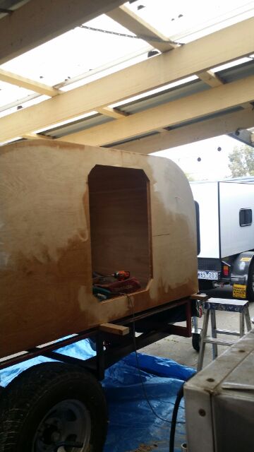

Postby dales133 » Tue Oct 06, 2015 10:33 am
Didn't have alot of time after work today but made use of daylight savings starting and went over the ply skin with a straight edge and pencil to mark any high spots then belt sanded them back.
I blocked back the repair on my opps moment,primed and spack filled it.
I also spack filled an area at the front that had a bit of a concave thing going on.
Esentialy the drivers side is pretty much ready for canvas other than a few small things.

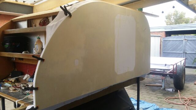

Postby dales133 » Sat Oct 10, 2015 5:44 am
Cheers frank.
Just come in from outside,trimmed it up and glued the edge down after fixing a few bubbles.
