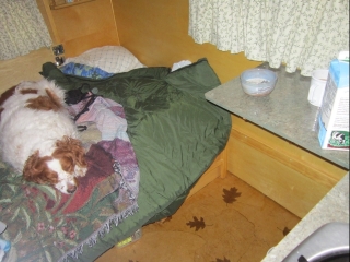

73”….Yes, the bottom, “leg” platforms butt up against the cabinet trim, except where the hidden “Middle-of-the-night” potty resides. The two largest of the removable leg sections are 30” long. They can be stored either under the seat cushions, during transport, or on the removable bars, above the benches, during the day. The smallest leg platform section is just 15x22” and is used in front of the potty area, in order to give a 15” square standing area area, when the bed is made into an almost queen sized width. That little section has never actually been needed and it spends most of its time as an add-on counter/eating table, attaching under the windows, next to the sink.

PS. Please tell your wife my trailer-potato dog is still fat and we continue to take many walks. She'll probably get a laugh out of that. :lol: (He loves the trailer.)
