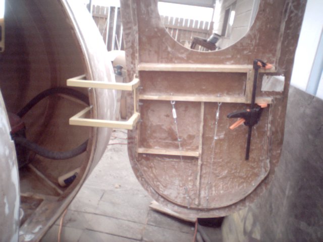

Andrew remember when you asked me if the door held its shape when I cut it out?
Note the two cables are under tension.

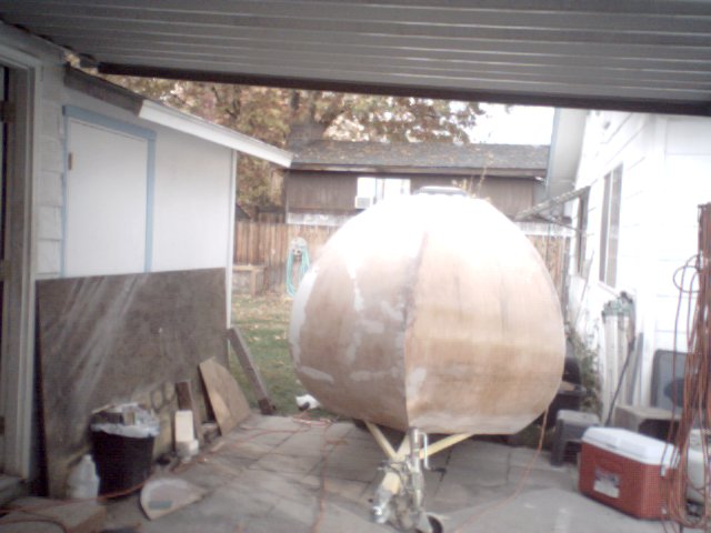

I did finish sanding the body, no it is not perfect, but close enough for this trip.

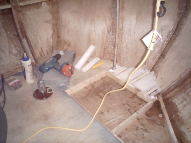

I worked more on the floor.

Postby angib » Sat Nov 10, 2007 7:09 am
del wrote:Note the two cables are under tension.
Fiberglass would be an ideal material to make a permanent fix of this - pull the wires a bit tighter than normal to allow for a little spring-back and then laminate over a couple of ribs to fix the shape.
Fit a front plate between the two ribs and there's the magazine rack you always intended to fit to the trailer.....

Postby del » Sat Nov 10, 2007 10:42 am
Andrew
Magazine rack :thinking: :thinking: . I hoping this fix will last till spring. Then insulate and cover the void completely.

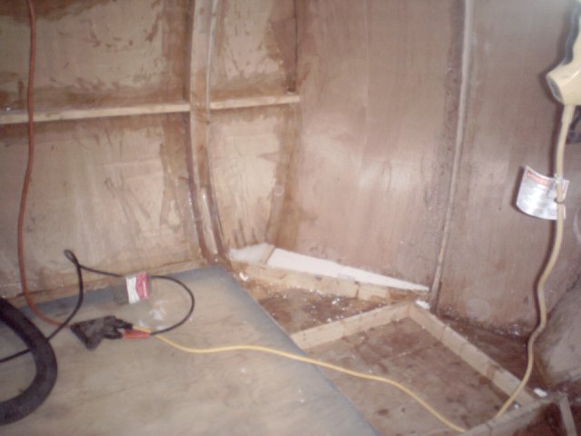

Postby del » Sun Nov 11, 2007 12:01 am
Today I woke up all excited because I was ready to put primer on the body, not to be, ####### wind. So i went out and worked on my subaru. It now has a new fuel filter, and is wired (mostly) for electric brakes, and charging. About 4:30 the wind died down, so after dinner I worked on the floor, for as long as I could stand the cold. Like my concrete gravity clamp?
Although I did not accomplish what I wanted to, I did work that was required for my trip.
