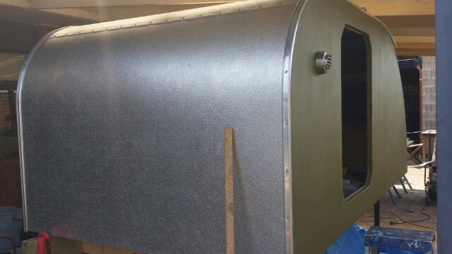

I got the aluminium sheets installed today but im not realy happy with the front join.
To make the sheets work i had to join it right on the apex of the front radius and the tensions left it sitting up a little.
Its sealed and isnt an issue it just annoys me.
I might try to find some trim to cover it.

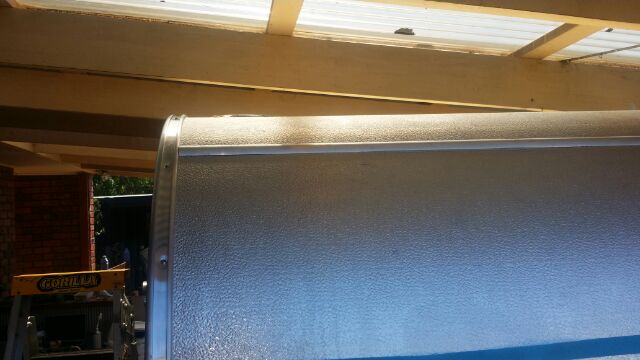

Heres a couple of pics where i left off yesterday.
You can see the join i dont like....im considering putting a molding of some description over it possibly or swapping the screws for rivets maybe...

That seam looks okay in the pic. What don't you like about it?
If it is just the appearance if the screw heads that is bothering you, perhaps consider trim washers to dress them up some and maybe spread the puckers out a little?
Re: Ok here we go...PMF!
Postby dales133 » Fri Oct 16, 2015 9:32 pm
KCStudly wrote:That seam looks okay in the pic. What don't you like about it?
Ugliness averted.
It was doing my head in,just a realy bad place for a join and they didnt sit completly together.
I went and got some sealed aluminium rivets this morning and swaped them over the put an aluminium D molding over the top with sikaflex.
Needs the glue tidied up but looks so much better.
