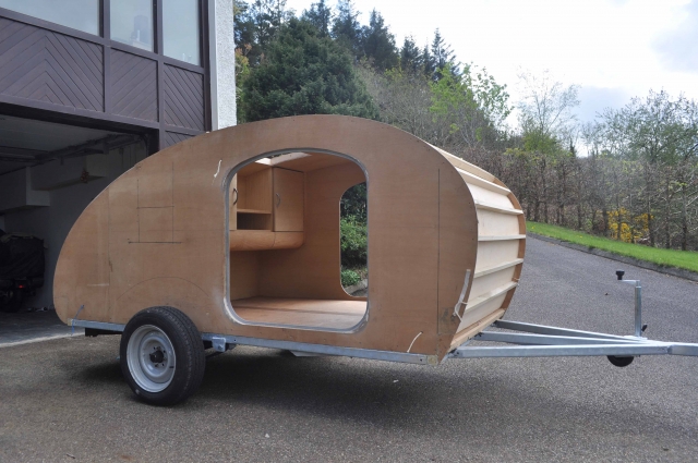

Postby McGuffin » Fri May 01, 2015 6:31 pm
Hi Dave,
Hope you are well. Just to let you know I am still working on the Irish Atma (a mere 15 months later :? )
Just got the cabinets finished and the headliner in recently. Here is a snap:
and a link to the build.
viewtopic.php?f=50&t=59456
Thanks for your help and encouragement (although you should have warned me about the sleepless nights :roll: )
