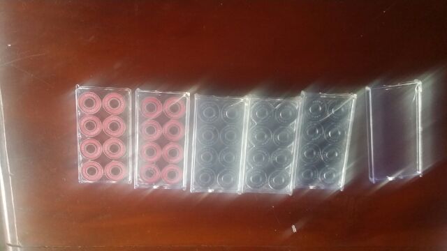

Oh and tony...i got these...
Just trying to work out wether to make the draws out of ply,aluminium or both

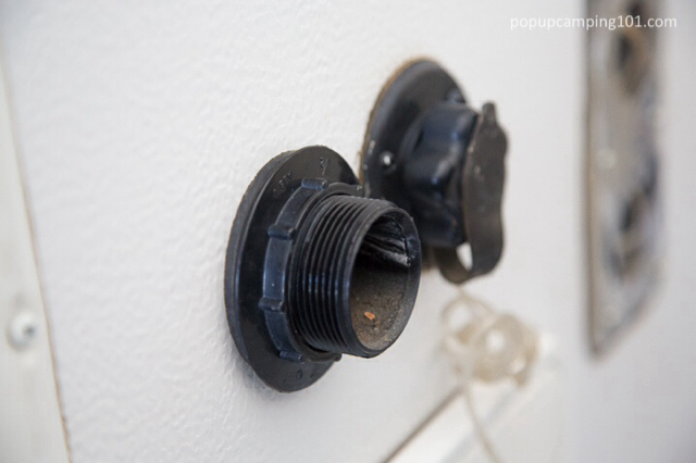

With the water, will obviously need 3 holes, filler, breather & waste. I am looking for options here other than just drilling holes and using silicone. I have found a few pieces that might work, they are basically a thread with two nuts, with washers so when tightened up the washers seal either side of the floor (tank fittings). I will have to look at other options along the pvc line.

Postby Strop » Fri Oct 30, 2015 2:46 am
This is the kind of fitting for water I was talking about.
