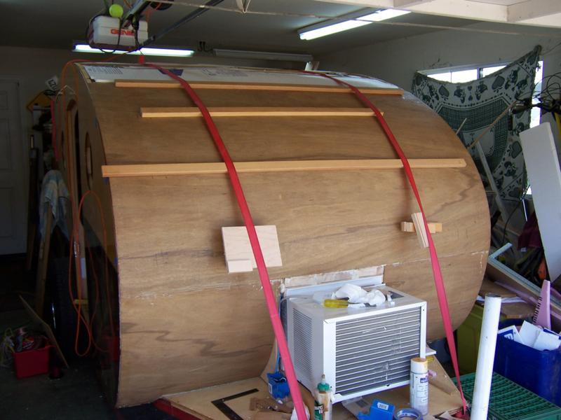

Installed first 1/8" ply next to the A/C Sunday.
2nd piece tonight.

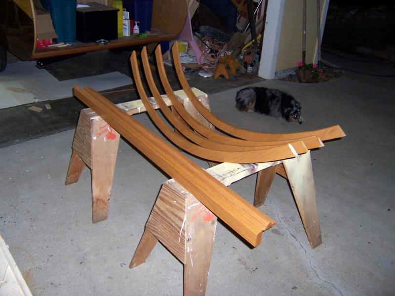

On the build front, cut and sanded the ribs over the last week.
Stained the ribs tonight.
Nattie is keeping watch, like to good dog she is. :thumbsup:

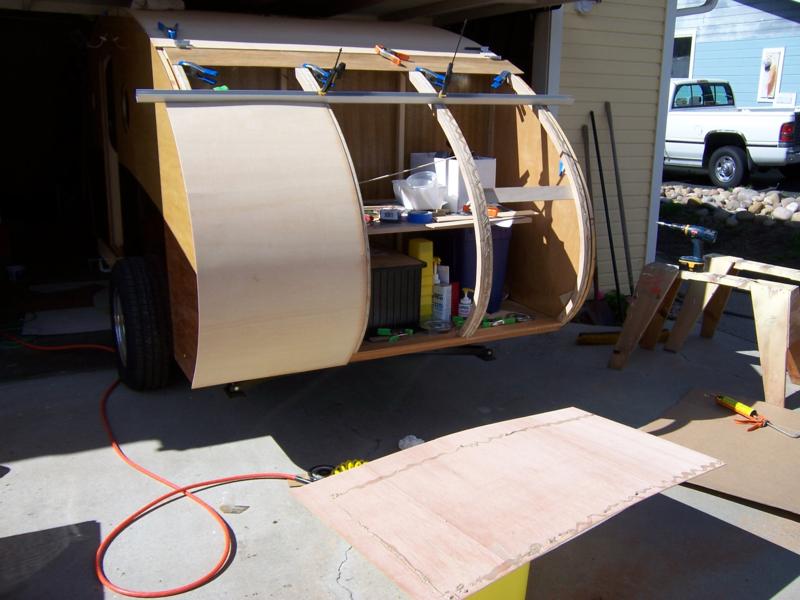

Postby Wolfgang92025 » Mon Mar 01, 2010 11:10 pm
Even with a lot of ran saturday (1.5", a lot for us), I got a lot done.

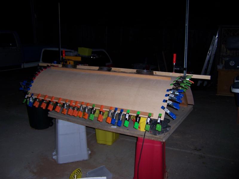

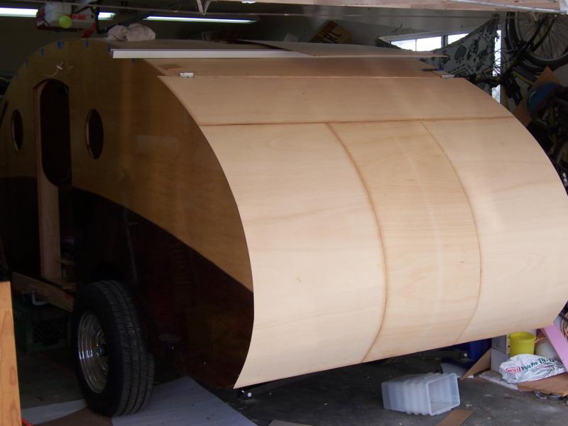

Assembled and skinned the outside of the hatch.

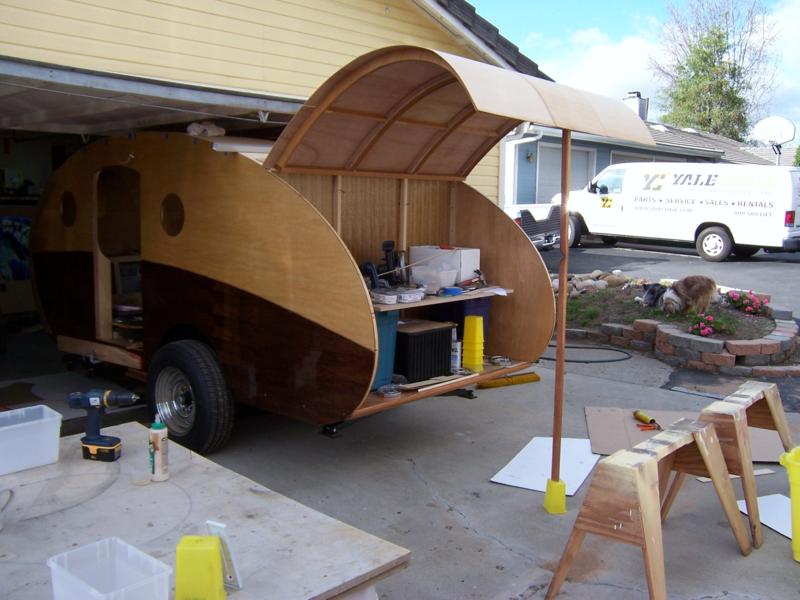

I sat the hatch frame in the opening and put 1/4" shims on the side to help keep it in place. 1st piece in place. 2nd piece has glue on it and was about to be installed.
Hatch completely skinned with 1st layer and held in place until after a second layer of 1/8" luan goes on top.
First time with the hatch open. And a big step forward. :D
Made the sides of the hatch about an inch longer since I'm still not 100% sure what the hatch detail will look like when it's done.
Wolfgang
Only 135 days till IRG III
Wolfgang

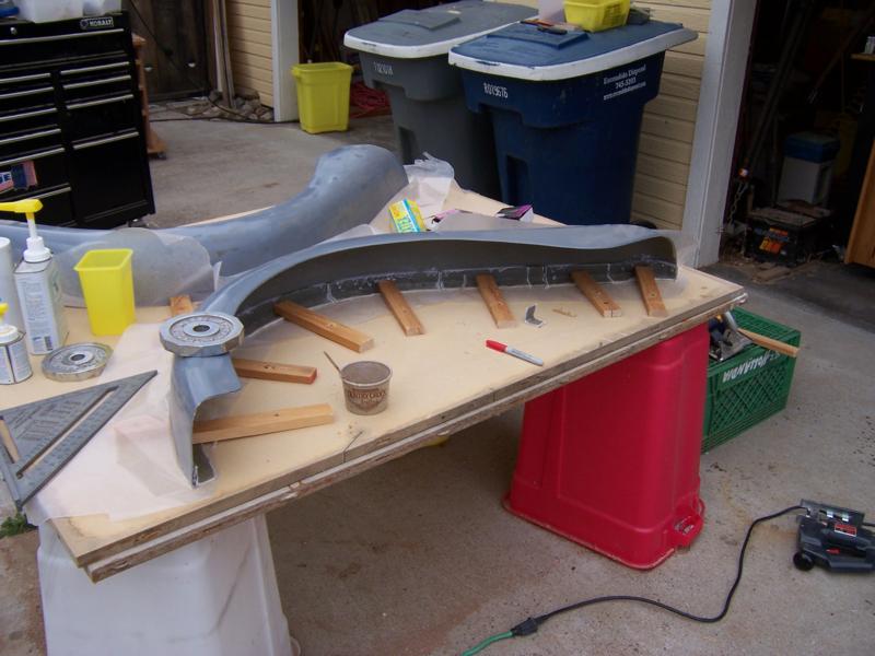

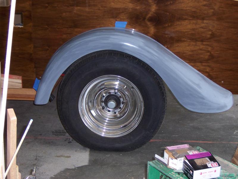

The 9" grant fenders needed to be cut down in width by about 3". I think Doug (?) posted on the best way to do this about a year ago. So I will not post the details, other to say it worked like a charm.
Pair of narrower fenders
Fender held in place with clamps to see how it will look
That's all for today..............
