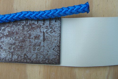

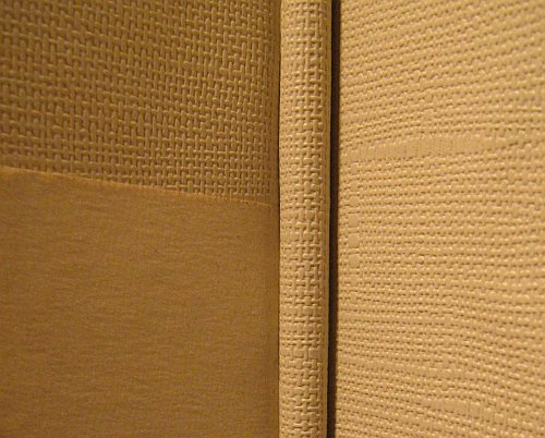

Hmmm, I wanted to do it today so that I could secure the aft bulkhead and begin the desk/bathroom divider wall. Home-made welt? Why not? I had enough vinyl left-overs that could be cut into strips. I could then encase a piece of rope in the strips and staple them in place. It would've been easier to pre-fab the welt strips but after my recent experience with failing adhesives, I decided to "welt in-situ".
From the back side of the bulkhead I slid the vinyl strip in the gap and stapled one edge, then went inside the cabin to place the rope and fold the vinyl back over and slip it back into the gap. Back to the other side of the bulkhead, pull tightly and staple. Worked pretty good but I had to make about 27 round-trips!
The materials used:
This strip was too narrow, making it difficult to grab it after it was wrapped around the rope. I later cut a much wider strip and trimmed excess after stapling.
I was happy with how it turned out and think it will provide a water-proof seal. The nylon rope floats,, hope I don't have to witness that first-hand. :lol:

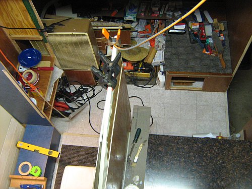

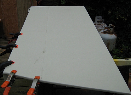

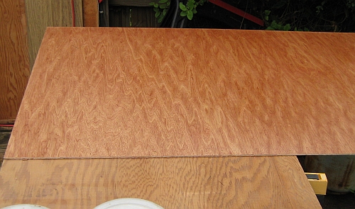

Today was a productive day, which was welcomed after hastling with the vinyl adhesion fiasco. My goal was to build the divider wall that fits in between the bathroom and desk area. I needed a fairly substantial wall there and decided to use another piece from the pop-up, a 5/8" thick piece of plywood that was one of the bed supports in its former life. Some of the edges were delaminated but the "core" was good, so I trimmed it down and had plenty to use for the wall.
As the clouds built, storms threatened and thunder rolled,,, I began working outside. Not enough space inside the shop, the deck serves as an outdoors extension. With a coupla sawhorses set up, I laid out the cutting lines, trimmed the ply down and applied the vinyl and a section of under-desk luan.
Sure hate to see that nice flame pattern be hidden under the desk knee space,,

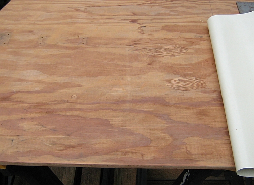

Applying the vinyl to the other side:
The dark spots are glue smudges, I'll clean those up later.

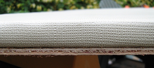

I folded the vinyl over the face edge of the ply before stapling the luan on.

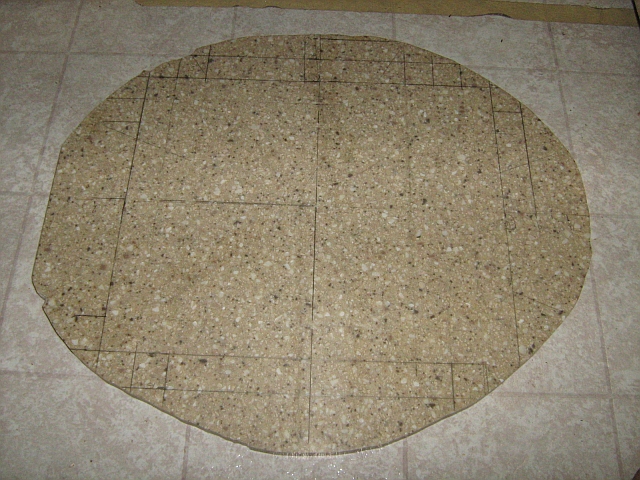

More treasures found at the cabinet shop dumpster "gold-mine",,,, 4 pieces of corian, sink cut-outs. What a waste! I can't believe they toss this out. Let's see,, how can I recycle this? Sink top? I laid out lines in order to maximize the material:

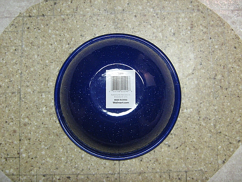

Now,, what to use for a sink bowl? Blue granite ware seems to me like a perfect match. I've got the blue laminate on one wall, a marriage in the making! Wal-Mart camping supplies,,,, $2.88.
The bowl has a small lip, undecided now as to whether I will drop it in or epoxy it in place underneath???

Today's work went well. The divider wall is now installed, just need to trim it out. The desk surface is in place and I started building the upper cabinet for the bathroom. The interior is chock-full of tools and supplies now, will clean that out soon and post some updated pics. It won't be long before the cabin area is done, then I'll start on the A/C install and the galley. 76" W x 32" D, oughta be fun! I'm trying to determine if a 76" wide hatch will be a monster to lift or not??? If so, has anyone split a hatch into two sections, side-by-side?

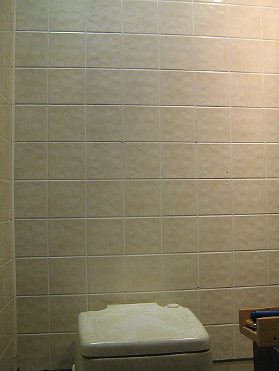

I decided to scrap the vinyl application idea. It looked ok in some areas, in others it sucked. I've been told I have the patience of a,,,,, Saint. But there are limits. I had a sheet of tileboard on-hand and lotza edge trim and decided to go with that. My experience with tileboard hasn't been exactly rosey, which is why I had avoided it originally. It has a tendency to deteriorate over time, 15 yrs. is about the limit with daily showers hitting it. If I get 15 yrs. out of it, I'll be happy. Gotta put it all in perspective. It will be easy to replace later if needed.
This is the back wall of the bathroom area:

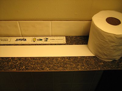

The area next to the ceiling seemed to be a perfect spot for a small storage area for t.p., etc. I applied some salvaged laminate scraps to 1/4" ply, material availability turned it into a "racing stripe" design. This is the cabinet bottom surface.

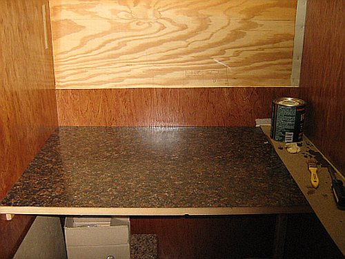

Now, for the desk area. I thought this piece of salvaged laminate was gorgeous! I've been using a lightweight approach during the build so far, so I splurged by adding this, it's heavy. I want an area where I can set up my fly-tying vise without wobble. And, an area where I can use my laptop, watercoloring supplies, small guitar amp and music paper or anything else a desk area offers. The dinette table may offer that, but it will be nice to have another area and a desk seemed to fit the bill.

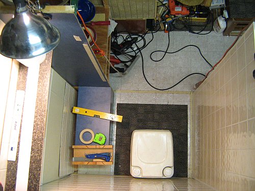

It's challenging to get pics of everything. I decided a coupla sky-view shots were in order and set up the step-ladder on the galley deck. This is the bathroom area:
A wider shot of the area forward of the bulkhead, including the adjacent desk area. I considered clearing all the tools and supplies out before taking the shot and then thought,, what the heck. This is how I do it, works for me. It's a work in progress,,, Norm probably wouldn't agree. :lol:

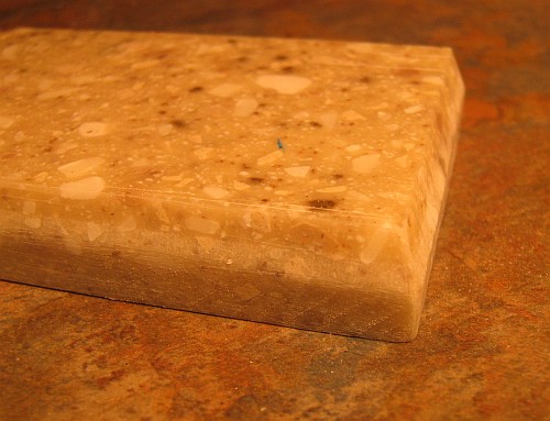

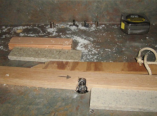

I worked with the Corian scraps today, a difficult material to work with,,, probably due to my mediocre tools and skill level. I decided that the cut-off edges could be used for a backsplash and ripped some pieces, then attempted to put a round-over on them. That wasn't successful, too much chatter. Worn bit I suppose, I've used it on a lotta red oak. Feather boards on top and also on the side didn't do the trick, so I punted and tried my bevel bit. That worked much better. Here the first piece of Corian backsplash is about to meet the router. (Ignore the arrow, direction of feed is opposite in this case.) Recognize the router table material? It's a salvaged laminate counter-top, works great! The switch on that router died, so I built the table from the laminate counter scrap and installed a toggle switch on the front. The fence is a piece of red oak, bolted on one end and the other end slides in a slot, adjusted with a thumb screw on top. I like it much better than my old router table.
The beveled edge. The reflection makes it look odd.

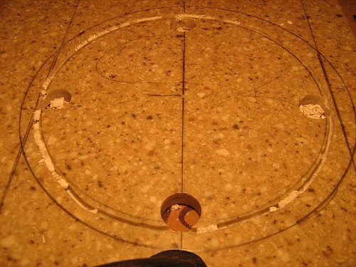

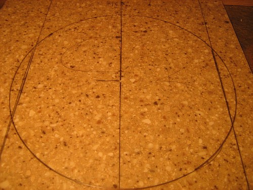

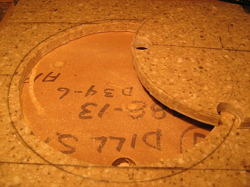

Then, the granite ware bowl was placed on a slab of Corian and lines laid out. I used a compass to mark an inner line that would be smaller than the bowl lip. In the center is a shallow hole used to hold the compass point.
I made several "starter holes" with a spade bit but found these to be unnecessary. Tilting the router into the Corian worked ok. I cut on the line, free-handed, using several passes of increasing depth. Need to build a circle jig for the router.
Sink cut out done.

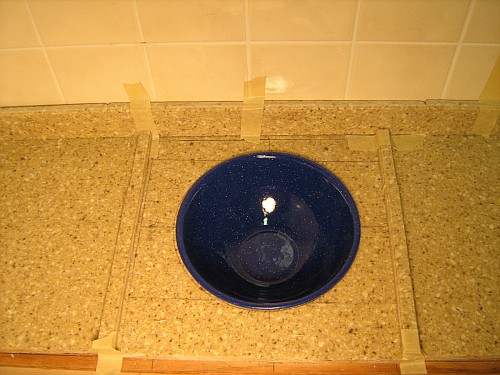

The pieces laid out to check for alignment and fine-tuning before final install. Need to bottom sand that far right corner piece, it's riding a bit high. The curved appearance in some areas is due to camera lens.
Why the thin strips on each side of the sink? I needed to hide the joint lines. Admittedly, they weren't perfect, there were some small gaps. I think the pros use a mix of epoxy and corian dust or a tinted epoxy to fill in joint lines. I'm far from being a pro Corian guy so the beveled strips were used.
Now to cut out the drain hole in the granite ware bowl without it chipping or flaking. Not sure what will be the best approach for that?? Then, I'll seal all with silicone and use epoxy to tack down the strips.

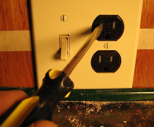

I have also begun adding outlets to the desk area. Need to fix that crooked one with a rasp in the upper left corner. That's a 12-volt receptacle on the far right. The cable plate I had was white and,,,,, for some odd reason,, is larger than a standard wall plate? Go figure. The plate and outlet colors aren't permanent, just getting something in place for now. Might paint them green to match the desk area trimwork.
Oops!

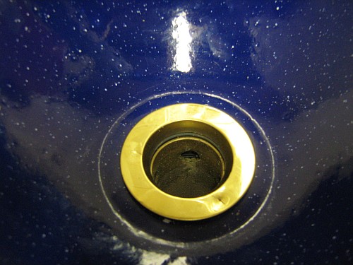

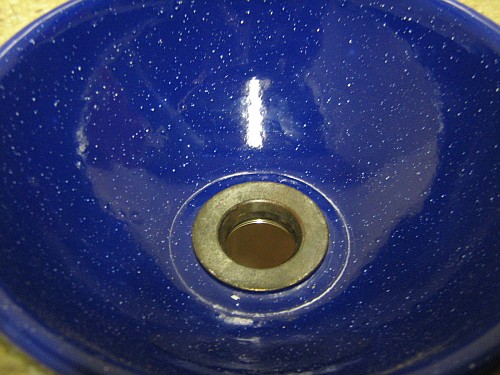

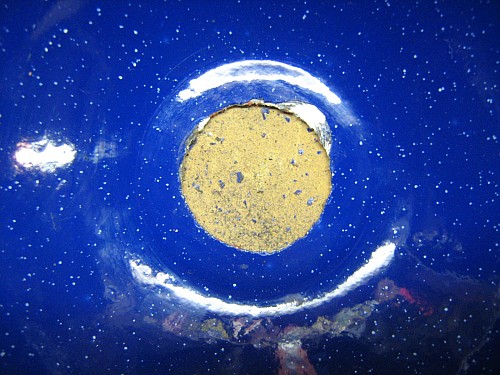

Creating the drain hole in the granite-ware bowl went pretty well. Using the compass I drew a pattern on paper and then taped it to the bowl. Then I used my drill press to create some starter holes and "connected the dots" using a cut-off wheel on the Dremel. I was hoping the tape would prevent edge chipping and it worked pretty well, only got one big flake. (1 o'clock) which will be covered by the drain lip.
I had this brass colored, beat-up drain to use for testing.
However, this other drain doesn't look too bad. More of an antique look,,,

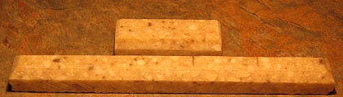

I've been tossing around ideas of what to use for bathroom cabinet door handles ,,, why not pieces of Corian? I made a few test samples. I think these will look nice with the counter top, a coordinated look. Rather than marring the surface, I think these will look best if they are on a coupla short stand-offs with screws from the backside. I'll try tapping the Corian and if that doesn't work, will epoxy them in place. Might use both.

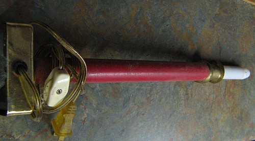

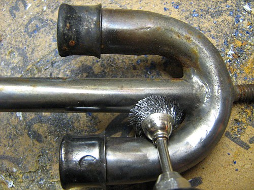

While I had the wire wheel on the Dremel, I decided I'd work on a junker Coleman lantern I found at the thrift store, a $2 bargain. I've got several Coleman lanterns, both white gas and propane models,,, so, I think I might turn this one into a combo 12 volt/AC light for the dinette area. Inspiration courtesy of Bob Henry.
I'll rob the "guts" from this thrift store find. Roller switch, socket and cord,, worth the 50 cents I paid for it.
