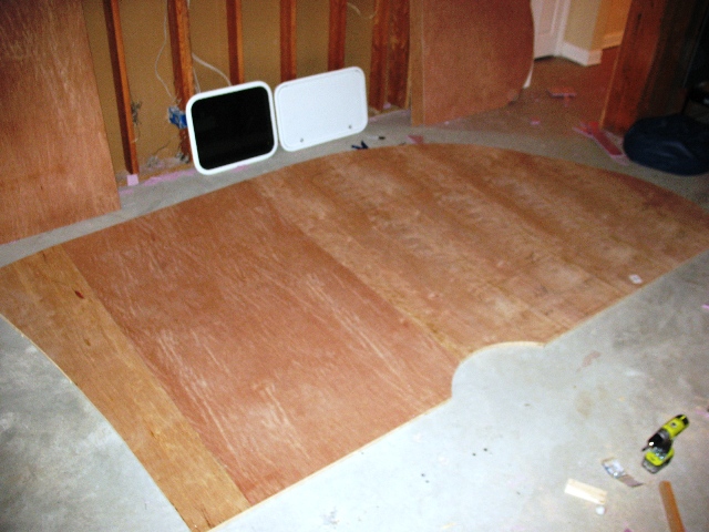

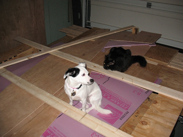

We arrived at my parents' house on Monday to house-sit. I figured I would get tons of progress, but my parents left their car in the garage with no keys. I was stuck with half a garage, and no place to work other than outside. I pulled the trailer in and began to unload, pondering how the heck I will build here.
Maddie helped me unload, and my parents' cat, Coco, had to approve of the trailer before unloading began:
I think Coco was out for blood. Maddie looks paranoid, for good reason.
After I had everything leaned against the wall of the garage, I remembered that my parents' basement is unfinished. Perfect! I'll work there. It was late though, so I moved everything to the basement Tuesday night.

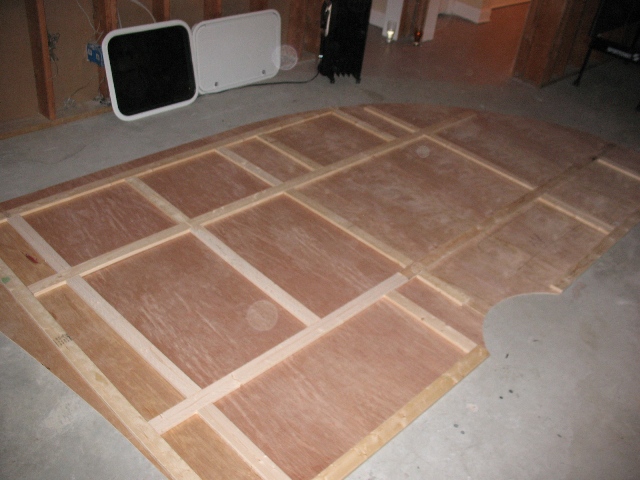

I laid out my profile for the drivers-side wall, and put the windows in place to measure for framing:
Once those lines were traced, I went to bed. I had a long day at work, and was quite tired.

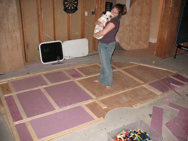

Wednesday, I started the framing:

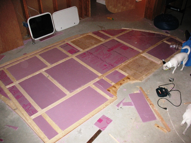

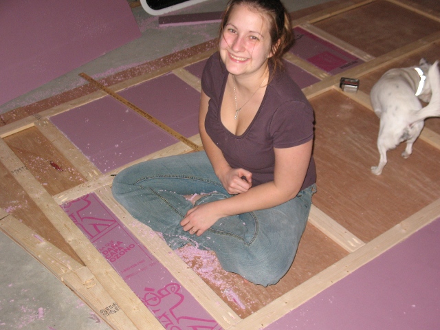

And finished it last night (Thursday). My fiancee, Marcia, wanted to help, so she started helping with the insulation:
We didn't quite finish, we only got this far:
because I had to get up this morning at 6am for a presentation.

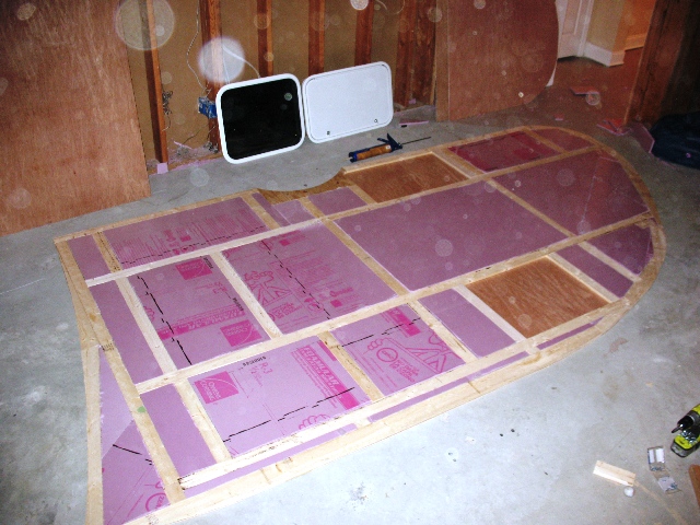

Insulation and border frame almost there:

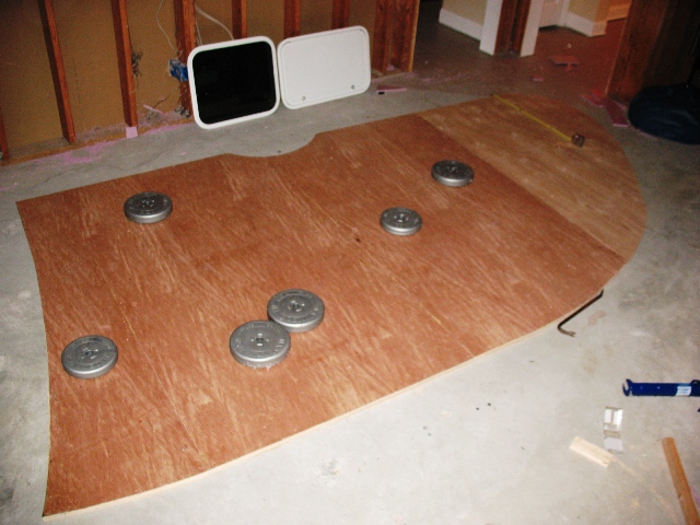

and weighted down to help liquid nails set.

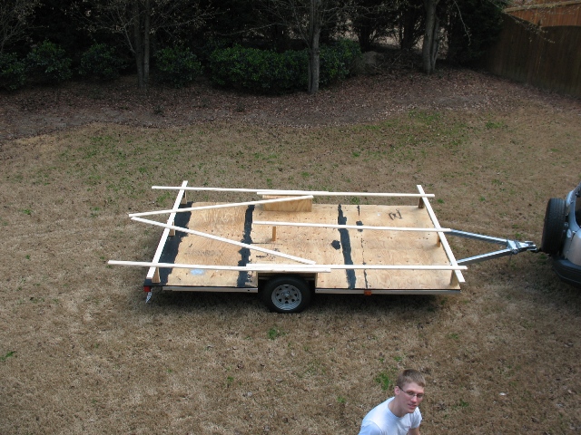

The finished wall went on the trailer, on top of a temporary frame that I built when I made the first wall:
I'm at the bottom of the picture, but I have a dumb look on my face.

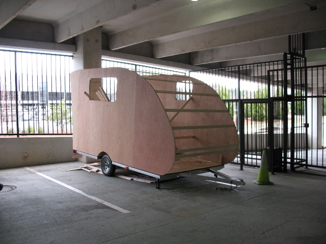

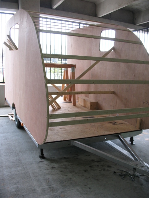

Next, I hauled it all home... Where it sat for awhile. Lots of homework, etc. Technically, last week was my spring break though -- so I decided I had to take at least one day off. I took Friday off and worked on the trailer a lot. Both walls were raised, attached, and many of the roof spars were put in place:
Unfortunately, the trailer is now stuck on the ground floor -- and can't go up the rest of the parking garage because it is too tall! The leasing office doesn't seem to mind, and the maintenance dudes in the complex keep telling me how awesome I am for building anything of that scale at my age. I don't let it get to my head too much. ;)
Here's another view, more from the front:

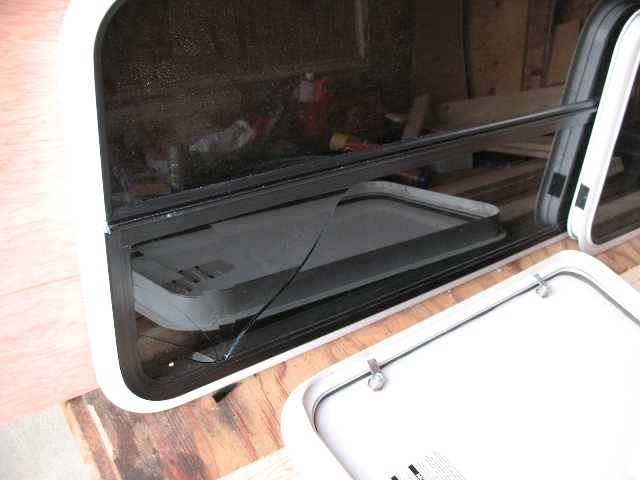

Unfortunately, people drive like morons in the parking garage. A lady in a Mercedes was roaring down the parking garage, and went around a corner completely in my lane. I had to SLAM on my brakes with the cargo trailer in-tow, and the 4x8 boards leaning against the wall fell over on my windows. On the plus side, she slammed her brakes too, stopping inches from my bumper.
She had the nerve to flick me off, reverse, then drive off angrily again. :? I didn't even do anything wrong! I didn't recognize her car unfortunately. She was probably a guest. I wish she wasn't though, or she could have paid for the window that broke from her bad driving:
Only one window out of the three broke, but it was the biggest one.
