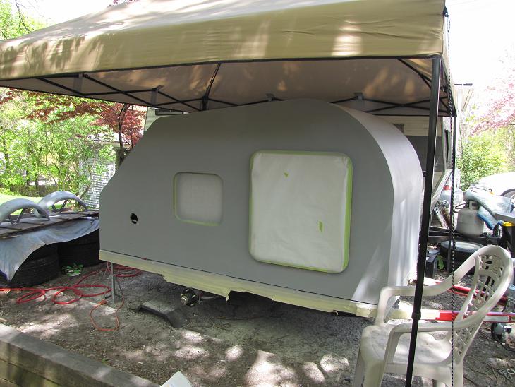

I'll have lot's more pictures up tonight, I'm waiting right now for the induction time on my epoxy, 15 minutes and I'll be priming, and then in a couple hours will be putting on the topcoat.
It's perfect weather today, just cool enough so not too many bugs, but warm enough to not adversely affect the cure time of the epoxy and topcoat.

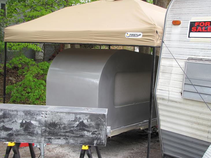

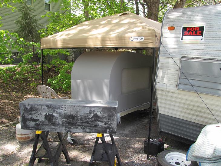

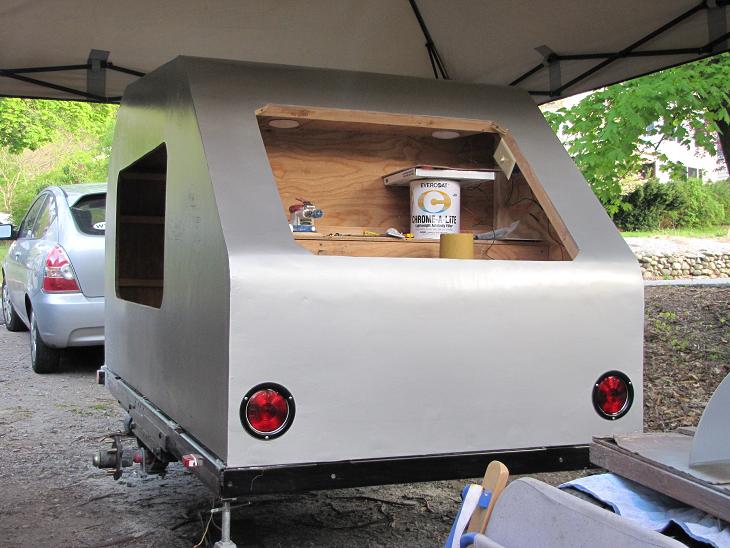

I mixed up 48oz of epoxy primer, just enough to do the trailer and fenders, but you can see in the foreground of this picture, a tongue box I stole off my old Fleetwing trailer. I didn't have enough primer for that.. bummers.

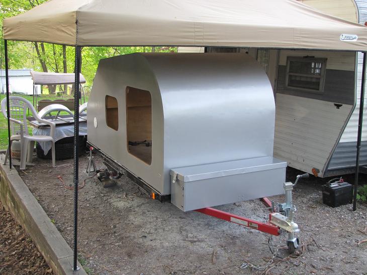

Here's the trailer with two coats of silver acrylic enamel on it. I put a third coat on but didn't take a picture.. doesn't really look much different anyway.

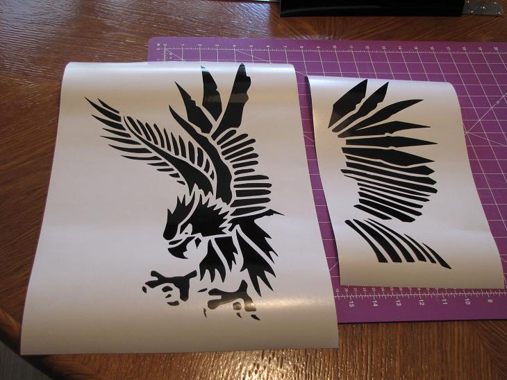

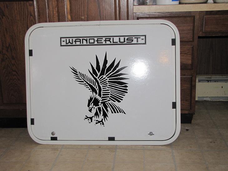

This morning, while I was waiting for it to warm up to near 70 degrees, I did the vinyl for my rear hatch. My vinyl cutter will only cut 10 inches wide, so I broke the image into two parts to get it bigger.

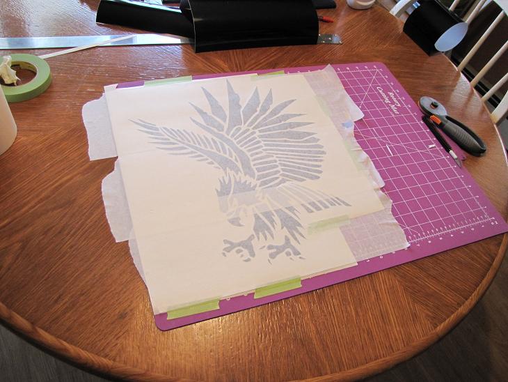

I carefully lined up the two parts, and taped it down so I could apply the transfer tape.
Transfer tape applied...

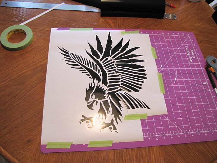

And finally, the moment you've all been waiting for... the finished hatch!
The name took me four tries to get it cut correctly. The cutter can be a little tempermental sometimes, and I had to finally sit and babysit the entire cut so the cutter wouldn't jam as it was cycling the 20" piece of vinyl back and forth. Of course the name is not perfectly centered, but most people will not notice, so I left it.
I'm real happy with how it turned out!

I did manage to get out of my lazyboy and primed and painted the tongue box also.
I got the tail lights mounted, as well as my rear running lights, and my 110 outlet access cover. Tomorrow night when the paint is harder, I'll tackle the fenders.

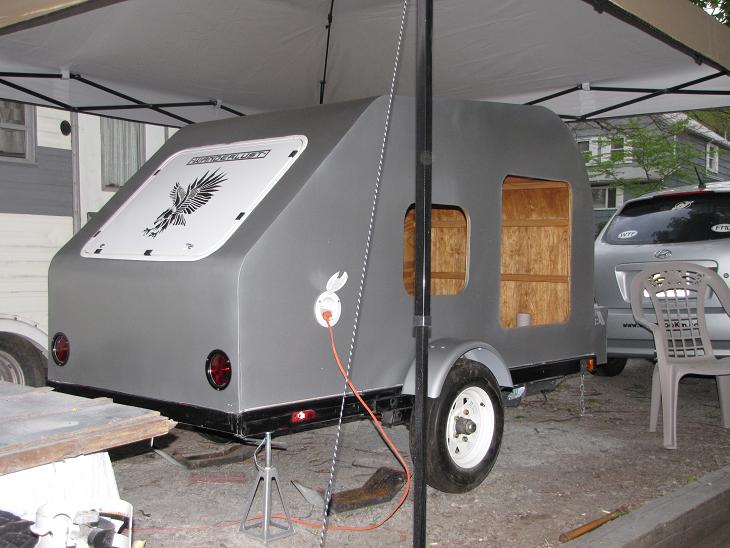

Tonights progress... not much. but I got the fenders mounted and the wheels back on. I placed the rear hatch in it's hole, but it's not screwed, just sitting there because it makes the picture better.
During my hour long drive home from work, I was pondering different ideas for the license plate light. I purchased an inexpensive round one, but now I'm thinking I might want something a little more flashy/unique.
