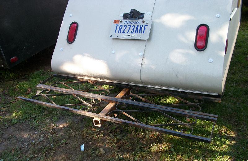

designed and cut some scrap iron into a rear cargo platform

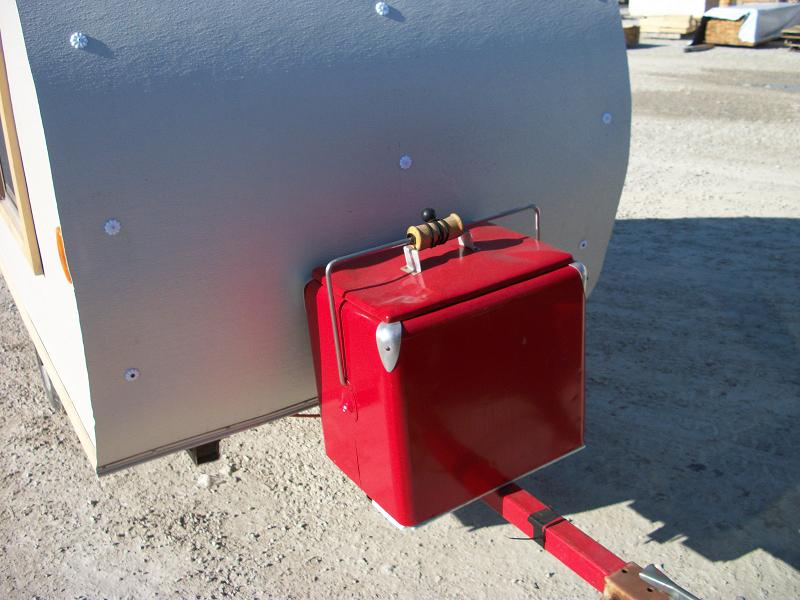

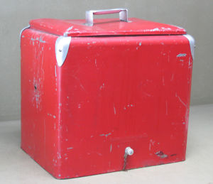

Sanded and refinished an old 40's style cooler for a small tongue box
Image a $15.00 yard sale find :D
(still working on a mount for it :roll: )

Nice find on the old cooler :o looks like it would make a great tongue box. Weld you up an angle iron frame for it to set in, maybe strap it in place? Like the old trunks.

I mounted the newly repainted old style cooler on the tongue for a tongue box. made a rather clever mount out of 2 pieces of 15" 2x2 angle left over from the side rails cut off of the barn's frame rails. As with so many of these old style domed top coolers the top was cruched enough that The bail handle would not clamp the lid tightly so I went looking and found the hand grip cushion from the crutches I had use as table supports. I removed the bail and slid on the cushion. After building up the diameter of the bail with some ice dam tape I centered the cushion and it compresses just right and clamps the lid solid. Now you know why I never throw anything away !

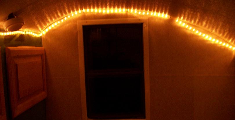

I next turned my attention to lighting and added rope lights across the front down the curb side and across the back to arrive at the quad electrical box. Rope is clipped to the bulkhead walls and each roof spar.
I even added a "Clapper" for remote switching.
Here is a rather poor night shot thru the door.

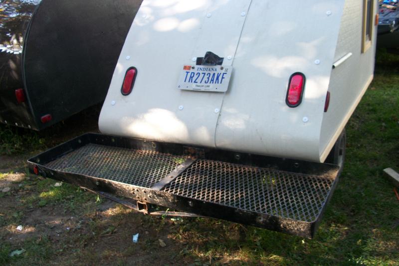

I was toying with a hme made rear rack....
When I found this for $10.00

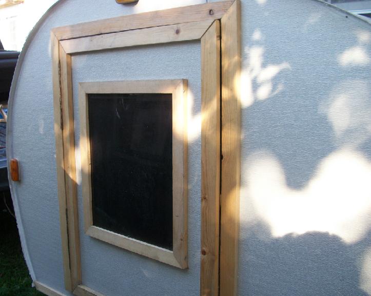

Here s the trimmed out window described above

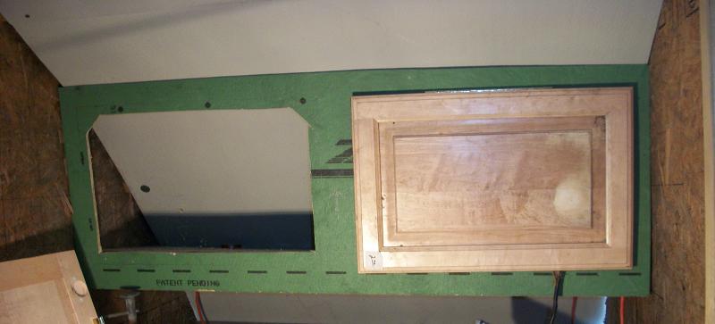

And my poor mans hull liner

Wow Bob, the cooler / tongue box turned out great, looks real nice. 8)
