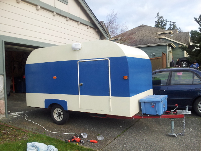

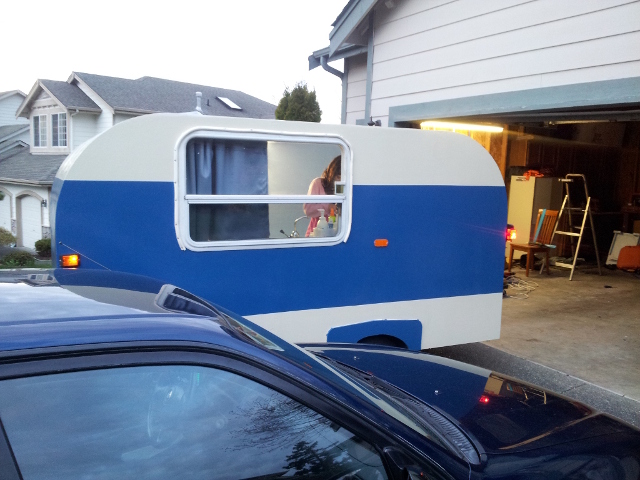

Postby tcolar » Tue Apr 01, 2014 11:09 am
I was never too happy with the original paint job I did.
While it was water tight it didn't look great as it was too brown and had a lot of bad paint streak.
So after a good sanding I decided t repaint (Rustoleum enamel) and while it's still not perfect, I'm really not very good at painting, it is better and more modern(or retro modern ?) looking.

Postby Ron Dickey » Tue Apr 01, 2014 11:17 am
I like it, it stands out and will be seen on the road. looks like you had a good trip and learned a lot along the way. I am in the middle of a build right now and look forward to that same fun filling.
