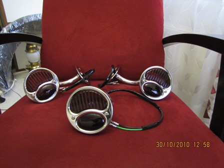

Also the back tail light I just did some research and I came up with the same exact light for a 1947 Willy,s Jeep (Civilian Jeep).. so it does seem to match and make sense . :D
Take a look here.
http://www.drivewire.com/vehicle/1947-j ... -assembly/ 8) 8)
Even though Ive got these already which are a lot nicer but the year matches on the Jeep Lights. :twisted:

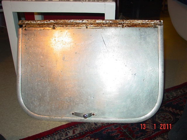

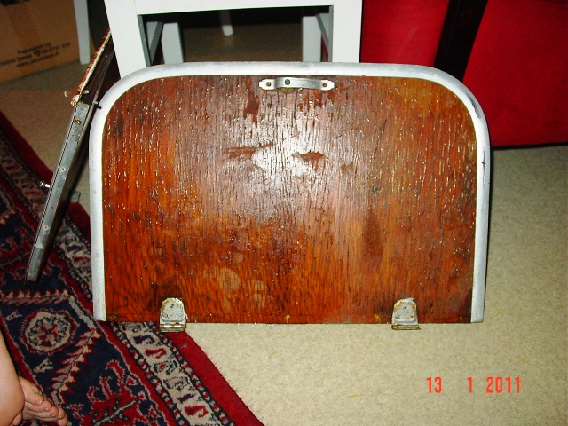

Well the resto continues. Some may say why all the extra work in restoring old parts and aluminum. Well its simple. Use whatever you can without ordering new to replace. :lol:
Ok this is next on the resto schedule. The handles and locks will be repolished as well as the moulding and possibly the aluminum on the 2nd cupboard.. ;)
I think I know the wood to be used on the 1st cupboard :twisted:

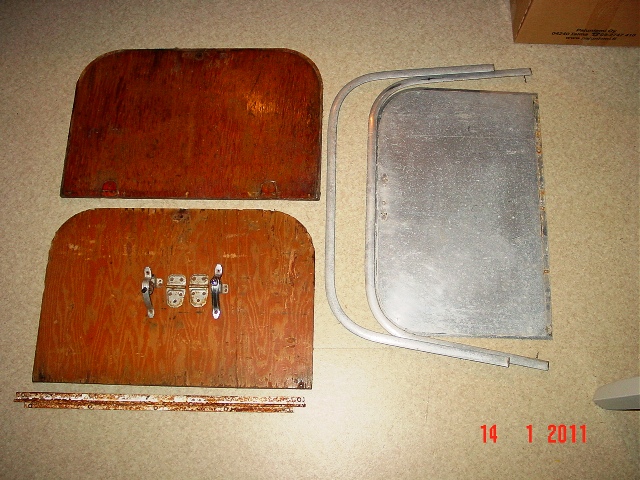

Postby Classic Finn » Thu Jan 13, 2011 5:33 pm
Well all the handles, hinges and mouldings have been taken off. Ready for the buffing. The ply on the doors were pretty much rotted again so I have 2 nice sets of templates from them. :)
The 2 cupboard doors were of the same size even though they were from 2 different locations. Which is fascinating :lol:
The moulding I got off real nicely and after buffing them out will be like brand new. Nice.
Here,s all the parts laid out. Ready for buffing and recutting of new wood.
Next will be the purchase of aluminum or stainless as well as New Marine Ply for the walls and so on as well as taken to the Laser Department to be accurately cut. ;)
