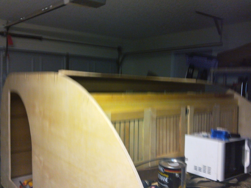

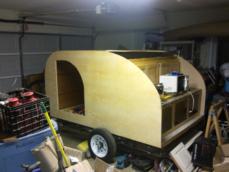

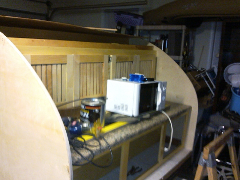

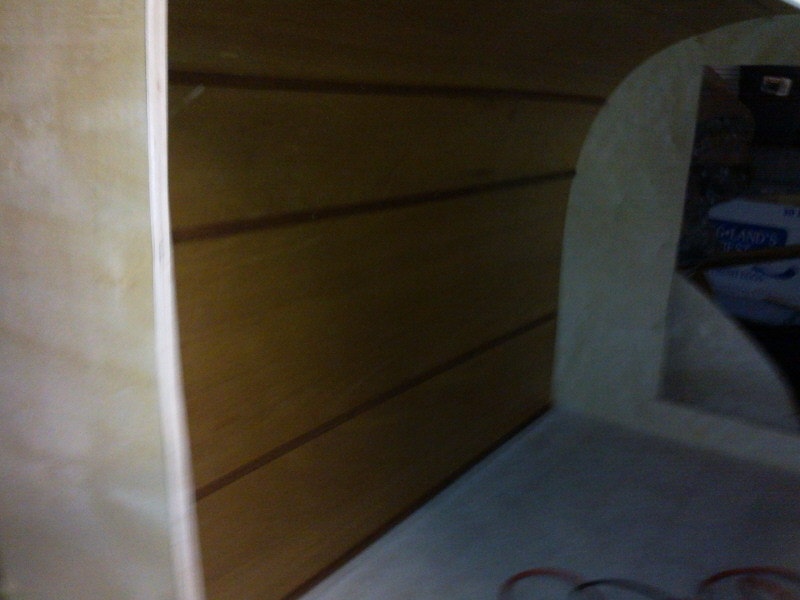

Thanks guys it felt great on progress just hell on me due to heat and humidity. One saving grace was a small shower on saturday that dropped the temp 10 degrees for 2 hrs and had a nice breeze going. Today I did get the cabinets back in and the headliner and they fit better the second time around :lol:. I did have 2 snags: 1 I didn't cut the notch on the back for the hatch seal. 2 when you modify plans you need to change everything and I didn't on the headliner. So when I installed it the 3" pieces at the seams hit right where a spar was and it was short as my tear sets higher than the Benroy plans. The 3" plywood pieces I just took off the front one and glue directly to the spar and then ran a piece of molding side to side across the spars which looked good and helps the glue to dry. Next weekend I will 6" to the headliner (over the cabinets and cut the vent hole and start running electrical and installing the lights and outlets,
Pics as promised:
As at end of day Sunday:
Galley
Short headliner and 3" filler issue:
and last the headliner with molding in a dark brown against the natural birch:
The wife is recovered mostly with just a slight discomfort due to the nerves growing back. She was lucky that they are growing back instead of just being dead is what the doc said, The sheet metal did get put up on the wall cabinets in the garage where she can't see them or hit again. Thanks for asking and for the great comments which keep me motivated. Now I just have to decide what to due to the exterior. Aluminum or epoxy and paint or I really liked Jeromes cedar fencing and galvanized tin roof :lol: and be a real GA redneck! I due like the natural tears just not sure how they do the molding on them.

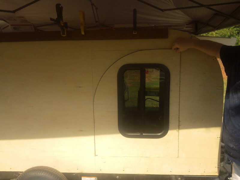

Postby CliffinGA » Mon Aug 22, 2011 10:17 pm
Just a quick pic of the door and window we worked in yesterday, bad thing I will have to cut a new one this weekend. The blade had dulled and when my friend started cutting we scored one side but it ripped a big patch on the otherside of the door :cry:. Tonight I lightly sanded the inside and will put 2nd coat of poly on tomorrow night.

Postby aggie79 » Tue Aug 23, 2011 8:54 am
Cliff,
I love the profile of your teardrop and door! You're making some nice progress now!
I don't know what type of jig saw you have, but if it will take Bosch blades, I would use them. Their wood "clean cut" blades really work well. Some other tips - if your jig saw has different cut modes, I'd use the straight cut mode rather than oscillating cut mode. Taping along the cut line helps. Also, you can make a "zero clearance" baseplate for your jigsaw, using a piece of 1/4 masonite double-stick-taped to the metal baseplate.
Keep the pics coming! :thumbsup:

Postby CliffinGA » Tue Aug 23, 2011 9:11 pm
Thanks all for the encouragement:
Larry at this point I'm thinking go woody! I'm thinking oj just puttying the screw holes and epoxying the sides to keep the natural birch light color, do pine trim stained a nice saddle brown color and the top do a brown also to hide the diffence of the luan. Or do the roof in Aluminum and the rest as a woody.
Thanks Tom I did buy some new bosch blades and this time I will tape it both sides bvefore I cut it.
