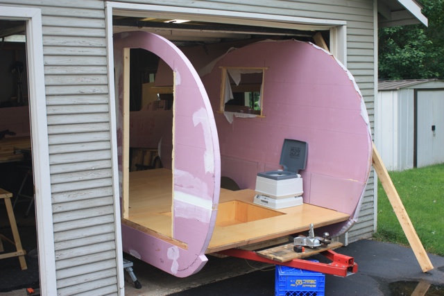

I completed the pop top short of the rubber membrane. I put it in place and wheeled the trailer to the garage door and as it is now it is just scraping its way under the door and opening. Whew! I know it will grow in height with the membrane in place and with the hinge installed but with a little vaseline and a good push I think it will make it without deflating the tires. If it seetles a litle bit say 1/8" or more then certainly it will go. Here is a photo of the lid scraping the doorway on the way out. Parden the cob webs on the door handle.

Postby Wolfgang92025 » Sat Jun 11, 2011 2:50 pm
Standupguy,
I have the same problem with door clearance.
1st time it let air out of my tires and it just cleared.
Then I found a trick that makes it easier for me.
My drive way is close to level, but has a little down hill. But I can push my trailer in and out by hand. So I crank the tongue wheel all the way down. That changes the angle just enough for me with the curvature of the trailer that it just clears the door without having to let the air out of the tires. Funny thing is it only works with pulling the trailer in nose first. Tail first it will drag on the door.
Might be worth a try for you.
Wolfgang

Postby StandUpGuy » Sat Jun 11, 2011 3:23 pm
Wolfgang92025 wrote:Standupguy,
Good food for thought. When I get it completed on the roof, I shall experiement in the fashion you suggest. I did lower my nose a bit to get the begining of my pop up under the opening. I did not actually remove the whole trailer from the garage yet. It is a big releif that it is already close to coming out. At least I know now that some air let out of the tires will let it fit for sure. Whew! 8)
