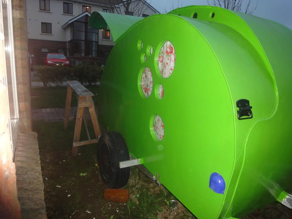

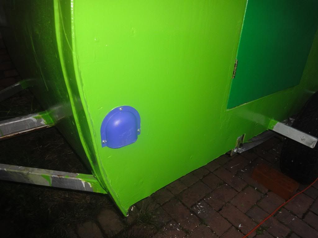

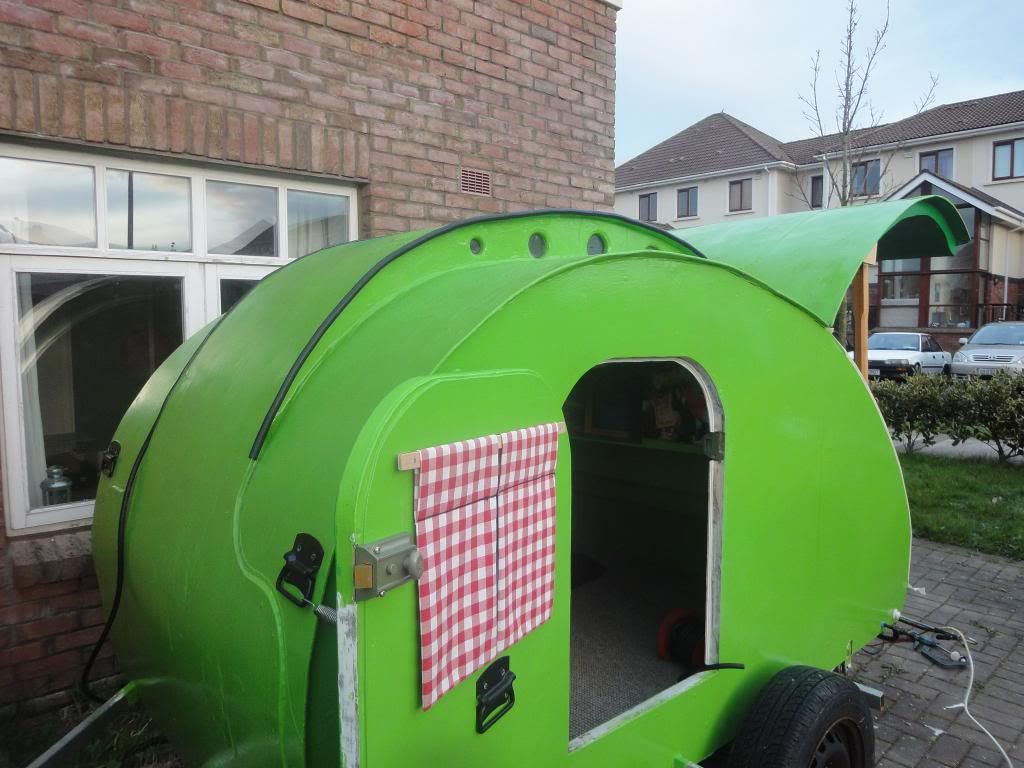

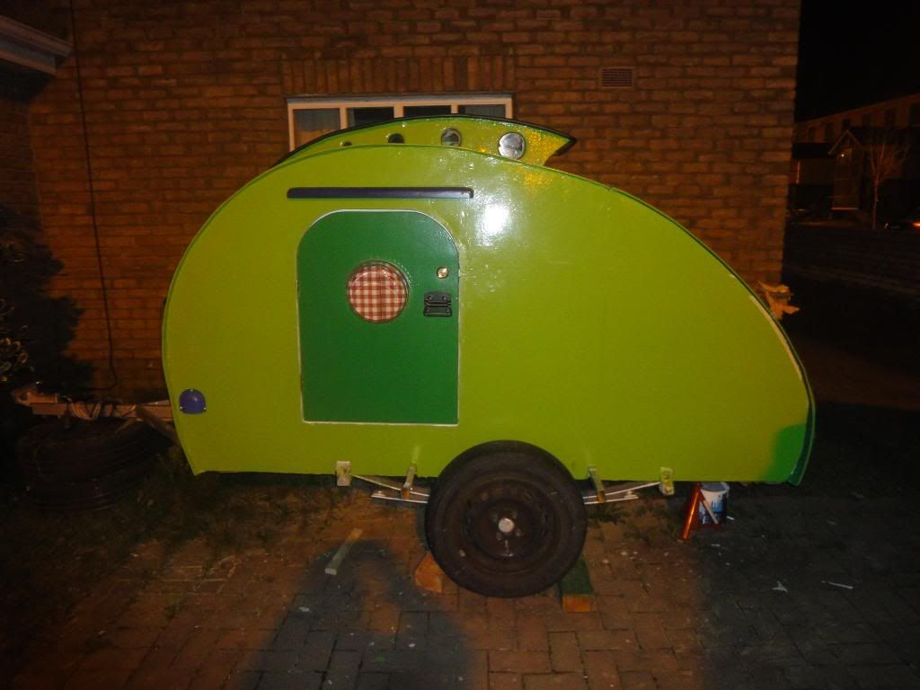

Well it's been a while since i posted any updates on here. Haven't really done much in the last few months. When the weather started to ged bad we decided to stick humphrey into a shipping container to hibernate for the winter. But our first big camping weekend of the year is in 4 weeks time so time to get this thing at least road leagle in time.
So we dragged him out of his winter cocoon last week and i started working again yesterday.
Here's how Humphrey is looking now....
Custom made purple westfalia air vent covers... 8)
So May 2nd is the dead line, fingers crossed i can get it done in time

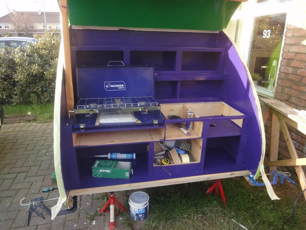

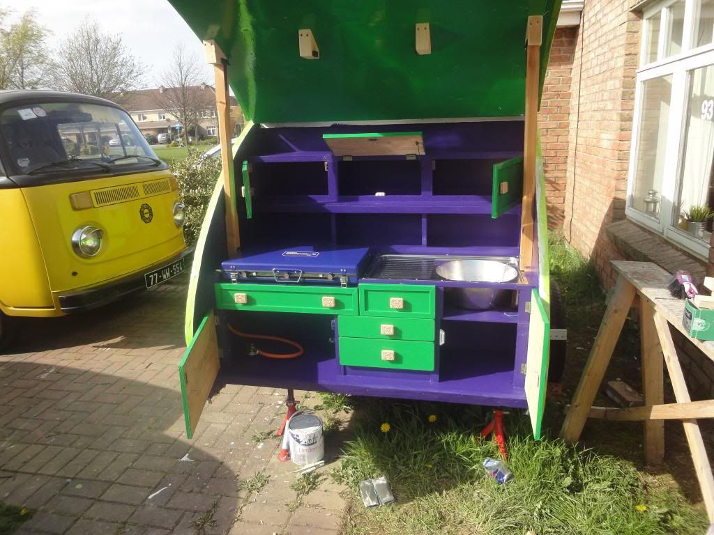

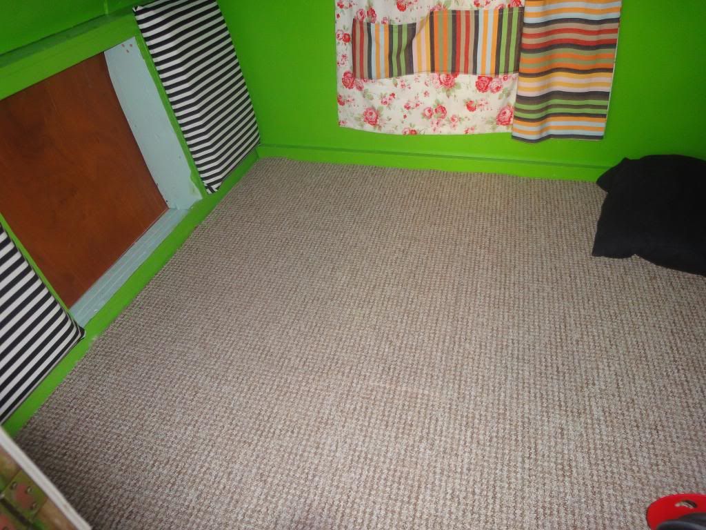

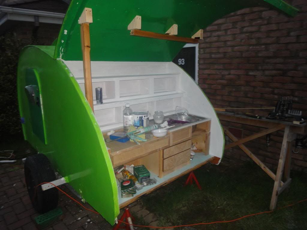

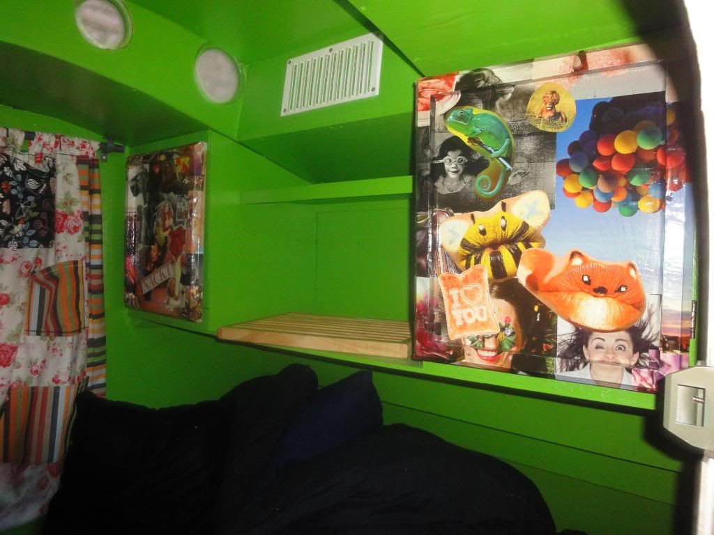

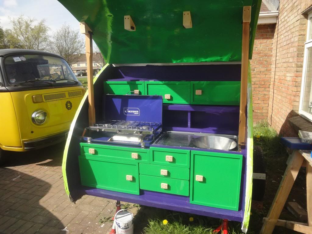

Got some more work done.
Painted the galley...all the doors off to make it easier.
fitted some cheap carpet.
And started the edge trim but not sure if i like it or not.
the main job that needs doing is the wheel arches and road lights. Once they are done it will be able to be towed and camped in :applause:

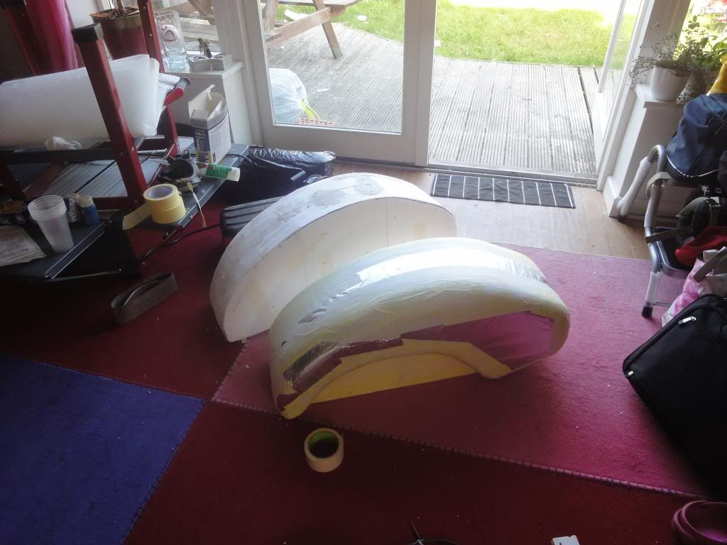

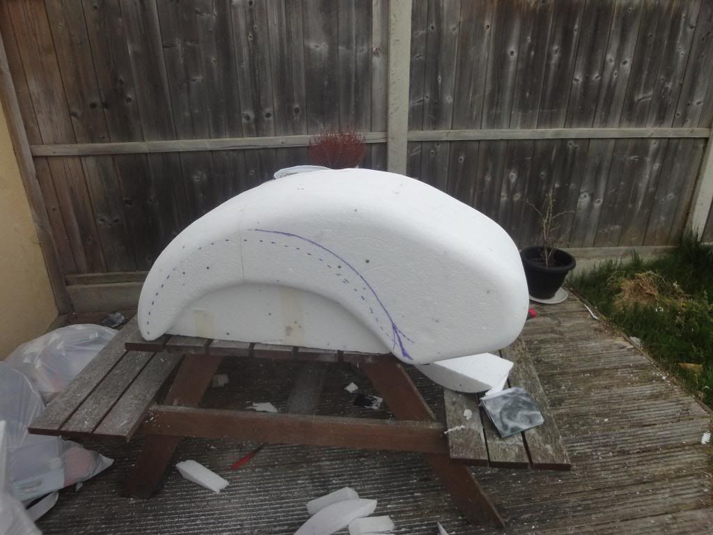

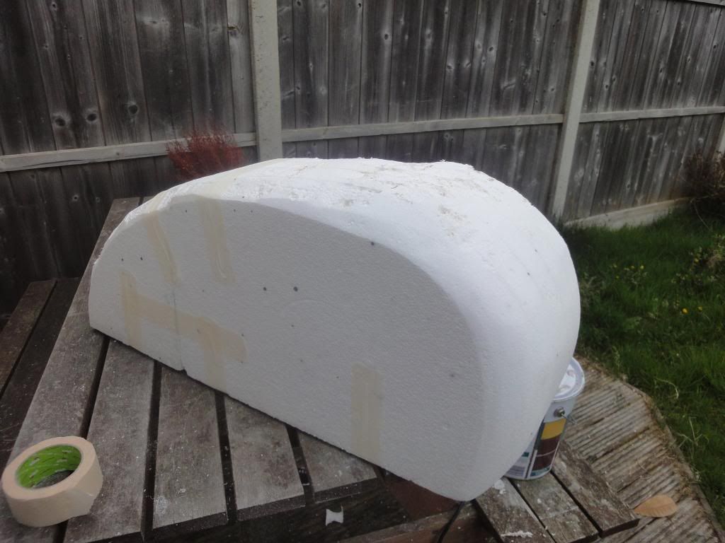

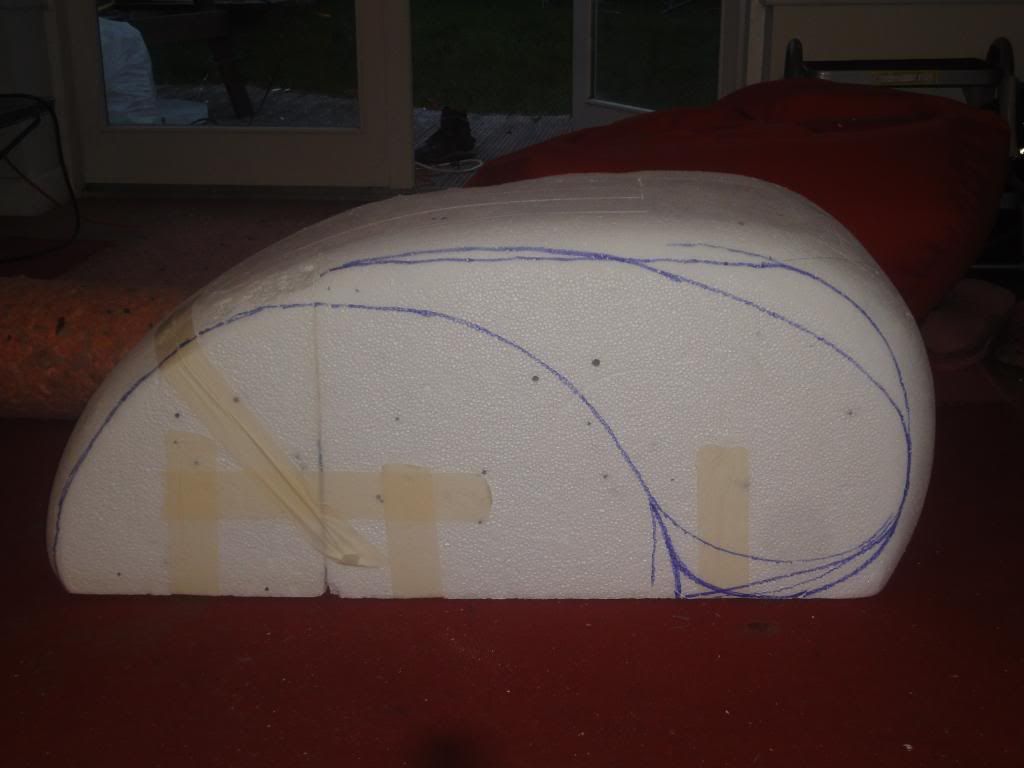

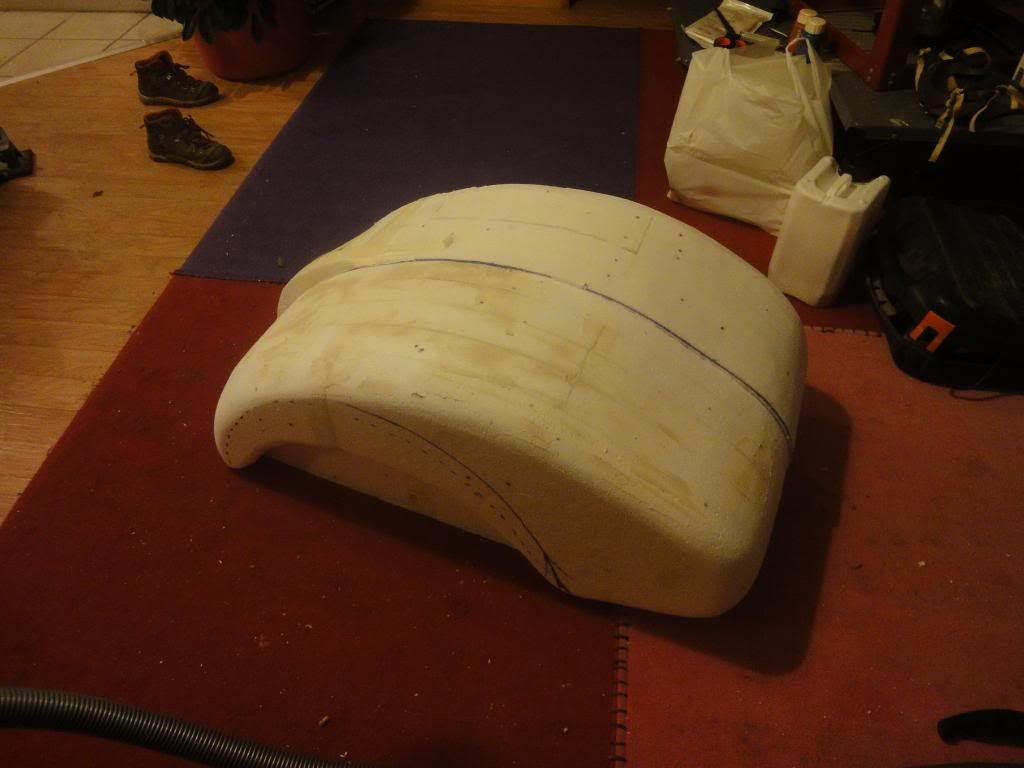

Today i finally started on the job i have being putting off the most. Because of the door position, off the shelf arches just wouldn't work so i have to make my own.
So i glued up lots of polystyrene and started my own private snow storm.
Lots of sketching went on to find the right shape
The hardest part is getting the second one to match the first one :roll:
Hoping to start fibreglassing tomorrow.

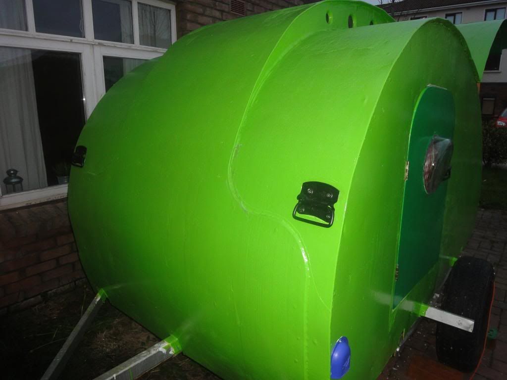

Postby 3nero » Fri Apr 11, 2014 5:32 pm

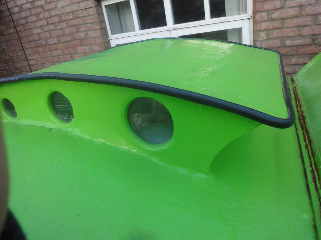

Oh yeah... i also got the brow thing over the door made 8)
Another job ticked off the long list :thumbsup:

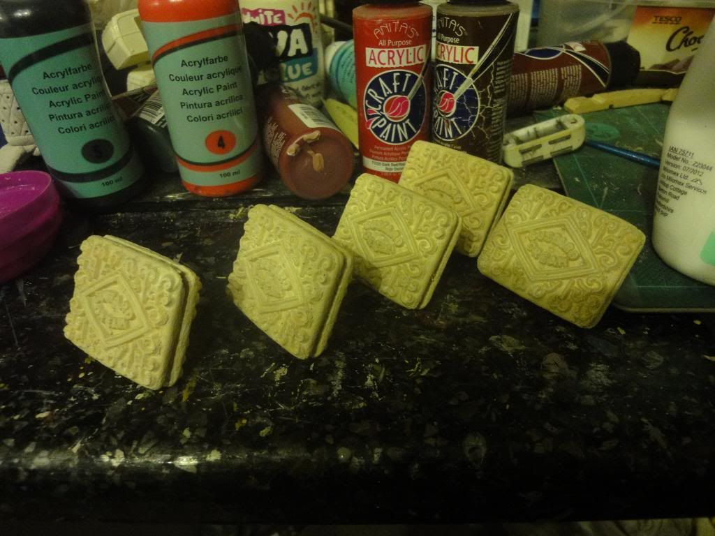

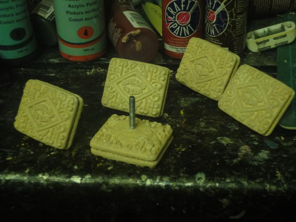

Still sanding and shaping the fenders so not much to look at, but i did get some other bits done.

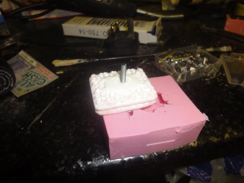

We wanted some weird door knobs for all the doors and drawers in the galley and so far the searches came up blank.
Well the other day while having yet another cup of tea I stoped to take notice of my usual snack.
Can't beat a custard cream dipped in your tea.

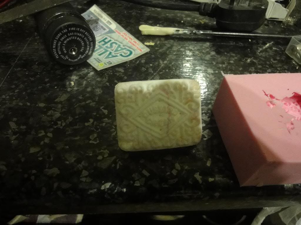

So i sacrificed one of those biscuits to the teardrop gods...
I made a mould of it and ended up with this...
Then i painted them all up
So now i have the weird knobs i need to finish off the galley :FNP

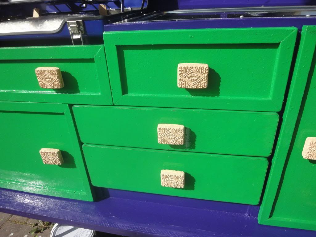

Today i got the knobs fitted
So now the galley is DONE!! :D :worship:

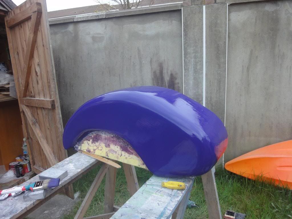

So then i moved on to the arches.

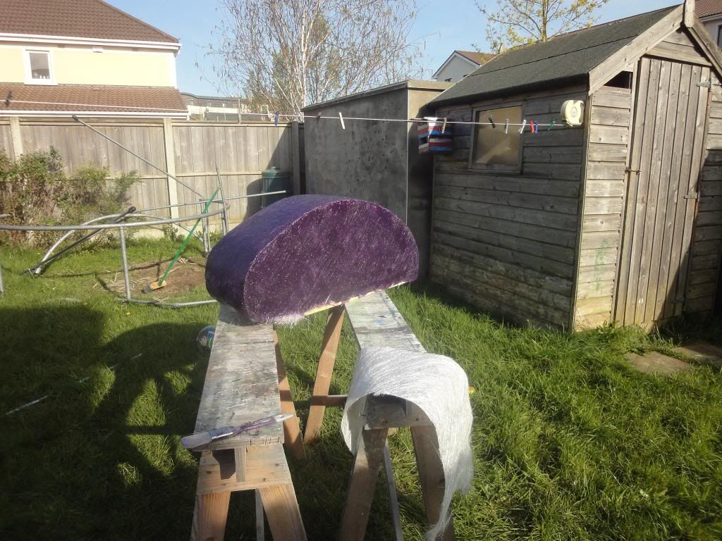

Covered the first one in foil and tape.
then got 3 layers on while the sun shined.
Lots more glassing to do tomorrow :?

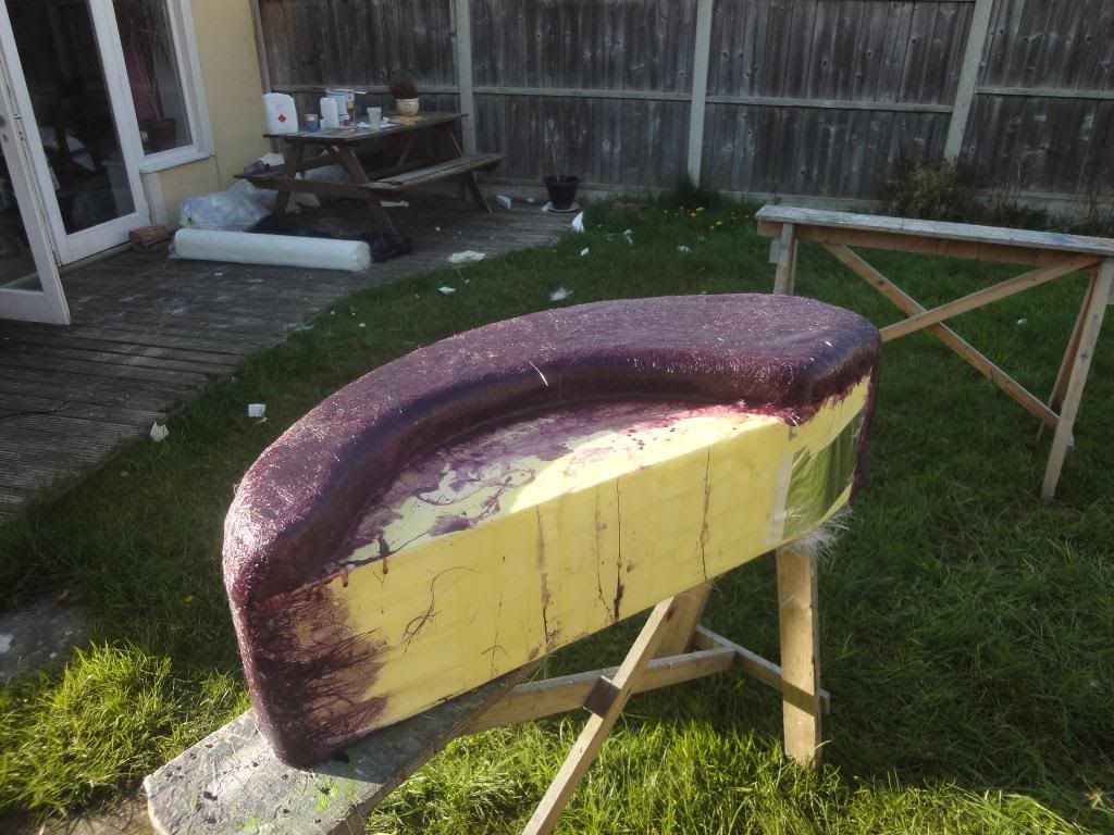

In the last few days all i have being doing is glassing and sanding and then more glassing followed by some sanding....All that work and i've only got one arch almost ready.
It is actually purple but my camera makes it look blue. Just have to wait for the last coat to dry and then i can cut it free from the plug and insert some brackets on the inside for strength. the worst thing is i still have to make the second one :cry:
