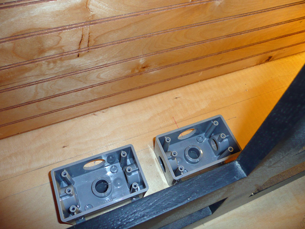

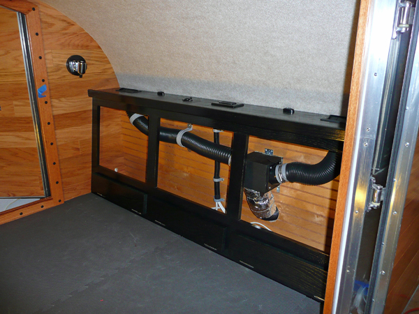

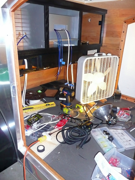

1. You can bundle the wires in split plastic wire loom, fasten it to the back of the cabinet and leave it exposed. In the picture below I have 12 volt and 120 volt wiring in the vertical split loom behind the a/c supply ducts. There is a false bottom installed that is not shown.

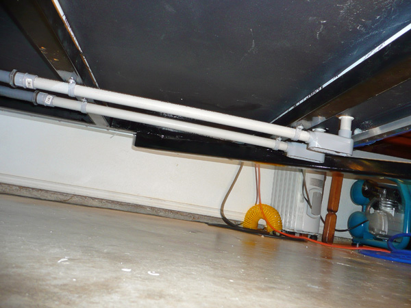

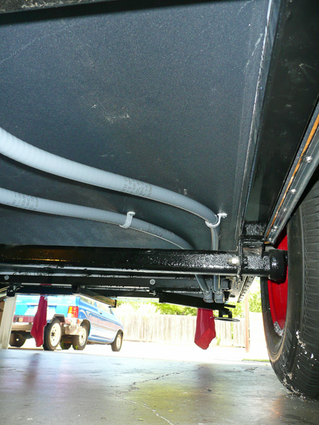

2. You can run your wiring underneath your teardrop in conduit.

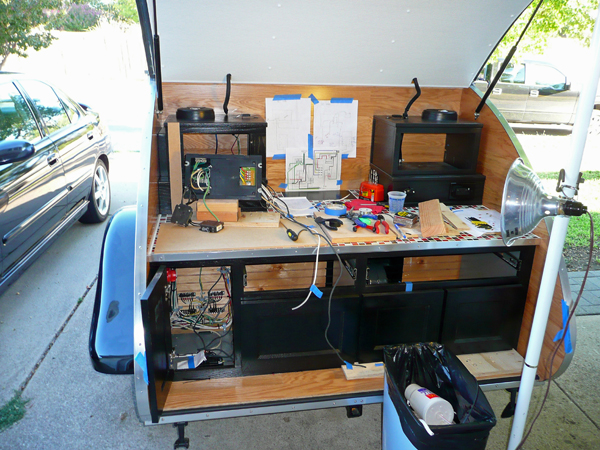

My father and I have discussed both options. I had a coworker of mine that is more electrically inclined visit today to discuss options with us. Thanks for the great pictures! We think we are going to put all the electrical in a tongue box then run wires in through the roof (along the front base)and divert them to the sides and galley as needed. I am just trying to visualize how it will all look, be connected, etc. Suggestions and comments appreciated!

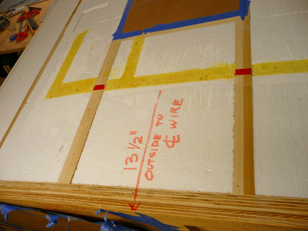

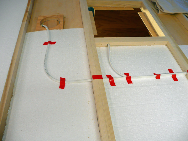

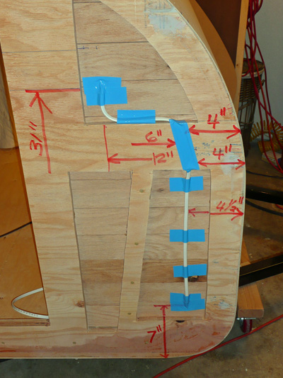

It's a lot easier than it looks. Take your time, make a sketch of your wire runs, label both ends of each wire (converter/source side and fixture side) with a unique designation, and mark that designation on your sketch.
When your putting your wiring through the framing, it is a good idea to photograph the wiring. It also helps to jot down some dimensions. This will minimize the chances of hitting the wires with fasteners.

Good idea! We will make sure to mark everything! I believe we are doing 3 separate systems: the trailer lights, 12V cabin, and 120, just in case there is an electrical hook up. Not planning on inverters/converters, and such. So, it should be easy. Famous last words, right?! :)
