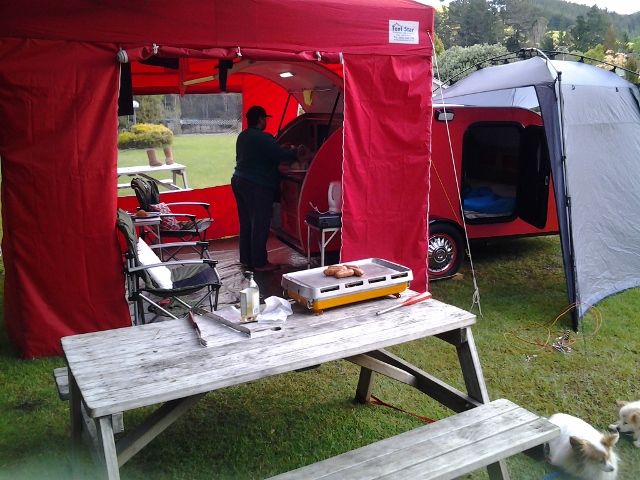

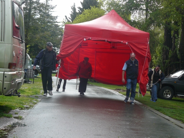

It had rained most of the night and by the next morning the camp site we were on, which was a bit of a hollow, had left us with about two inches of water over the floor in the gazebo. Time for action, as Dale stormed off down to the office and demanded :x that we move to the original site we had booked a couple of months ago. They decided in the end to let us move. :BE There was a long term resident on the next site and the office said that they may want to spread out. We spoke to them and they were only too happy for us to camp there.
We had camped on that site a few years ago, and knew it would be dry. Then it was all hands and move down the lane. An easy job with a TD as you just push them.

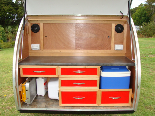

Having arrived home from our first trip it is now time to finish off the galley and the headboard cupboards, put the inner liner in the hatch and a few other odds and sods.

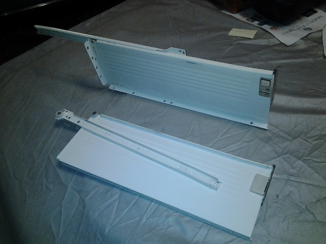

We had some more of the metal drawer sides with the runners and rollers, that we got from a local Emporium, only $5.00 per set, elsewhere they are about $20.00 :shock: These make it a really easy job as you only need to cut a ply bottom and back the width you want, fit a nice front, put the runners on the walls. For the fronts I used offcuts from the ACL exterior cladding with NZ Kauri timber surround, and fitted magnetic catches to keep them shut.

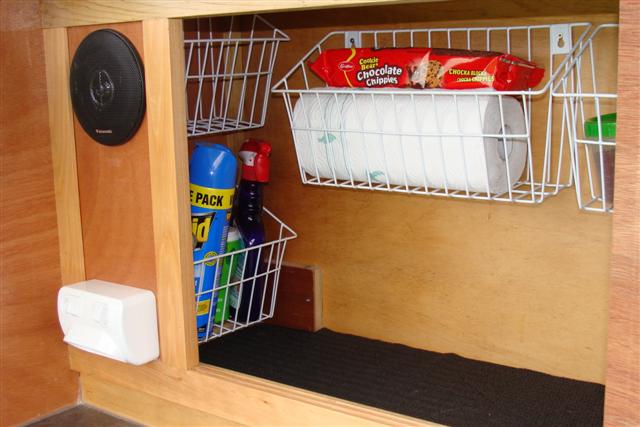

Dale found these wire baskets in a storage supplies shop and they are ideal to screw up around the walls in the pantry cupboard instead of making shelves. Quick easy and they don't weigh much.

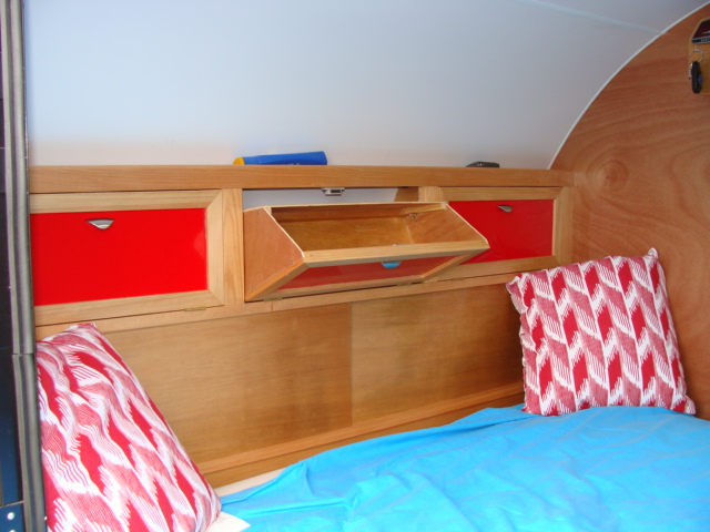

Inside I still had the cupboards to do in the top of the headboard. I wanted to put bottom hinged doors on them, but the problem was going to be getting things things caught in the jam. So the way I got around this was to make them up like car glove boxes. They are ideal places for keeping small items, socks, undies, etc.

Sheddie wrote:Inside I still had the cupboards to do in the top of the headboard. I wanted to put bottom hinged doors on them, but the problem was going to be getting things things caught in the jam. So the way I got around this was to make them up like car glove boxes. They are ideal places for keeping small items, socks, undies, etc.
I like this idea :thumbsup:
I've got a few cupboards to build in my Tvan that will be quite shallow and have been wondering how to maximise their usability. This will be a perfect solution. Thanks. :beer:

Postby Sheddie » Sat Nov 22, 2014 4:01 pm
Hi HB.
Good to think that this may be of help. :D
My wife didn't think that they would work, :roll: as all she could see was that I was making a small space even smaller.
Now she thinks they are "bloody marvelous" as although the area inside them is slightly smaller it is all usable space. ;)

"Bloody Marvelous," indeed. Great idea on the glove box storage, Frank. :thumbsup:

Like it Frank. Saw the photo before I read the post. Yep - glovebox was exactly what I thought.
