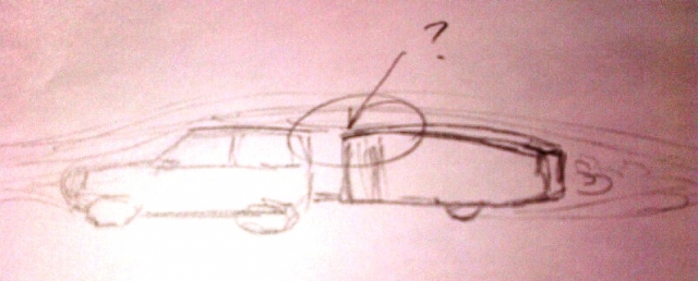

OP827 wrote:Thanks Bluebunny. Looks like I am on a right track with my trailer overall profile. Are you saying that in order for the flow to be attached to the trailer roof, I will have to gradually raise the roof above TV height? I am not sure I understand where is a sharp edge downslope at the front of my trailer in particular if the vertical front wall will start at same or slightly lower height than TV.
I'm just not sure what the behavior of the airflow will be as a result of the sharp leading edge. I would expect some buffeting to occur that may intermittently stall the flow and screw up economy (but I guess). I'd suggest you go ahead and not worry too much about it, but you might consider a sturdy mounting point for a thin canard to study its effect. Pay attention to some of those armored cars that run around town. Some of them have a canard mounted above the sharp leading edge. I can make you a not-beautiful sketch of one if you need help with the concept.

If that's the point you mean, I am not concerned that it is an issue. It is located close behind TV and should not change much. In fact sharper could be better in this case. If you could sketch the canard you noted above, that would help to undderstand the idea. Thanks!

OK. I snooped through your album to get an idea of where you are going...this is a nice shot showing that the box rather close to the hitch point, with some lovely trimmed corners for maneuvering and aero.
130897
Therefore, your box is quite close in the tow shadow; this is very good for aero. Second, your new roof line now has some upslope at the front, which I believe is helpful...In conclusion I have nothing helpful to add to what you are already doing! Great form design! :applause:
For the record I have included the canard device I was earlier referring to. Adding a canard adds drag, but sometimes can reduce drag overall if the base form causes stalling or buffeting. Your form however looks very good!
130899130898130896

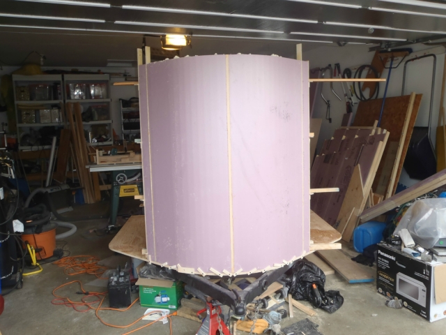

Postby OP827 » Mon Apr 27, 2015 9:06 pm
Sloooow progress due to stepping back, thinking about how to shape, clamp, glueup, and make it work.
Front wall panel is clamped and glued to match front curve floor and I am happy with the curved length and kerfing, it is where it should be 8) .

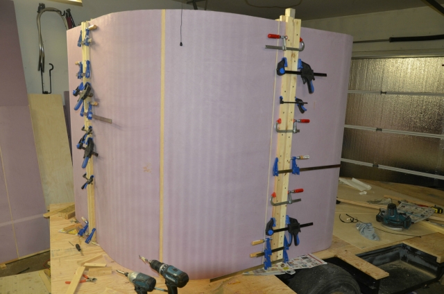

Postby OP827 » Wed Apr 29, 2015 9:46 pm

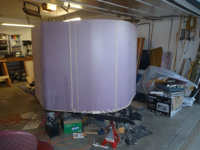

A picture of frontal assembly before it will be split into upper and lower parts...

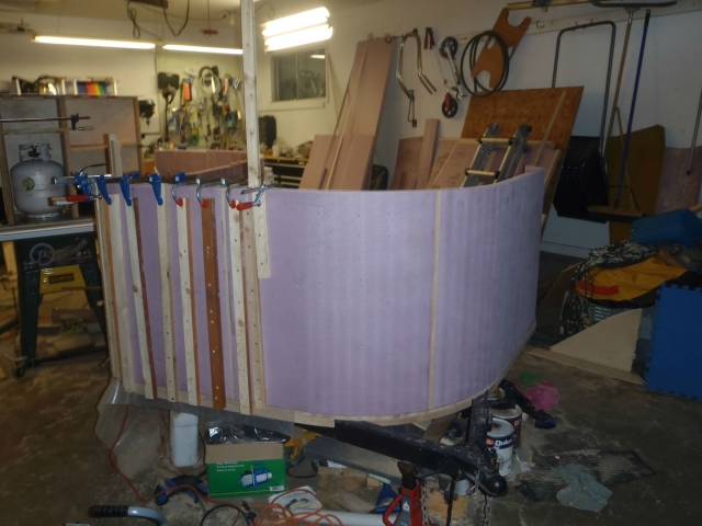

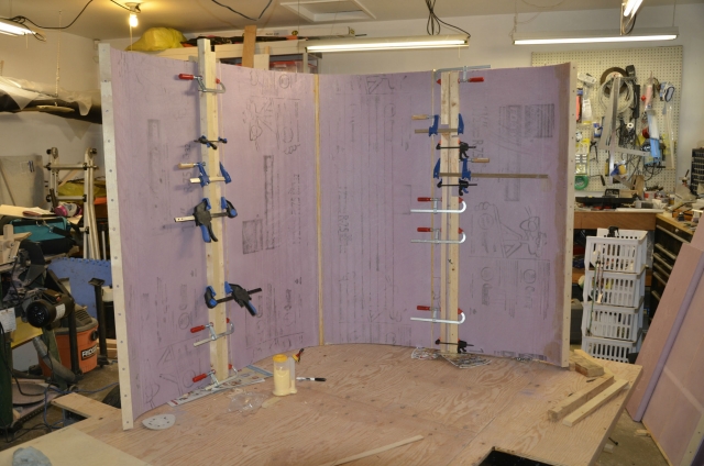

Re: Foldable foamie transformer with amenities
Postby OP827 » Fri May 08, 2015 9:52 pm

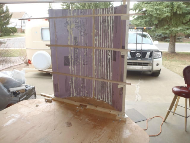

Glued up front wall today. Slow, but some progress is better than no progress.
Took me some time to figure out how to clamp the panels.

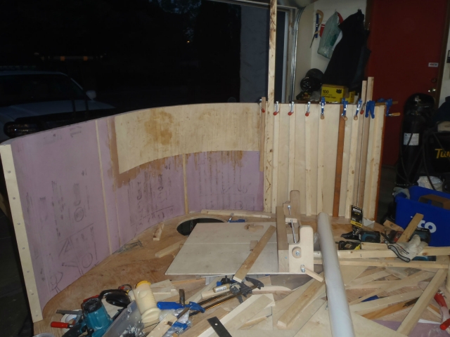

Postby OP827 » Wed May 20, 2015 11:21 pm
Thanks KC for support.

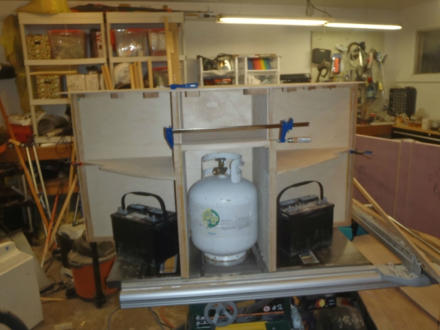

Cut the front section into two for lower and lifting part and continued to laminating the wall with interior birch plywood. At first panel I used TB2 but on the second bigger one decided to go with epoxy due to longer working time. It takes some time to clamp the plywood especially for the bigger section I did today.
Previously during the week I worked on front section compartment that will have separate isolated and vented outside space for propane bottle and two other separate compartments for 12V batteries. There will be interior shelf by panoramic window above the compartment. Three storage compartments with access from inside. Electrical boxes should go inside battery compartments. The front compartment dry fit picture is below. The arrangement will fit inside the lower front wall section I am laminating now.

Front compartment fitted up and ready for glueup. Strong and light structure.
