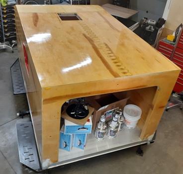

I count 5 day's,
220 wet Sand Paper :worship:
long wiggle.jpg (50.03 KiB) Viewed 2207 times
Racking up; And Rapin foam

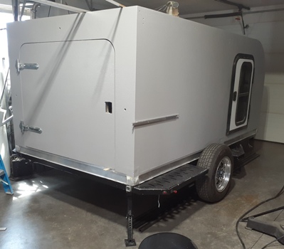

Re: HandiCramper

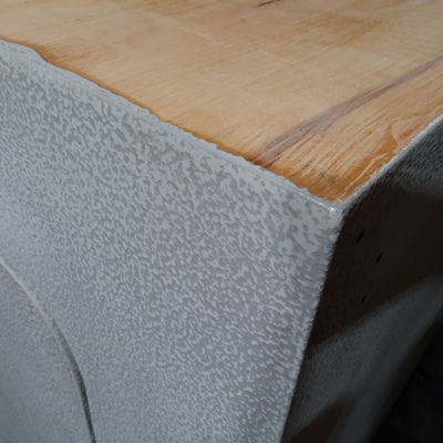

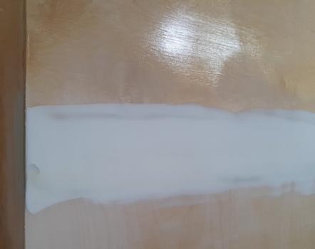

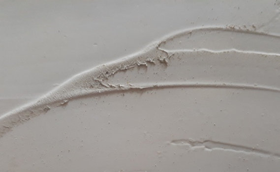

Postby twisted lines » Thu Apr 08, 2021 4:40 pm
White next, top and front
A spot that shows a nice sharp Rolled edge, roughed up for 3rd coat after white I like the finnish and wan't a clear coat
Add Clear.jpg (67.53 KiB) Viewed 1809 times

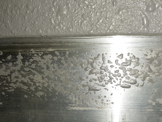

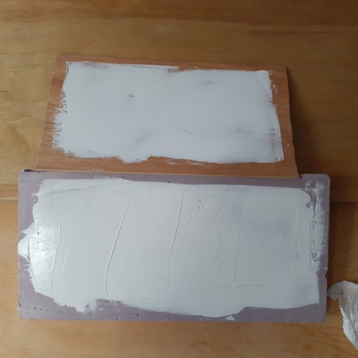

This piece of foam was attached (Caulk) before the paint was pored over the other side; it is very well attached still.
Other side boiled as show prior,
Will test with two other coatings between foam And monstaliner if i am prepared; that rarely happens anymore.
Caulk - Foam test.jpg (45.17 KiB) Viewed 1809 times

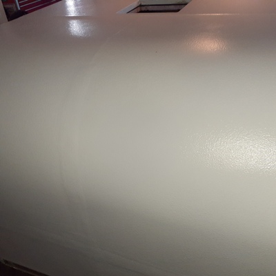

Re: HandiCramper

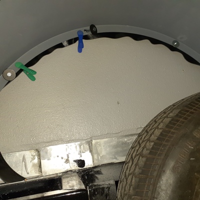

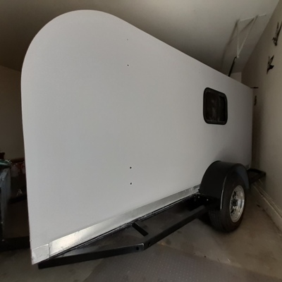

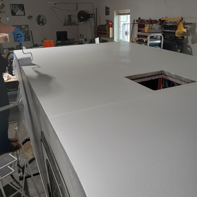

Postby twisted lines » Wed May 19, 2021 6:58 pm
White front with two 5' long 1/8" BB Plys covering the Radius to about 3" forward of the Fan and 20"-24" from the frame it's 1/4" with a Caulk taper.
(My Practice skinned Foamie)
lots of this one is 1/8" skinned foam :NC
Door open; Long day And Crazy ON MEK :?
Had to clean my mess on the floor she did the top
White Front.jpg (45.98 KiB) Viewed 1796 times

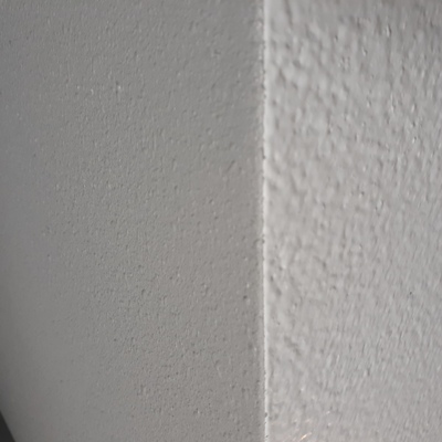

Different lighting
4 Joint's.jpg (39.79 KiB) Viewed 1788 times

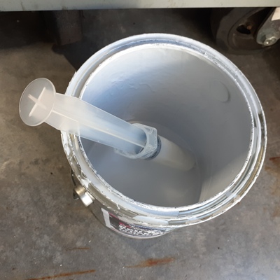

1 Gallon coverage 60'
Project
Gray 90'
White 72' = 2.7 Gallons
Yep third gallons looking like spray gray.
Pot life say's 10 hour's
& Something I tried pulls the last bit out
Don't try to push the pot life too far it has a built in release agent :lol:
Cap it.
Rolled white / Sprayed Gray

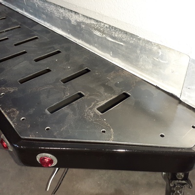

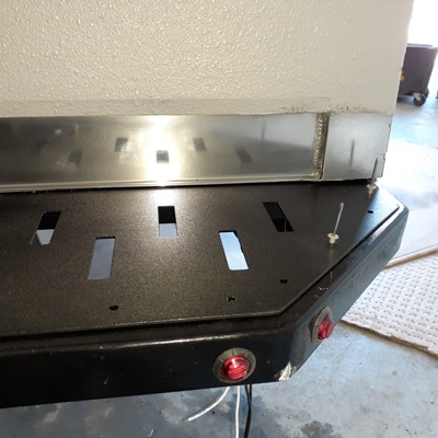

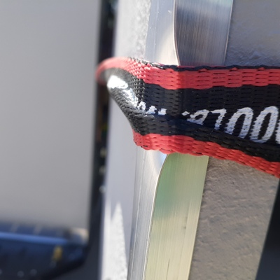

Postby twisted lines » Fri Jun 04, 2021 11:17 am
Front box mount & paint, bumper after paint, step's need something over them, should have matched the sides :thinking:
Mill scale.jpg (79.12 KiB) Viewed 1662 times
City Bumpers.jpg (69.78 KiB) Viewed 1662 times

Re: HandiCramper
Postby tony.latham » Fri Jun 04, 2021 5:19 pm
Perhaps I missed it but what paint are you using?
p.s. nice job!
Re: HandiCramper
Postby twisted lines » Fri Jun 04, 2021 5:26 pm
tony.latham wrote:Perhaps I missed it but what paint are you using?
p.s. nice job!

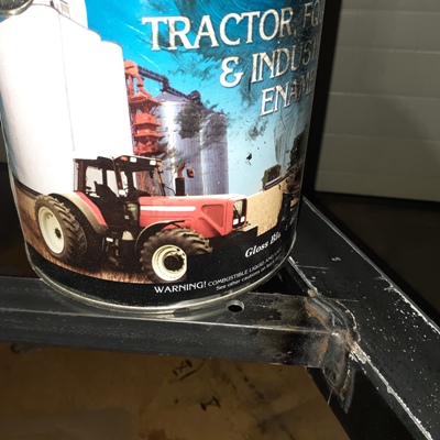

Thank you; Monsta!
& the black is Cheap farm Enamel
And over the top of the bumpers, mill scale hot rolled; bed liner in a can :lol:

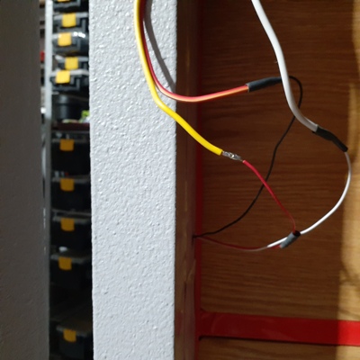

Re: HandiCramper

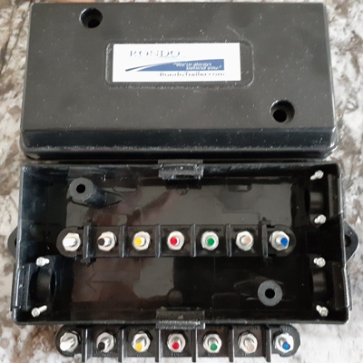

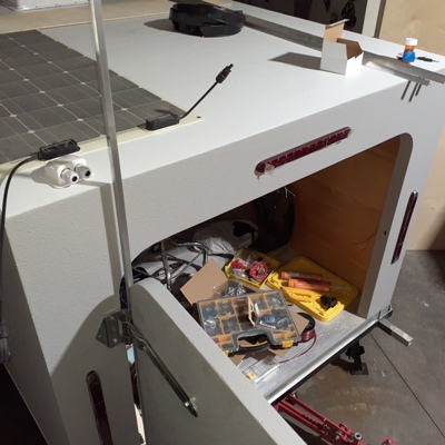

Postby twisted lines » Fri Jun 11, 2021 5:44 pm
Filling the holes and plugging the wires in :? They are still real easy to change as is the diagram :lol:
& Needed just a little more room to get the fender on
Yep that left a mark (Her Garage) :frightened:
Wiring diagram.jpg (72.42 KiB) Viewed 1542 times
left a mark.jpg (40.99 KiB) Viewed 1542 times

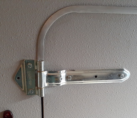

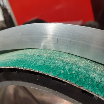

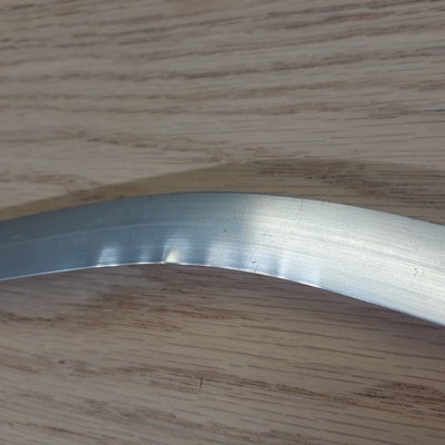

Postby twisted lines » Wed Jun 23, 2021 2:19 pm
Wondered for year's and found out today, nope I can't hand bend the T molding over my radi without relief :frightened: but save it, by taking 1/8" out of the inside.
Caulk And drilling for rivets before the heat turns on :thumbsup:
Saved that one too......

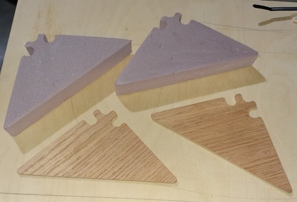

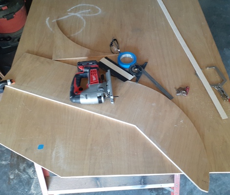

Postby twisted lines » Fri Jun 25, 2021 2:24 pm
I Have a little clearing to do, The piece's are fit to the Inside Radi ; so I traced the 1 door side and made the first piece of my tiny headboard.
I didn't make my trailer long enough :frightened:

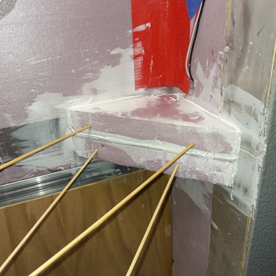

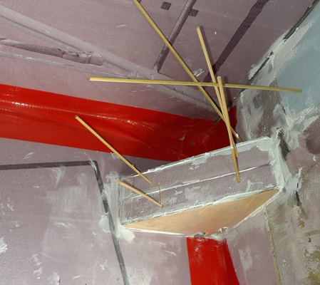

Postby twisted lines » Thu Jul 29, 2021 7:30 pm
Decided where the fuse / solar panel charger, wiring, battery's, tail light's pretty much everything is going to be routed!
It's going through this mess In the right rear corner when I get all the wire's to the fuse panel / charger, I'll start the diagram :lol:
