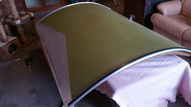

Thanks tim and yea ill be adding something else for sure but ill dwell on that.
Its a nice big space to add something but getting the hatch on under the pergola leaves me weth about 1/8"to spare so dont want to do it any more than i need to.
Im not sure if ill scre the leading edge down or not yet... ill see how it behaves when i vhb tape and sikaflex it down

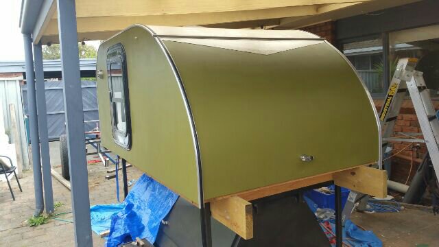

Postby KCStudly » Wed Dec 30, 2015 8:51 am
I voted back when you first showed the triangle detail, but I'll go on record again saying that I like it much better with. It looks great!
A little hindsight, if you weren't planning on adding a logo or image, I think it would be a little "swoopier" (to coin a phrase) if the tip of the triangle came down lower, perhaps even diving into the lower hatch trim enough to where the aluminum also acted as a wear plate around the hatch handle.
Either way, it sure looks good.

Postby dales133 » Wed Dec 30, 2015 1:34 pm
Lol...
Ive still got the larger triangle piece from way back when but it looks a bit much.
Ive played around with it a bit but ended up cutting this one yesterday and along with you ,everyones said yes so i recon ill run with it and the rest can stay blank until i feel inspired to do something else .

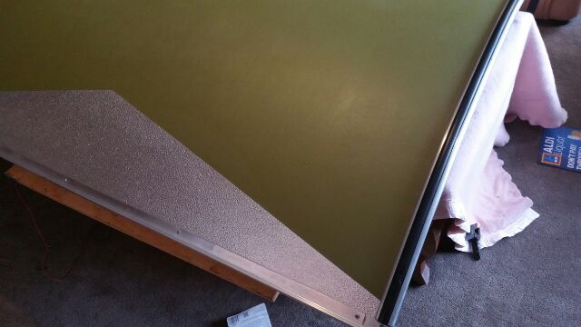

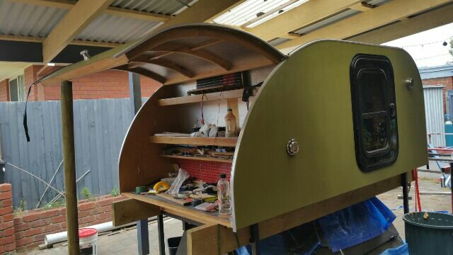

Postby dales133 » Sat Jan 02, 2016 4:25 am

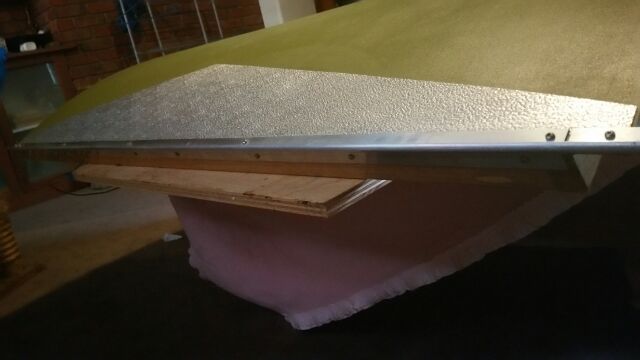

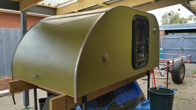

Well there she blows.
Worked out how to hold the trim on,screwed from behind and the screws will be covered by the hatch seal.
Ive got one small issue witch ill revisit when the hatch is refitted but basicly the trim ive used on the roof line isnt deep enough to completly cover the sidewall...im not sure if other than atsetics it will pose a problem but as long as i have a decent seal i should be right.
I could maybe fit an angle under the trim or something...

Postby Atomic77 » Sat Jan 02, 2016 8:17 am
Looks great! I really like it!

Postby KCStudly » Sat Jan 02, 2016 9:33 am
+1 It looks great. I like it, too. :thumbsup:

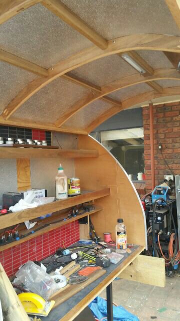

Postby Vedette » Sat Jan 02, 2016 1:05 pm
Dale
You have some pretty nice furniture in your garage.....but Isn't the carpet hard to sweep????? :R
Great progress man! :thumbsup: :thumbsup:

Postby dales133 » Sat Jan 02, 2016 1:11 pm
Lol brian.
Been hot as so i moved inside where its a bit cooler.
I only have a small shed and the campers taking up all the other space.
